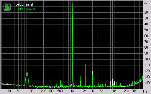

THD + Noise (at -3 dB FS)
Spectrum graph
Left
Right
THD, %
+0.0002
+0.0007
THD + Noise, %
+0.0004
+0.0008
THD + Noise (A-weighted), %
+0.0004
+0.0009

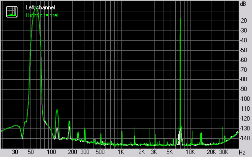

IMD (swept tones)
Spectrum graph
Left
Right
IMD + Noise at 5000 Hz,
0.0005
0.0009
IMD + Noise at 10000 Hz,
0.0005
0.0008
IMD + Noise at 15000 Hz,
0.0005
0.0008
