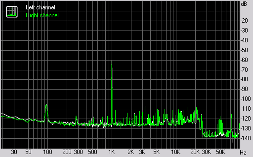

Noise level
Spectrum graph
Left
Right
RMS power, dB
-93.2
-93.3
RMS power (A-weighted), dB
-94.6
-94.8
Peak level, dB FS
-76.0
-75.5
DC offset, %
+0.5
+0.6

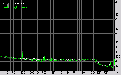

Dynamic range
Spectrum graph
Left
Right
Dynamic range, dB
+92.4
+92.2
Dynamic range (A-weighted), dB
+93.4
+93.2
DC offset, %
+0.49
+0.59

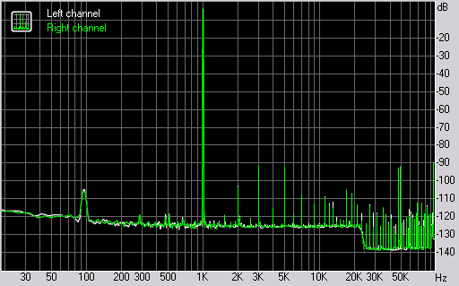

THD + Noise (at -3 dB FS)
Spectrum graph
Left
Right
THD, %
+0.0061
+0.0063
THD + Noise, %
+0.0073
+0.0075
THD + Noise (A-weighted), %
+0.0085
+0.0088

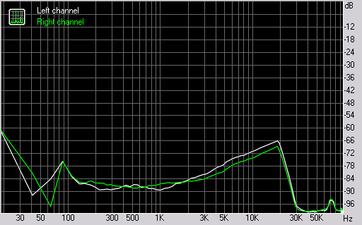

Stereo crosstalk
Spectrum graph
Left
Right
Crosstalk at 100 Hz, dB
-79
-79
Crosstalk at 1000 Hz, dB
-88
-85
Crosstalk at 10000 Hz, dB
-70
-73
