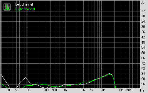

Frequency response
Spectrum graph
From 20 Hz to 20 kHz, dB
-6.12, +0.06
From 40 Hz to 15 kHz, dB
-0.16, +0.06

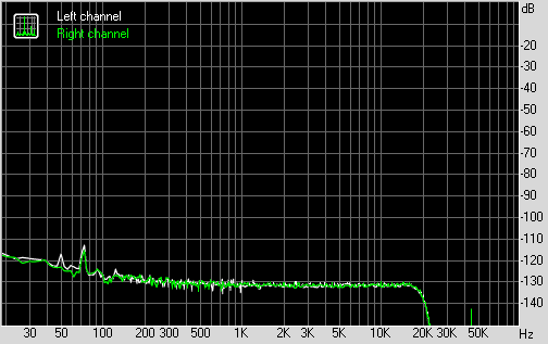

Noise level
Spectrum graph
Left
Right
RMS power, dB
-101.7
-101.6
RMS power (A-weighted), dB
-104.6
-105.2
Peak level, dB FS
-76.2
-76.3
DC offset, %
-0.0
-0.0

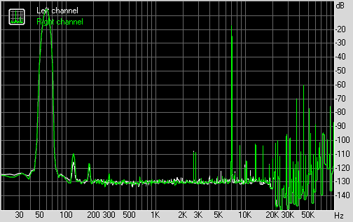

Dynamic range
Spectrum graph
Left
Right
Dynamic range, dB
+101.3
+101.2
Dynamic range (A-weighted), dB
+102.2
+102.3
DC offset, %
-0.00
-0.00

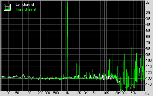

THD + Noise (at -3 dB FS)
Spectrum graph
Left
Right
THD, %
+0.0019
+0.0020
THD + Noise, %
+0.0094
+0.0095
THD + Noise (A-weighted), %
+0.0054
+0.0055

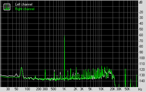

Intermodulation distortion
Spectrum graph
Left
Right
IMD + Noise, %
+0.0037
+0.0038
IMD + Noise (A-weighted), %
+0.0032
+0.0032

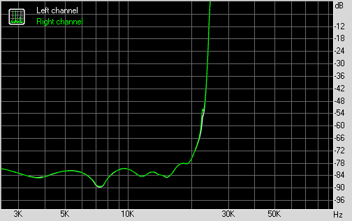

IMD (swept tones)
Spectrum graph
Left
Right
IMD + Noise at 5000 Hz,
0.0082
0.0081
IMD + Noise at 10000 Hz,
0.0090
0.0090
IMD + Noise at 15000 Hz,
0.0059
0.0060
