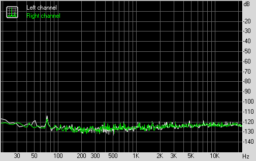

Noise level
Spectrum graph
Left
Right
RMS power, dB
-92.8
-92.8
RMS power (A-weighted), dB
-93.8
-93.8
Peak level, dB FS
-78.8
-81.6
DC offset, %
-0.0
-0.0

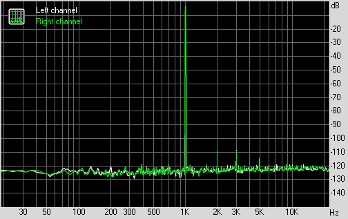

THD + Noise (at -3 dB FS)
Spectrum graph
Left
Right
THD, %
+0.0008
+0.0010
THD + Noise, %
+0.0048
+0.0048
THD + Noise (A-weighted), %
+0.0044
+0.0043

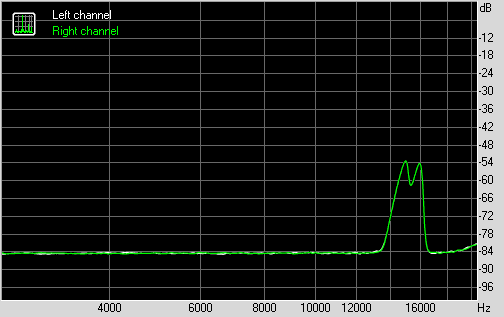

IMD (swept tones)
Spectrum graph
Left
Right
IMD + Noise at 5000 Hz,
0.0059
0.0060
IMD + Noise at 10000 Hz,
0.0062
0.0061
IMD + Noise at 15000 Hz,
0.2090
0.2092
