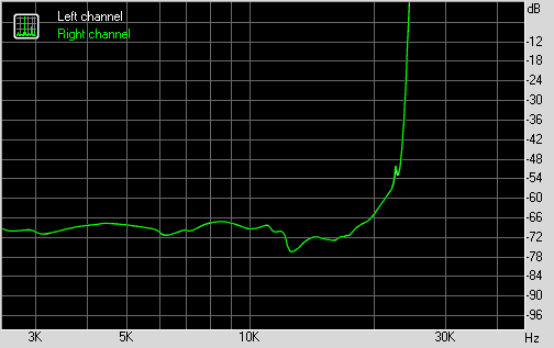

Frequency response
Spectrum graph
From 20 Hz to 20 kHz, dB
-6.12, +0.06
From 40 Hz to 15 kHz, dB
-0.16, +0.06

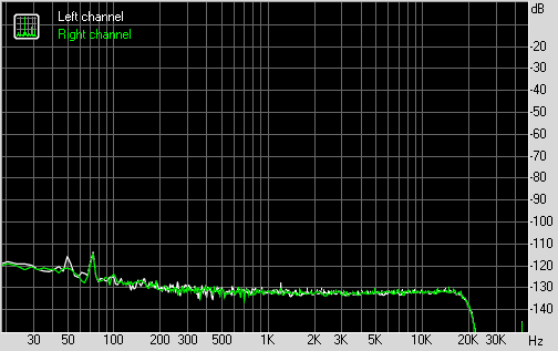

Noise level
Spectrum graph
Left
Right
RMS power, dB
-104.4
-104.3
RMS power (A-weighted), dB
-106.2
-106.5

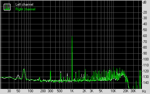

Dynamic range
Spectrum graph
Left
Right
Dynamic range, dB
+101.2
+101.3
Dynamic range (A-weighted), dB
+102.2
+102.3
DC offset, %
-0.00
-0.00

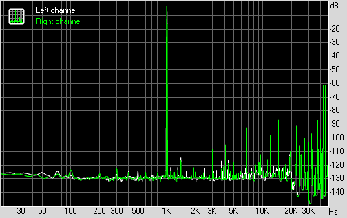

THD + Noise (at -3 dB FS)
Spectrum graph
Left
Right
THD, %
+0.0021
+0.0022
THD + Noise, %
+0.0392
+0.0393
THD + Noise (A-weighted), %
+0.0340
+0.0341

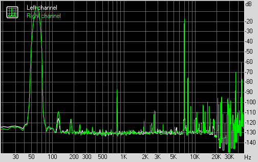

Intermodulation distortion
Spectrum graph
Left
Right
IMD + Noise, %
+0.0403
+0.0403
IMD + Noise (A-weighted), %
+0.0381
+0.0381
