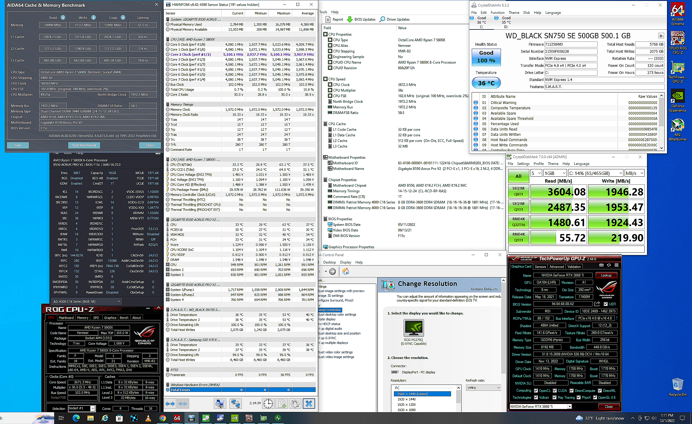

Hi everyone on this thread, read about your hard choice alternative 4000 ram issue, AMD leave the answer behind! Update after update Agesa combo, after 2 years long, still no way to improve ram stability on 4000 IF2000 WHEA19 Errors
Just got 2x 8Gb Viper 4000Mhz CL16 running like a charm at 3800 free Whea19, everything over 3933 a few dozen and couple hundred of them at 4000Mhz, no matter what I tried to configure in Bios current Agesa 1.2.0.7 Finnaly I decided go for 102 BUS just to benefit for 3944Mhz perfect stable setup running no Whea19 after all, but how knows, I believe we can survive NO 4000 IF2000 Whea19 free ?!?
