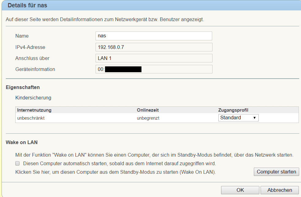

![fb.png fb.png](https://www.hardwareluxx.de/community/data/attachments/259/259943-08dadb719d44f78b9a2e0dc322154c7a.jpg)

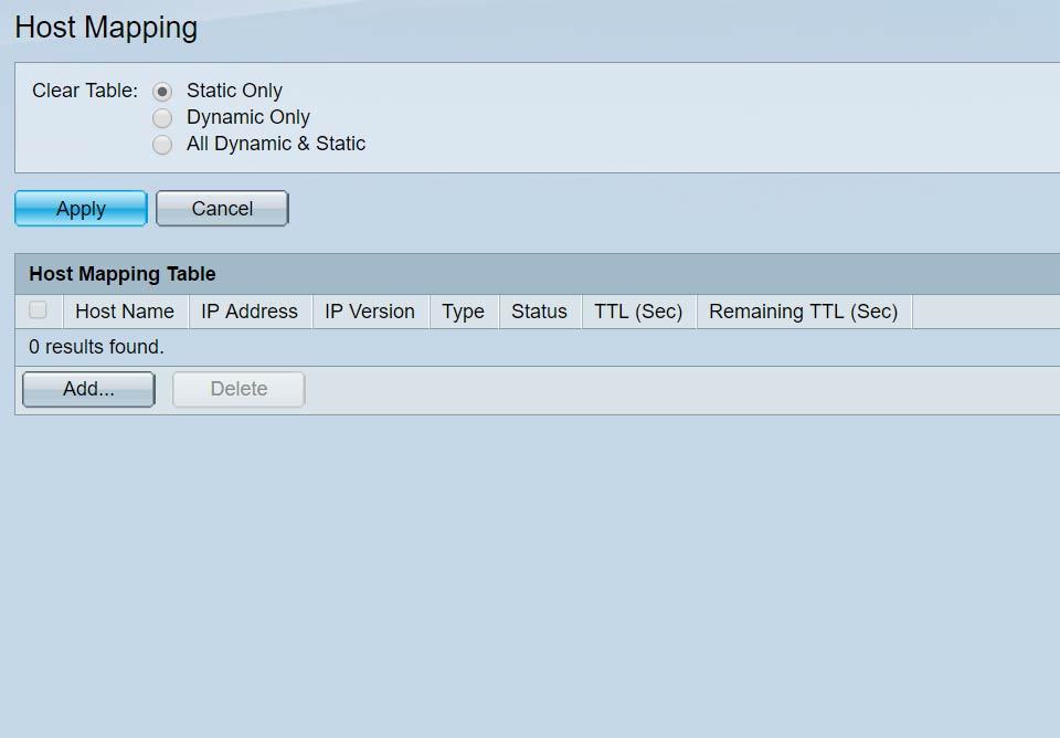

![sg300-1.jpg sg300-1.jpg](https://www.hardwareluxx.de/community/data/attachments/259/259861-8b8ec27525ce6ba5b844f06269252387.jpg)
![sg300-2.jpg sg300-2.jpg](https://www.hardwareluxx.de/community/data/attachments/259/259886-d7a928cf3f971a69379a287f24a2adde.jpg)
![sg300-3.jpg sg300-3.jpg](https://www.hardwareluxx.de/community/data/attachments/259/259909-9b283435893868ced5039682d17c4aea.jpg)
