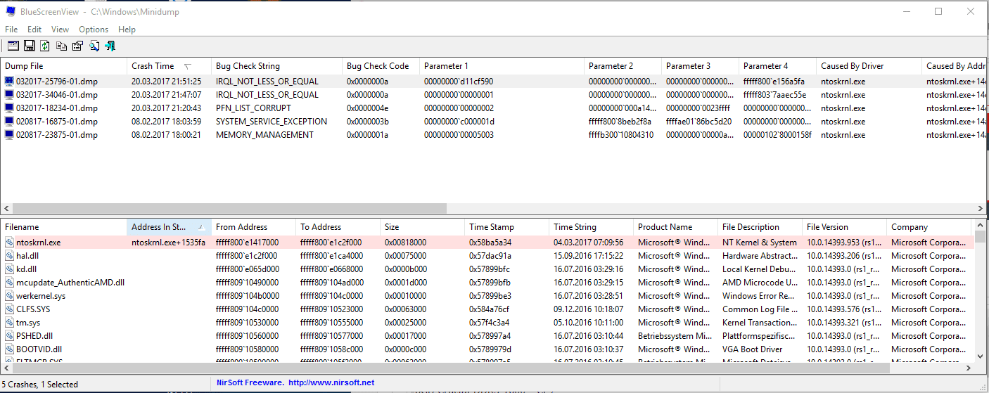

Weitere Infomationen als Anhang

Die Bluescreens sagen folgendes aus:
"The virtual memory address that could not be accessed."
"The entry in the list that is being removed"
"The exception that caused the bug check"
"The working set free list is corrupt. This is probably a hardware error."
Quelle: Bug Check Code Reference - Windows 10 hardware dev
Das bringt mich aber nicht wirklich weiter..
