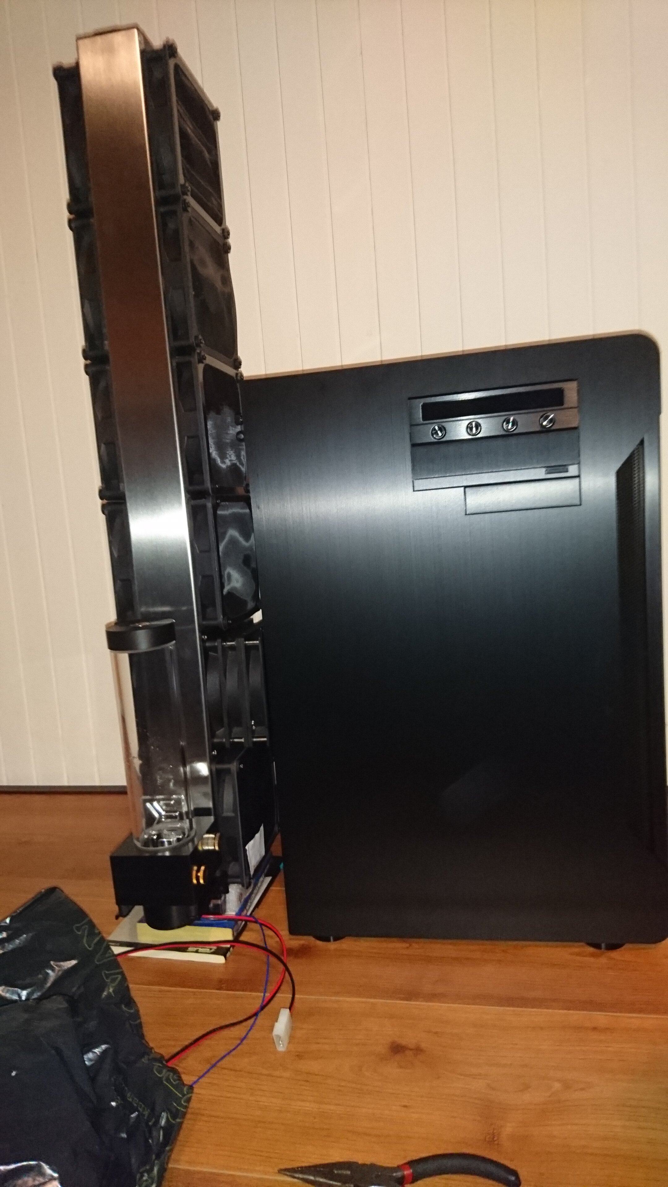

Hi,
two D5 can handle those rads, since they are tube radiators they don't have as much restriction as normal radiators.
In my opinion you should use 6 fans on each radiator for the best performance with quieter fans. If you put them side by side with only 6 fans for both, you give the second radiator the heated air from the first and the performance is worse.

Currently my AMS 840 is standing vertically see picture:
If i add another AMS 840 should i place them side by side vertically or is it better to place them horizontally because this way the pumps don't have to push the water all the way up twice?
Is it better to use a DUAL D5 pump top or place 1 D5 pump on each rad and why?
I also wonder which one of the 2 rads is more restrictive?
