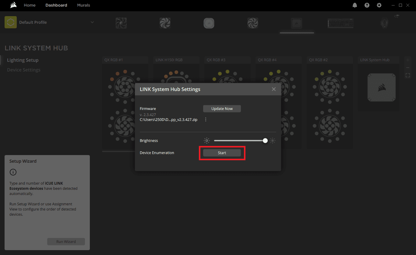

This firmware is a BETA release because during regression testing, our team observed in a single PC, that after many sleep cycles, it is possible to experience minor connection/re-enumeration issues with the AIO LCD screens. If you experience this issue on sleep wake with this firmware, please go to the System Hub and click the Device Enumeration button to re-connect the screen.
- iCUE LINK System Hub => Device Settings => Start "Device Enumeration"
The device enumeration button is a new troubleshooting tool we added to iCUE v5.12 to reboot the bus and force LINK device re-enumeration without a power cycle.

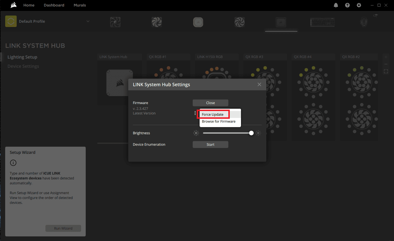

If at any point you would like to revert your LINK System Hub’s firmware from BETA to back to an official release candidate, please use the “Force Update” button located in the same area as “Device Enumeration”.
