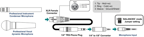

ich möchte mir ein Mikrofon zum Anschluss an meine Soundcard Auzentech Forte kaufen. Wenn es möglich ist, möchte ich das Mikrofon mittels Adapter an die Soundcard anschließen, also ohne USB und ohne zusätzlichen Verstärker.

Microphone Pre-Amplifier
X-Fi Forte Mic Pre-AmpMicrophone signal level is very small, and thus weak in relation to external noise. Therefore, most professional microphones used a Balanced Connection system.
When in “BALANCE” mode, the Auzen X-Fi™ Forte 7.1 supports professional Balanced Microphones (configured using on-board jumper; see image). The MIC Pre-Amplifier has a very low E.I.N and over -60 dB CMRR (Common Mode Rejection Ratio).
It is possible to connect a Balanced dynamic MIC or Powered Balanced condenser MIC. Most MIC cable will use 1/4” Phone jack, and thus will need a converter to be able to use these MICs.
When in “STEREO” Mode, it is possible to use Mono Multimedia Condenser microphone and Multimedia Stereo microphone. The Left and Right channel sound will be mixed when input.

Unsicher bin ich daher wegen dem Hinweis Phantomspeisung (48V) bei den Mikrofonen.
