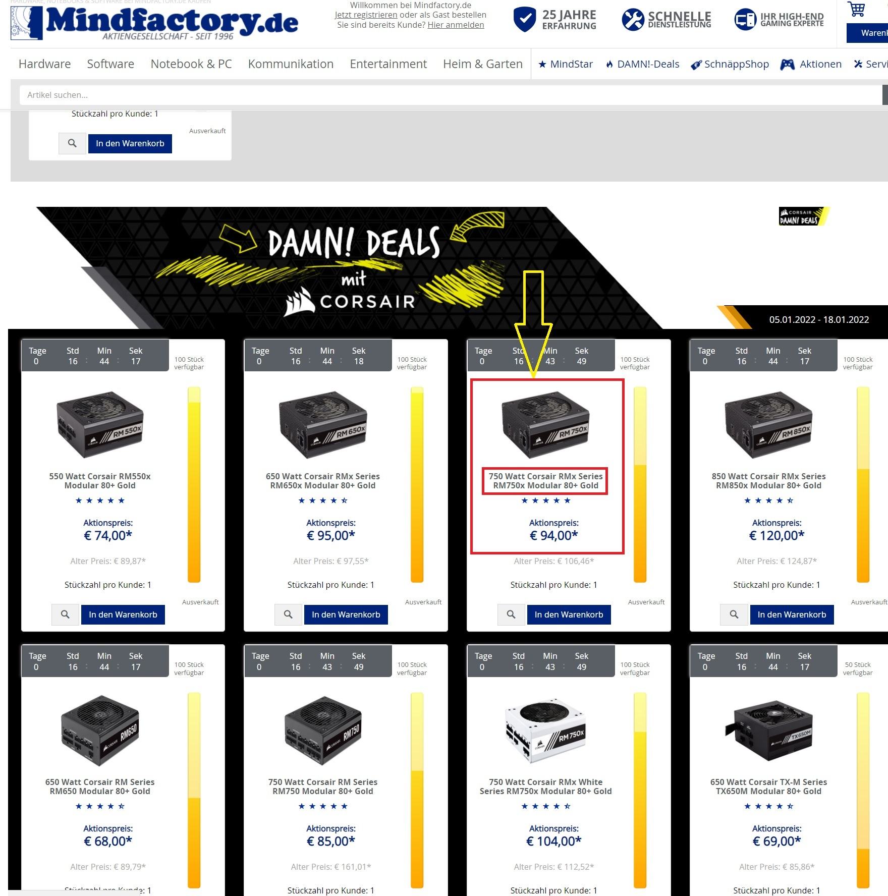

Seasonic Focus GX 750W ATX 2.4 (FOCUS-GX-750) ab 97 Euro: https://geizhals.de/seasonic-focus-gx-750w-atx-2-4-focus-gx-750-a2119986.html?hloc=at&hloc=de
Oder das Corsair RMx Series RM750x 2018, 750W ATX 2.4 (CP-9020179-EU) für 94 Euro in den Mindfactory DAMN! Corsair Deals: https://www.mindfactory.de/DAMN#minddeal_521
