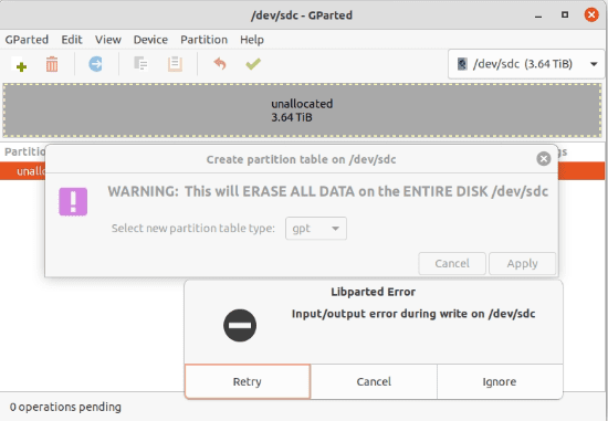

Denke ich mir, soweit so gut, und ich schreib eine neue Partitiontable drauf mit gparted:
Und das ist die Ausgabe im Log:
Code:
[Di Nov 17 09:36:52 2020] Buffer I/O error on dev sdc, logical block 976754624, lost async page write
[Di Nov 17 09:36:52 2020] sd 7:0:0:0: [sdc] tag#47 FAILED Result: hostbyte=DID_OK driverbyte=DRIVER_SENSE
[Di Nov 17 09:36:52 2020] sd 7:0:0:0: [sdc] tag#47 Sense Key : Hardware Error [current] [descriptor]
[Di Nov 17 09:36:52 2020] sd 7:0:0:0: [sdc] tag#47 <<vendor>>ASC=0x81 ASCQ=0x0
[Di Nov 17 09:36:52 2020] sd 7:0:0:0: [sdc] tag#47 CDB: Write(16) 8a 00 00 00 00 01 d1 c0 ba 00 00 00 04 00 00 00
[Di Nov 17 09:36:52 2020] blk_update_request: critical target error, dev sdc, sector 7814035968 op 0x1:(WRITE) flags 0x4800 phys_seg 128 prio class 0
[Di Nov 17 09:36:52 2020] Buffer I/O error on dev sdc, logical block 976754496, lost async page write
[Di Nov 17 09:36:52 2020] Buffer I/O error on dev sdc, logical block 976754497, lost async page write
[Di Nov 17 09:36:52 2020] Buffer I/O error on dev sdc, logical block 976754498, lost async page write
[Di Nov 17 09:36:52 2020] Buffer I/O error on dev sdc, logical block 976754499, lost async page write
[Di Nov 17 09:36:52 2020] Buffer I/O error on dev sdc, logical block 976754500, lost async page write
[Di Nov 17 09:36:52 2020] Buffer I/O error on dev sdc, logical block 976754501, lost async page write
[Di Nov 17 09:36:52 2020] Buffer I/O error on dev sdc, logical block 976754502, lost async page write
[Di Nov 17 09:36:52 2020] sd 7:0:0:0: [sdc] tag#33 FAILED Result: hostbyte=DID_OK driverbyte=DRIVER_SENSE
[Di Nov 17 09:36:52 2020] sd 7:0:0:0: [sdc] tag#33 Sense Key : Hardware Error [current] [descriptor]
[Di Nov 17 09:36:52 2020] sd 7:0:0:0: [sdc] tag#33 <<vendor>>ASC=0x81 ASCQ=0x0
[Di Nov 17 09:36:52 2020] sd 7:0:0:0: [sdc] tag#33 CDB: Write(16) 8a 00 00 00 00 01 d1 c0 be a0 00 00 00 10 00 00
[Di Nov 17 09:36:52 2020] blk_update_request: critical target error, dev sdc, sector 7814037152 op 0x1:(WRITE) flags 0x800 phys_seg 2 prio class 0
[Di Nov 17 09:36:52 2020] sd 7:0:0:0: [sdc] tag#44 FAILED Result: hostbyte=DID_OK driverbyte=DRIVER_SENSE
[Di Nov 17 09:36:52 2020] sd 7:0:0:0: [sdc] tag#44 Sense Key : Hardware Error [current] [descriptor]
[Di Nov 17 09:36:52 2020] sd 7:0:0:0: [sdc] tag#44 <<vendor>>ASC=0x81 ASCQ=0x0
[Di Nov 17 09:36:52 2020] sd 7:0:0:0: [sdc] tag#44 CDB: Write(16) 8a 00 00 00 00 00 00 00 00 00 00 00 04 00 00 00
[Di Nov 17 09:36:52 2020] blk_update_request: critical target error, dev sdc, sector 0 op 0x1:(WRITE) flags 0x800 phys_seg 128 prio class 0

Aber beschreiben lässt sie sich immer noch nicht:
Code:
[Do Nov 19 20:51:25 2020] sdc: detected capacity change from 0 to 4000787030016
[Do Nov 19 20:52:31 2020]  sdd:
[Do Nov 19 20:52:31 2020]  sdf: sdf1
[Do Nov 19 20:52:32 2020]  sdd:
[Do Nov 19 20:52:32 2020]  sdf: sdf1
[Do Nov 19 20:52:47 2020] sd 7:0:0:0: [sdc] tag#81 FAILED Result: hostbyte=DID_OK driverbyte=DRIVER_SENSE
[Do Nov 19 20:52:47 2020] sd 7:0:0:0: [sdc] tag#81 Sense Key : Hardware Error [current] [descriptor]
[Do Nov 19 20:52:47 2020] sd 7:0:0:0: [sdc] tag#81 <<vendor>>ASC=0x81 ASCQ=0x0
[Do Nov 19 20:52:47 2020] sd 7:0:0:0: [sdc] tag#81 CDB: Write(16) 8a 00 00 00 00 00 00 02 00 00 00 00 00 08 00 00
[Do Nov 19 20:52:47 2020] blk_update_request: critical target error, dev sdc, sector 131072 op 0x1:(WRITE) flags 0x800 phys_seg 1 prio class 0
[Do Nov 19 20:52:47 2020] Buffer I/O error on dev sdc, logical block 16384, lost async page write
[Do Nov 19 20:52:47 2020] sd 7:0:0:0: [sdc] tag#82 FAILED Result: hostbyte=DID_OK driverbyte=DRIVER_SENSE
[Do Nov 19 20:52:47 2020] sd 7:0:0:0: [sdc] tag#82 Sense Key : Hardware Error [current] [descriptor]
[Do Nov 19 20:52:47 2020] sd 7:0:0:0: [sdc] tag#82 <<vendor>>ASC=0x81 ASCQ=0x0
[Do Nov 19 20:52:47 2020] sd 7:0:0:0: [sdc] tag#82 CDB: Write(16) 8a 00 00 00 00 00 20 00 00 00 00 00 00 08 00 00
[Do Nov 19 20:52:47 2020] blk_update_request: critical target error, dev sdc, sector 536870912 op 0x1:(WRITE) flags 0x800 phys_seg 1 prio class 0
[Do Nov 19 20:52:47 2020] Buffer I/O error on dev sdc, logical block 67108864, lost async page write
[Do Nov 19 20:52:47 2020] sd 7:0:0:0: [sdc] tag#84 FAILED Result: hostbyte=DID_OK driverbyte=DRIVER_SENSE
[Do Nov 19 20:52:47 2020] sd 7:0:0:0: [sdc] tag#84 Sense Key : Hardware Error [current] [descriptor]
[Do Nov 19 20:52:47 2020] sd 7:0:0:0: [sdc] tag#84 <<vendor>>ASC=0x81 ASCQ=0x0
[Do Nov 19 20:52:47 2020] sd 7:0:0:0: [sdc] tag#84 CDB: Write(16) 8a 00 00 00 00 01 d1 c0 be 00 00 00 00 08 00 00
[Do Nov 19 20:52:47 2020] blk_update_request: critical target error, dev sdc, sector 7814036992 op 0x1:(WRITE) flags 0x800 phys_seg 1 prio class 0
[Do Nov 19 20:52:47 2020] Buffer I/O error on dev sdc, logical block 976754624, lost async page write
[Do Nov 19 20:52:47 2020] sd 7:0:0:0: [sdc] tag#83 FAILED Result: hostbyte=DID_OK driverbyte=DRIVER_SENSE
[Do Nov 19 20:52:47 2020] sd 7:0:0:0: [sdc] tag#83 Sense Key : Hardware Error [current] [descriptor]
[Do Nov 19 20:52:47 2020] sd 7:0:0:0: [sdc] tag#83 <<vendor>>ASC=0x81 ASCQ=0x0
[Do Nov 19 20:52:47 2020] sd 7:0:0:0: [sdc] tag#83 CDB: Write(16) 8a 00 00 00 00 01 d1 c0 ba 00 00 00 04 00 00 00
[Do Nov 19 20:52:47 2020] blk_update_request: critical target error, dev sdc, sector 7814035968 op 0x1:(WRITE) flags 0x4800 phys_seg 128 prio class 0
[Do Nov 19 20:52:47 2020] Buffer I/O error on dev sdc, logical block 976754496, lost async page write
[Do Nov 19 20:52:47 2020] Buffer I/O error on dev sdc, logical block 976754497, lost async page write
[Do Nov 19 20:52:47 2020] Buffer I/O error on dev sdc, logical block 976754498, lost async page write
[Do Nov 19 20:52:47 2020] Buffer I/O error on dev sdc, logical block 976754499, lost async page write
[Do Nov 19 20:52:47 2020] Buffer I/O error on dev sdc, logical block 976754500, lost async page write
[Do Nov 19 20:52:47 2020] Buffer I/O error on dev sdc, logical block 976754501, lost async page write
[Do Nov 19 20:52:47 2020] Buffer I/O error on dev sdc, logical block 976754502, lost async page write
[Do Nov 19 20:52:47 2020] sd 7:0:0:0: [sdc] tag#85 FAILED Result: hostbyte=DID_OK driverbyte=DRIVER_SENSE
[Do Nov 19 20:52:47 2020] sd 7:0:0:0: [sdc] tag#85 Sense Key : Hardware Error [current] [descriptor]
[Do Nov 19 20:52:47 2020] sd 7:0:0:0: [sdc] tag#85 <<vendor>>ASC=0x81 ASCQ=0x0
[Do Nov 19 20:52:47 2020] sd 7:0:0:0: [sdc] tag#85 CDB: Write(16) 8a 00 00 00 00 01 d1 c0 be a0 00 00 00 10 00 00
[Do Nov 19 20:52:47 2020] blk_update_request: critical target error, dev sdc, sector 7814037152 op 0x1:(WRITE) flags 0x800 phys_seg 2 prio class 0
[Do Nov 19 20:52:47 2020] sd 7:0:0:0: [sdc] tag#80 FAILED Result: hostbyte=DID_OK driverbyte=DRIVER_SENSE
[Do Nov 19 20:52:47 2020] sd 7:0:0:0: [sdc] tag#80 Sense Key : Hardware Error [current] [descriptor]
[Do Nov 19 20:52:47 2020] sd 7:0:0:0: [sdc] tag#80 <<vendor>>ASC=0x81 ASCQ=0x0
[Do Nov 19 20:52:47 2020] sd 7:0:0:0: [sdc] tag#80 CDB: Write(16) 8a 00 00 00 00 00 00 00 00 00 00 00 04 00 00 00
[Do Nov 19 20:52:47 2020] blk_update_request: critical target error, dev sdc, sector 0 op 0x1:(WRITE) flags 0x800 phys_seg 128 prio class 0
[Do Nov 19 20:52:49 2020] sd 7:0:0:0: [sdc] tag#91 FAILED Result: hostbyte=DID_OK driverbyte=DRIVER_SENSE
[Do Nov 19 20:52:49 2020] sd 7:0:0:0: [sdc] tag#91 Sense Key : Hardware Error [current] [descriptor]
[Do Nov 19 20:52:49 2020] sd 7:0:0:0: [sdc] tag#91 <<vendor>>ASC=0x81 ASCQ=0x0
[Do Nov 19 20:52:49 2020] sd 7:0:0:0: [sdc] tag#91 CDB: Write(16) 8a 00 00 00 00 01 d1 c0 be 98 00 00 00 18 00 00
[Do Nov 19 20:52:49 2020] blk_update_request: critical target error, dev sdc, sector 7814037144 op 0x1:(WRITE) flags 0x800 phys_seg 3 prio class 0
[Do Nov 19 20:52:49 2020] sd 7:0:0:0: [sdc] tag#90 FAILED Result: hostbyte=DID_OK driverbyte=DRIVER_SENSE
[Do Nov 19 20:52:49 2020] sd 7:0:0:0: [sdc] tag#90 Sense Key : Hardware Error [current] [descriptor]
[Do Nov 19 20:52:49 2020] sd 7:0:0:0: [sdc] tag#90 <<vendor>>ASC=0x81 ASCQ=0x0
[Do Nov 19 20:52:49 2020] sd 7:0:0:0: [sdc] tag#90 CDB: Write(16) 8a 00 00 00 00 00 00 00 00 00 00 00 00 18 00 00
[Do Nov 19 20:52:49 2020] blk_update_request: critical target error, dev sdc, sector 0 op 0x1:(WRITE) flags 0x800 phys_seg 3 prio class 0
