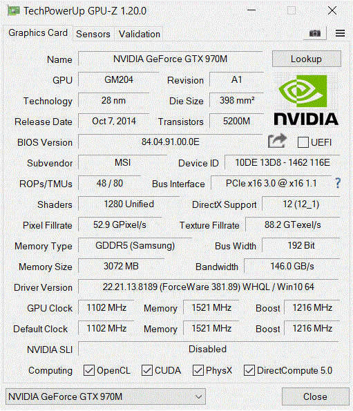

Nach zahllosen versuchen, Kopfschmerz und mittlerweile einigen Kubikmetern Kaffee
gelang es mir zunächst, mein vbios um 200mhz+ erhöhen um dann manuell mit Afterburner
noch 135mhz zu addieren, ohne die Voltage zu berühren. VORSICHT: Ich habe Festgestellt, dass
unterschiedliche NVidia Treiberversionen auch in unterschiedlichen Übertaktungen resultieren..
und zwar komplett ohne Fummelei an der vCore! Jedenfalls Mein vBios war aber längst nicht so
"sauber" gemoddet wie das hier angebotene.
Nun hat der user "cuneyt1984" es endlich geschafft ein vBios auf fast der Performance einer 980m
zu erstellen und auf einem der anderen Foren, die ich regelmäßig besuche geteilt.
Alle credits gehen an cuneyt1984!
Yeah. I have developed a Vbios that has been able to access the GTX 980m performance of the GTX 970m graphics card, which does not damage the stable graphics card after I have worked for a long time.
Installation process:
To Install OC Mode Vbios Start your computer in Safe mode. The adapter must be properly connected to the computer before you load it. Then open the compressed file. Double-click the file named FVBIOS and run it. Answer the questions on the Dos screen by pressing the y key. Please wait while Vbios is loading. The dos screen will automatically shut down after Vbios is loaded.
For version 3 the power limit has been increased to 9%.
OCMod Vbios Features:
1. The basic GPU frequency was increased from 1038 to 1215.
2. The memory frequency was increased from 2505 to 3042.
3. As a result of the overclocking, the performance of the card provided 15-20% performance increase in 3D applications.
4. In the stability tests, the card was found to have no power and voltage-dependent performance drops.
5. It is seen that there are slight deviations in the frequency of the GPU and that it is at normal values.
6. When the turbo fan is off, it is observed that due to the thermal heat, the drop in the speed of the gpu is very small.
7. It has been observed that in the 3D applications of the card, it has increased by 4 degrees from the normal temperature values.
As a result, Vbios was produced at very high level of performance and performance.
Note: OC Mode Vbios If you do not like it, you can load the original Vbios again.
