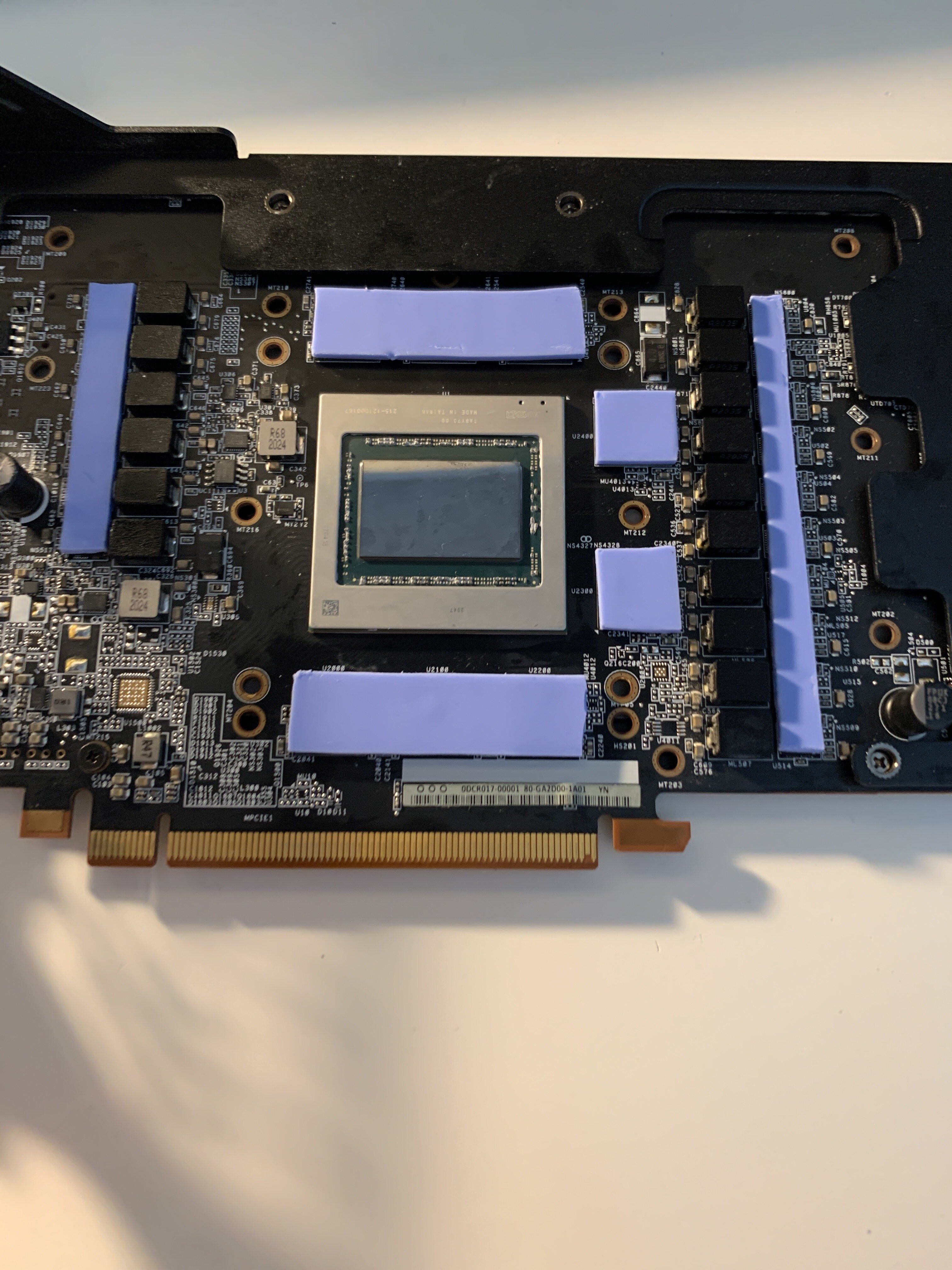

This thermal pad placment is correct right? Did I miss out on any spots
Better you cut every pad in exact Size of the vram Chips like you have done on the right side, for better contact of the cooler.
