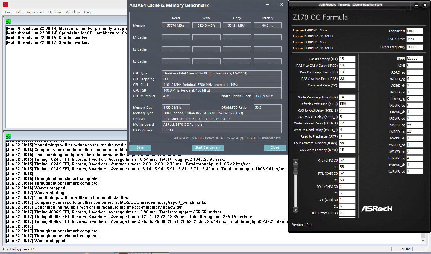

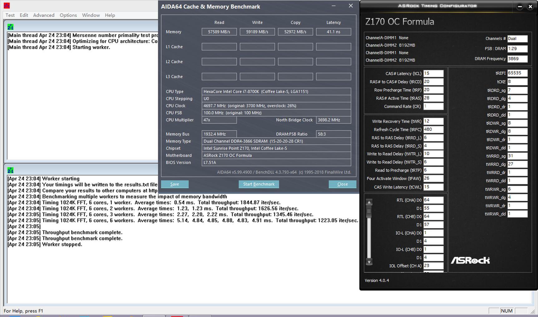

I got 2 kits of Crucial Ballistix 3600 last week and spent a whole week testing them.
It is quite different from other ICs, tRAS≈2*tRCD, tRFC>280ns, a large voltage range in stress testing, up to 1.6v!
1. Sub timings tWR/tFAW Auto
Passed 2 cycles of TM5 1usmus v3 testing, but failed at 3rd cycle.
Benchmark @3866 15 18 18 38 1T
2. Loose tRCD, tighten Sub timings
All of these can pass 3 cycles on my platform at different voltages (1.49~1.59v).
Benchmark E die 3866C15 1T VS CJR 3866C15 1T VS CJR 4000C16 2T
You can find something interesting here.
E die @3866 15 19 19 38 1T
CJR @3866 15 20 20 28 1T
CJR @4000 16 21 21 28 1T
The performance of CJR running at CR 1T is beyond my expectation.
3. Timing difference between CJR and E die
E die can boot at tRDRD/tWRWR sg=6 and stable at 7.
CJR can only boot at tWRWR sg=6 and stable.
E die is easier reach CR 1T and lower CL than CJR.

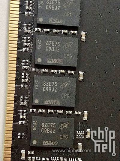

IC: C9BJZ via:chiphell.com

Danke, Ergebnisse sind im Startbeitrag ergänzt. Sofern nicht noch irgendwer etwas parat hat, was völlig aus dem Rahmen fällt, reicht das nun auch erst mal für Ryzen 1st/2nd Gen. Ein paar Intel & Zen2 Ergebnisse können aber auf jeden Fall noch mit rein.
Neither of those two kits was able to hit 4000 or 4133 on your OC Formula?
Would you mind posting a proper screen with CPU-Z Tabs, AidaMEM and a more Test Cycles for those E-Die @ 3866?
Yeah, it can't boot when using A2 PCB, the fan is whistling and no Qcode shown. I try to loose the tCWL but failed.
I have shared the better kit with my friends and update them later.

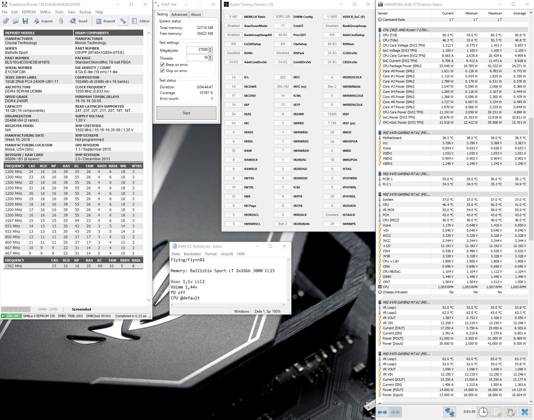

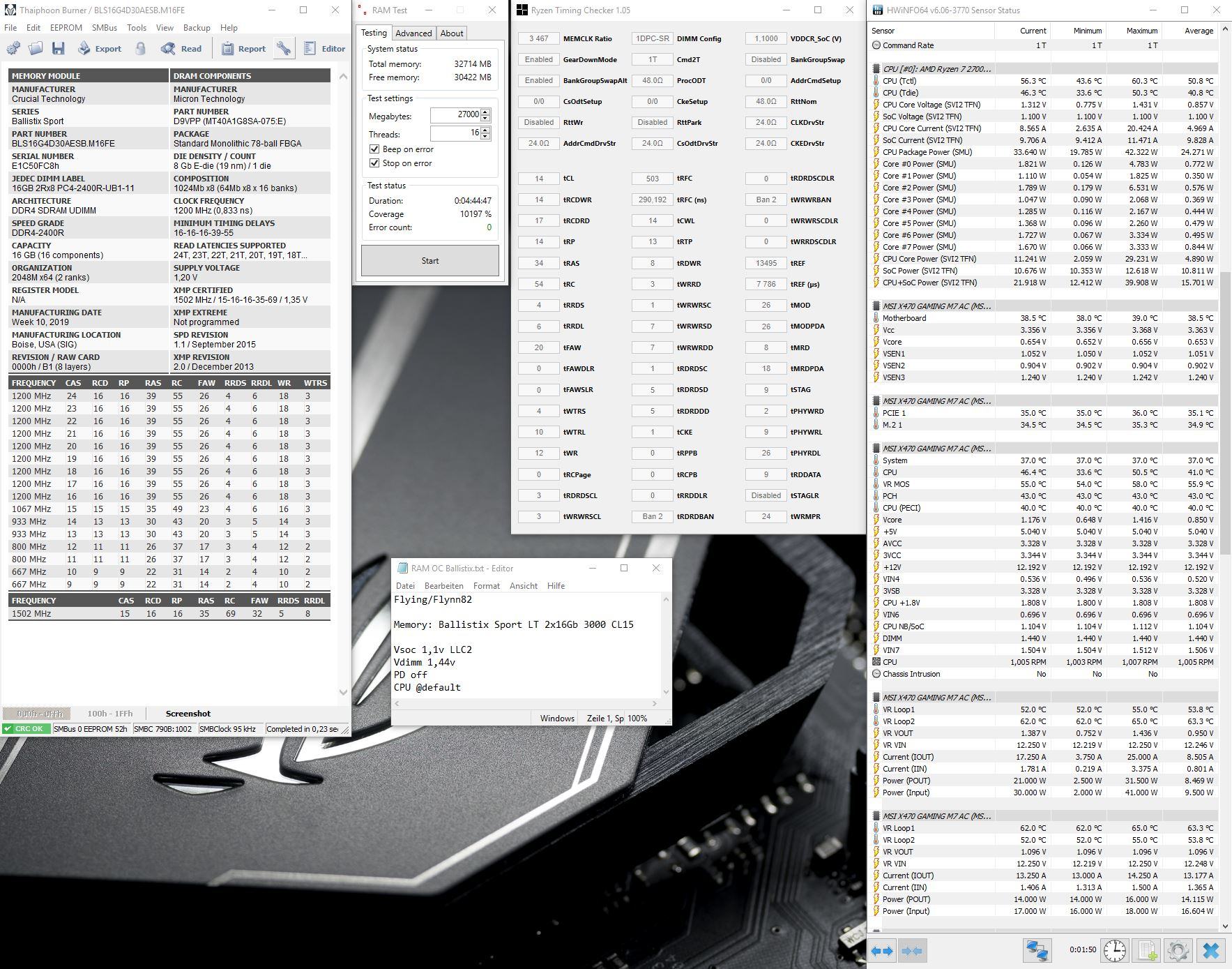

Ryzen 1700, Asus B450 TUF PRO GAMING
BLS16G4D30AESE 2x16 DR
