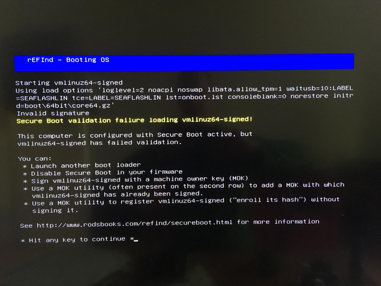

Ich habe gerade herausgefunden Seagate hat einen neuen Firmware bereit AR17, bin noch auf AR13.
Ich schaffe es nicht zu wechseln, bleibe wegen Secure Boot stecken (siehe Bild).
Ich habe einen thread beim ASUS forum gestartet aber habe keine Antwort bis jetzt, der lautet so :
Hi, I have Gene, with 3401,
I have a Seagate Archive 8TB storage HDD drive. I found out Seagate released a new firmware.
I did execute the dedicated Seagate tool to build a USB bootable drive.
I get the following screen after boot, with "secure boot validation failure".
I did some research and tries, tried disabling CSM, tried the setting "other OS" under Secure Boot.
But then, it eventually hangs similarly, before reaching "Invalid Signature" while Secure Boot Status remains Active in Bios.
I tried setting passwords, still, the Secure Boot Status remains grayed out and active.
I couldn't find any specific help online, it seems nobody has done that update or has had problems doing it before.
Can you help ? this can't be a big problem

I managed to update these drives to the latest firmware by downloading the following files :
ExosX16-Evans-STD-SATA-512E-SN02.zip - contains the update tool for windows
Archive-LamarR-SATA-STD-512E-AR17.zip - AR17 firmware for ST8000AS0002
I performed the update within a Windows RAID 0, which I guess I really shouldn't have done when upgrading from AR13 to AR17.
With the windows command line as RUN AS ADMINISTRATOR :
To identify the device :
SeaChest_Firmware_254_1183_64s.exe --scan
Notedown the Handle of the device
To update the device :
SeaChest_Firmware_254_1183_64s.exe -d SCSI0:2 --downloadFW LamarRArchiveSATA-STD-512E-AR17.LOD
You need to change SCSI0:2 to the device you are using.

FYI - I also updated using these files on linux with the tool included in the file Archive-LamarR-SATA-STD-512E-AR17.zip. Worked like a charm! (y)
