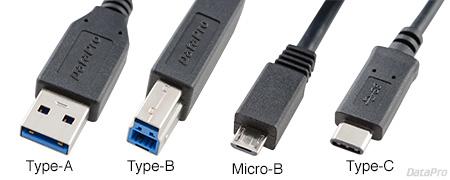

What is a USB Type-C Alternate Mode?
Alternate Mode (sometimes abbreviated Alt Mode) is a feature of USB-C that allows the physical jack to carry other types of video and data signals without the need for conversion.
Current USB Type-C alt modes include:
- Thunderbolt
- DisplayPort
- HDMI
- MHL
- Analog audio
USB 3.1 Type-C (sometimes abbreviated as USB-C) has been been making headlines with its radical redesign of the ubiquitous USB connector, and intriguing new features. Where did it come from? Where is it going? And how can you make use of it? Read on!
