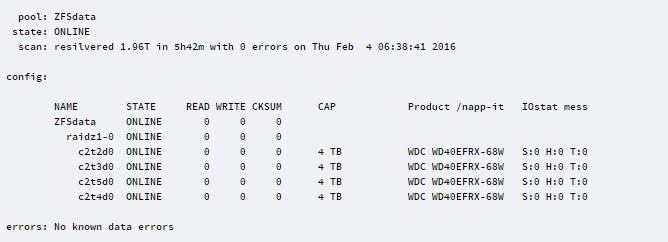

Ich hab' wohl ein Problem mit einer meiner WD Reds in einem Pool:
Napp-it zeigt mir im Pool eine DISK als "DEGRADED". Entsprechend zeigte der letzte scrub auch fehler im zpool status:
pool: ZFSdata
state: DEGRADED
status: One or more devices has been diagnosed as degraded. An attempt
was made to correct the error. Applications are unaffected.
action: Determine if the device needs to be replaced, and clear the errors
using 'zpool clear' or 'fmadm repaired', or replace the device
with 'zpool replace'.
Run 'zpool status -v' to see device specific details.
scan: scrub repaired 311M in 6h02m with 0 errors on Mon Feb 1 09:02:45 2016
Nappit zeigt mir unter Disk-->Smartinfo:
c2t2d0 ZFSdata raidz1-0 DEGRADED S:3 H:0 T:0 WDC WD40EFRX-68WT0N0 sat,12 PASSED 37 °C WDWCC4E0XRY96D -- short long abort log
...berichtet also: smart_health=PASSED
zpool status -v auf dem Pool liefert:
state: DEGRADED
config:
NAME STATE READ WRITE CKSUM
ZFSdata DEGRADED 0 0 0
raidz1-0 DEGRADED 0 0 0
c2t2d0 DEGRADED 0 0 0
c2t3d0 ONLINE 0 0 0
c2t4d0 ONLINE 0 0 0
c2t5d0 ONLINE 0 0 0
device details:
c2t2d0 DEGRADED too many errors
status: FMA has degraded this device.
action: Run 'fmadm faulty' for more information. Clear the errors
using 'fmadm repaired'.
see: http://support.oracle.com/msg/ZFS-8000-GH for recovery
errors: No known data errors
fmadm faulty sagt:
Suspect 1 of 1 :
Problem class : fault.fs.zfs.vdev.checksum
Certainty : 100%
Affects : zfs://pool=b89c4c12f3306240/vdev=5148cd3322e84e8a/pool_name=ZFSdata/vdev_name=id1,sd@SATA_____WDC_WD40EFRX-68W_____WD-WCC4E0XRY96D/a
Status : faulted but still providing degraded service
FRU
Status : faulty
FMRI : "zfs://pool=b89c4c12f3306240/vdev=5148cd3322e84e8a/pool_name=ZFSdata/vdev_name=id1,sd@SATA_____WDC_WD40EFRX-68W_____WD-WCC4E0XRY96D/a"
Description : The number of checksum errors associated with ZFS device
'id1,sd@SATA_____WDC_WD40EFRX-68W_____WD-WCC4E0XRY96D/a' in pool
'ZFSdata' exceeded acceptable levels.
Response : The device has been marked as degraded. An attempt will be made
to activate a hot spare if available.
Impact : Fault tolerance of the pool may be compromised.
Action : Use 'fmadm faulty' to provide a more detailed view of this event.
Run 'zpool status -lx' for more information. Please refer to the
associated reference document at
http://support.oracle.com/msg/ZFS-8000-GH for the latest service
procedures and policies regarding this diagnosis.
Daraus schließe ich mal, dass der Platte wohl nicht mehr zu trauen ist...
Welcher von den verschiedenen sich anbietenden Wegen (remove/detach+attach/replace...?) ist denn die richtige Vorgehensweise, um eine defekte Festplatte aus einem RaidZ(1)-Pool auszutauschen?
Ich habe allerdings das Problem, dass ich eigentlich gerne die neue Festplatte (gleicher Typ, WD Red WD40EFRX-68W) wieder an die gleiche Stelle im Gehäuse und auch am Controller setzen würde. Geht das? Wenn ja, wie gesagt die Frage: wie am besten?
Man kann nur gespiegelte Platten, L2ARC oder ZIL devices aus einem ZFS Pool entfernen.
Eine defekte Raid-Z Platte kann man also nur ersetzen (Disk >> Replace)

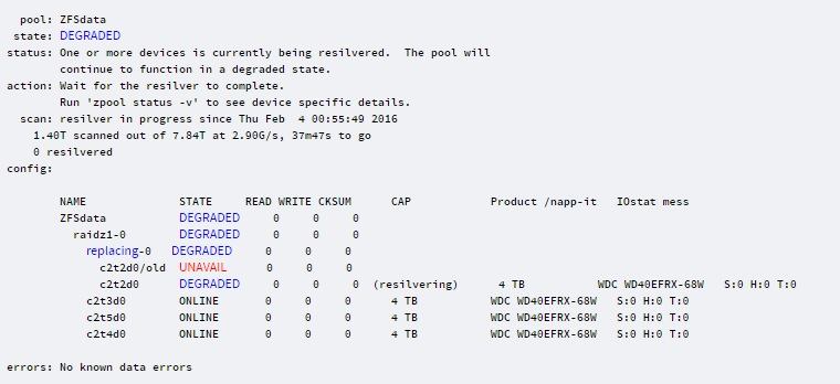

Wenn der Controller hotplug kann kann man Platten einfach aus/einstecken und dann::
Disk >> replace >> alte Platte -> neue Platte
Ohne Hotplug, Rechner zum Plattenwechsel herunterfahren
Mit portbasierten id's wie c2t2d0 (Controller 2, Disk 2) kann man die Platte im gleichen Slot ersetzen
indem man Sie austauscht und dann Disk >>replace "id" aufruft (also nur die alte Platte angibt):
Disk >> replace >> c2t2d0
Die defekte Platte würde ich mit einem Low Level Tool testen.
Merci mal wieder! Genau das waren die mir fehlenden Infos! =)
Jetzt also hoffen, dass bis zur Lieferung der ErsatzHDD und beim resilver nicht noch eine aussteigt... ;)
Sorry, bin noch etwas nervös nach dem Plattenausfall, Datenmengen, Lesefehler beim Resilver & Co. ... =)
Technisch habe ich aber doch zunächst alles richtig gemacht beim Replace, wenn Napp-it mir folgendes zeigt:
Oder?
Zweite Frage: mit welchem Tool sollte ich denn zum Beispiel die defekte Platte mal auf Herz und Nieren prüfen? (Am liebsten (nativ) unter Windows, das hab ich halt grad überall am laufen wo ich mal schnell ne Platte einstöpseln könnte - zur Not halt Linux/LiveCD).
Danke nochmal vorab!
EDIT: Sieht gut aus...

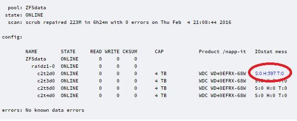

Hmmm... das lowlevel-Tool von WD zeigt auch beim extended Test "PASS". Dann mach ich jetzt mal eine lowlevel-Formatierung und schau' mal, was dann dabei heraus kommt. Läuft ja nur noch etwas mehr als 101 Stunden... *kotz*
Wenn's NICHT an der Platte lag, müsste ja umgekehrt nach ein paar Tagen auch wieder die neue Platte aussteigen und der Pool DEGRADED zeigen. .
Das ist der Fluch der großen Platten.
Die Kapazität hat sich in den letzten Jahren verzehnfacht, die Performance aber nur verdoppelt.
ZFS meldet Probleme wegen der Prüfsummen extrem zuverlässig - ohne wüsste man von den meisten Problemen nichtmal etwas. Wenn ZFS die Platte aus dem Pool rauswirft, dann ist/war da etwas. Wenn nicht die Platte, dann ein Kabel, Steckkontakt, HBA oder PSU etc

Hmm.. ich habe über meinen resilvered pool mal ein Scrub laufen lassen und die Pool-Übersicht zeigt wieder was in blau - jetzt auf der neuen Platte:
Was heisst das denn? Soll ich nochmal einen Scrub drüber jagen und schauen ob dann weg? War's doch nicht die Platte?
