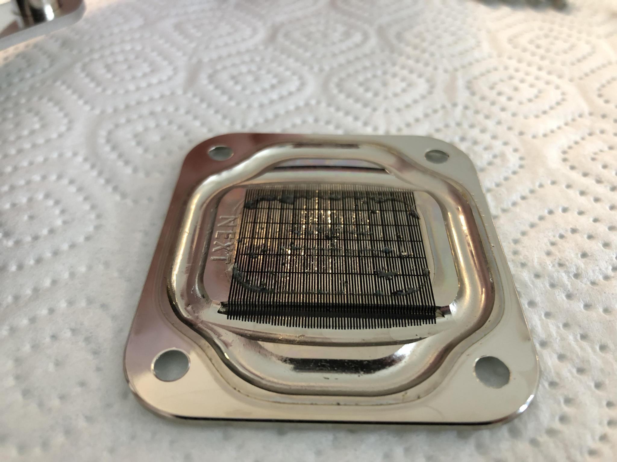

It took me one more week to take my cooler apart (sorry), but despite the great and not changing temps the cooler was a bit "gunked":
old EK clear fluid, ZMT tubing, rads: Mora, EK SE360 later a HWLabs 360 GTS (never flushed them before).
Thanks for the reply,
The gunk you talked about may be from the radiator since you did not flushed it before use same can be said about the tubing best to flush your tubing as well before usage. But other then that your cpu block looks good (no oxidation). It's vital one flushes radiators before using them and even then it can still release particles over time. That's why I now use Aquacomputer AMS rads no Flux no solder.
Thank you for providing the picture much appreciated.
