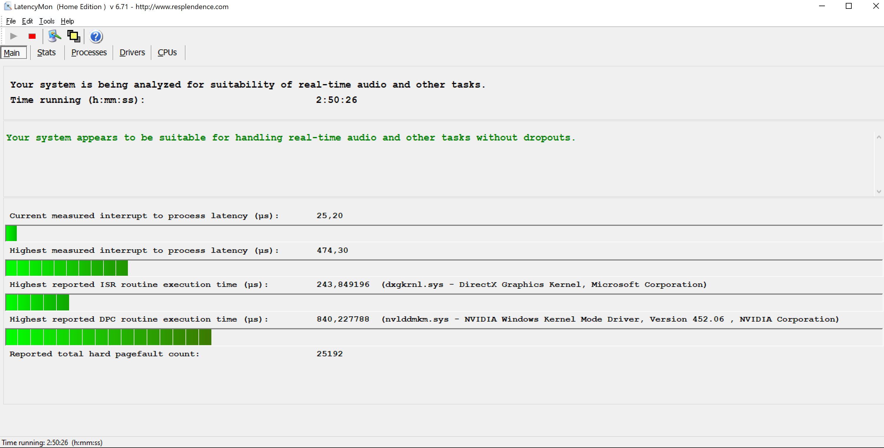

Ich würde mit Latencymon mal schauen ob ein Treiber oder irgendein Prozess Probleme macht. Die meisten Probleme entstehen durch irgendwelche "Verschlimmbesserungsprogramme" weil viele Anwender glauben ihre Kiste damit schneller oder stabiler zu machen. Im Grunde ist sogut wie immer das Gegenteil der Fall.

Könntest du mir kurz sagen auf was ich bei dem Programm achten sollte? Mein Englisch ist dürftig.

Your system appears to be suitable for handling real-time audio and other tasks without dropouts.
LatencyMon has been analyzing your system for 0:01:41 (h:mm:ss) on all processors.

MEASURED INTERRUPT TO USER PROCESS LATENCIES
_________________________________________________________________________________________________________
The interrupt to process latency reflects the measured interval that a usermode process needed to respond to a hardware request from the moment the interrupt service routine started execution. This includes the scheduling and execution of a DPC routine, the signaling of an event and the waking up of a usermode thread from an idle wait state in response to that event.
Highest measured interrupt to process latency (µs): 118,40
Average measured interrupt to process latency (µs): 4,794489
Highest measured interrupt to DPC latency (µs): 106,0
Average measured interrupt to DPC latency (µs): 1,201135

Interrupt service routines are routines installed by the OS and device drivers that execute in response to a hardware interrupt signal.
Highest ISR routine execution time (µs): 102,118112
Driver with highest ISR routine execution time: dxgkrnl.sys - DirectX Graphics Kernel, Microsoft Corporation
Highest reported total ISR routine time (%): 0,027352
Driver with highest ISR total time: dxgkrnl.sys - DirectX Graphics Kernel, Microsoft Corporation
Total time spent in ISRs (%) 0,027536
ISR count (execution time <250 µs): 35668

DPC routines are part of the interrupt servicing dispatch mechanism and disable the possibility for a process to utilize the CPU while it is interrupted until the DPC has finished execution.
Highest DPC routine execution time (µs): 605,645663
Driver with highest DPC routine execution time: nvlddmkm.sys - NVIDIA Windows Kernel Mode Driver, Version 452.06 , NVIDIA Corporation
Highest reported total DPC routine time (%): 0,010910
Driver with highest DPC total execution time: dxgkrnl.sys - DirectX Graphics Kernel, Microsoft Corporation
Total time spent in DPCs (%) 0,024520
DPC count (execution time <250 µs): 87737

Hey, guck mal bitte. Ich habe das von dir genannte Programm laufen lassen und die Ergebnisse gepostet.

Schaut mir nicht nach Latenz Problemen aus. Um hier nicht ewig Zeit zu vergeuden und da "Ferndiagnosen" verdammt schwer sind empfehle ich immer

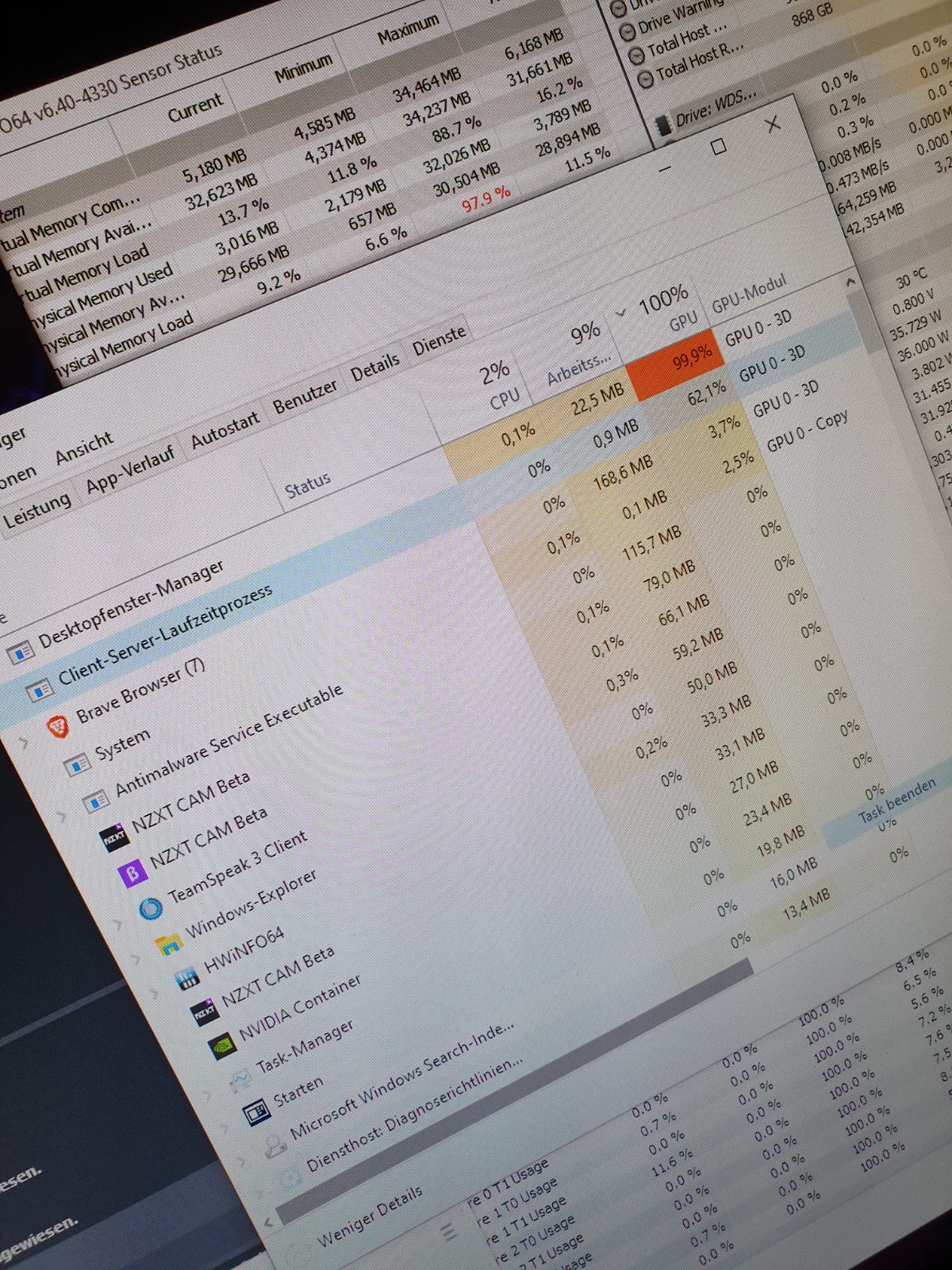

Bei mir heute wieder 2 mal eingefroren. Hatte noch einen anderen PCIE Steckplatz benutzt, aber selbe Fehler. Glaube mittlerweile echt, dass es die Grafikkarte ist siehe Bild (Bild gemacht während dem Freeze). Obwohl nicht grafisch intesives gemacht wurde. Hast du mittlerweile dein Fehler gefunden? Läuft bei dir Prime eigentlich ohne Fehler?

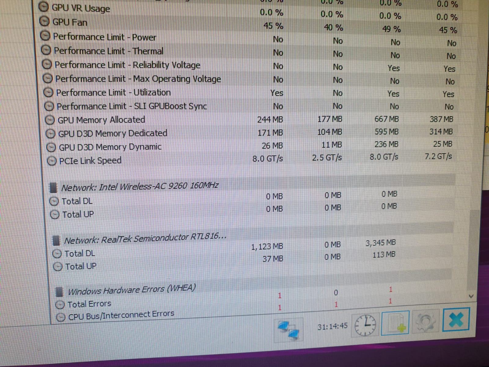

Gerade eben wieder gefreezed und das endeckt. Hardware Error CPU BUS/Interconnect
