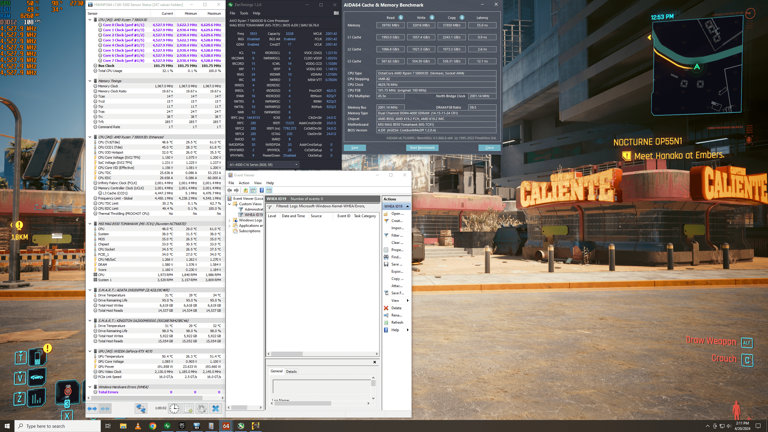

Yeah, precisely from here, where @Veii by his grace was found LCLK behavoir in ZenPTMonitor, and as you can see 592 is everywhere🤫

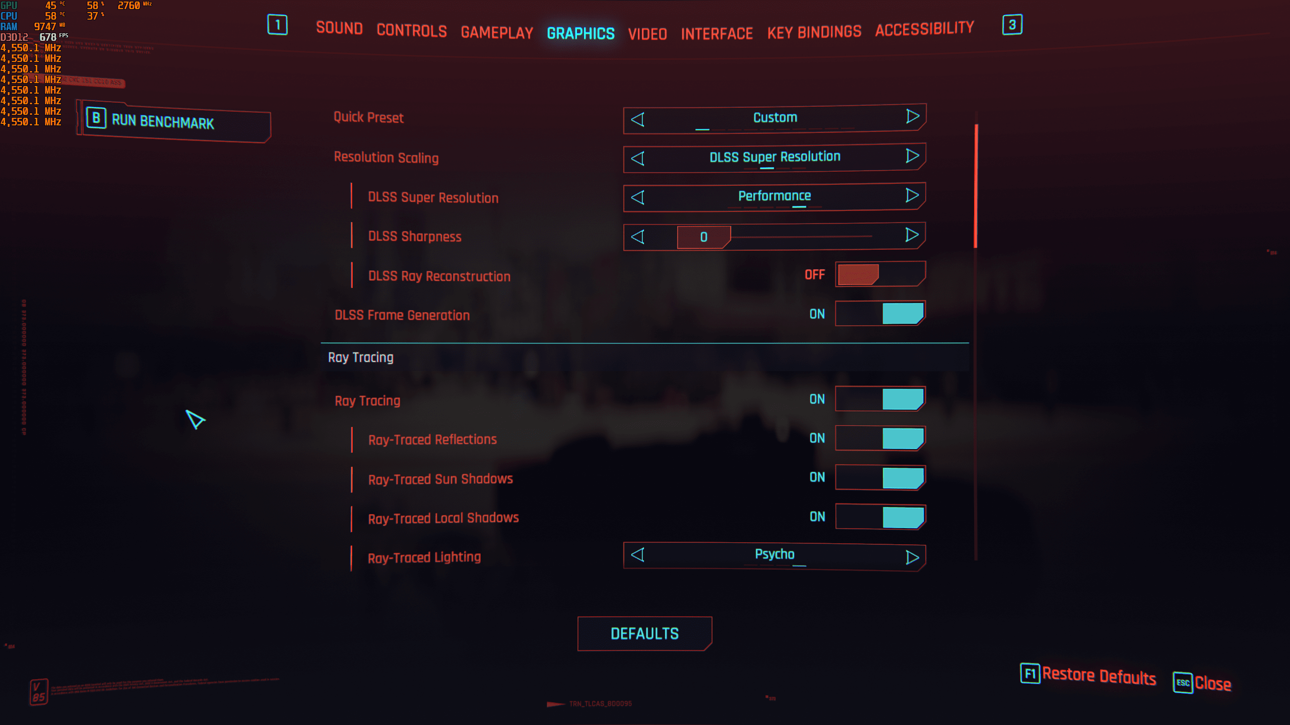

And 60 it's plenty enough A for EDC to see even more FPS in CP2077, with same Phoenix 4070 max. out 1440p High/Ultra settings + RayT psycho

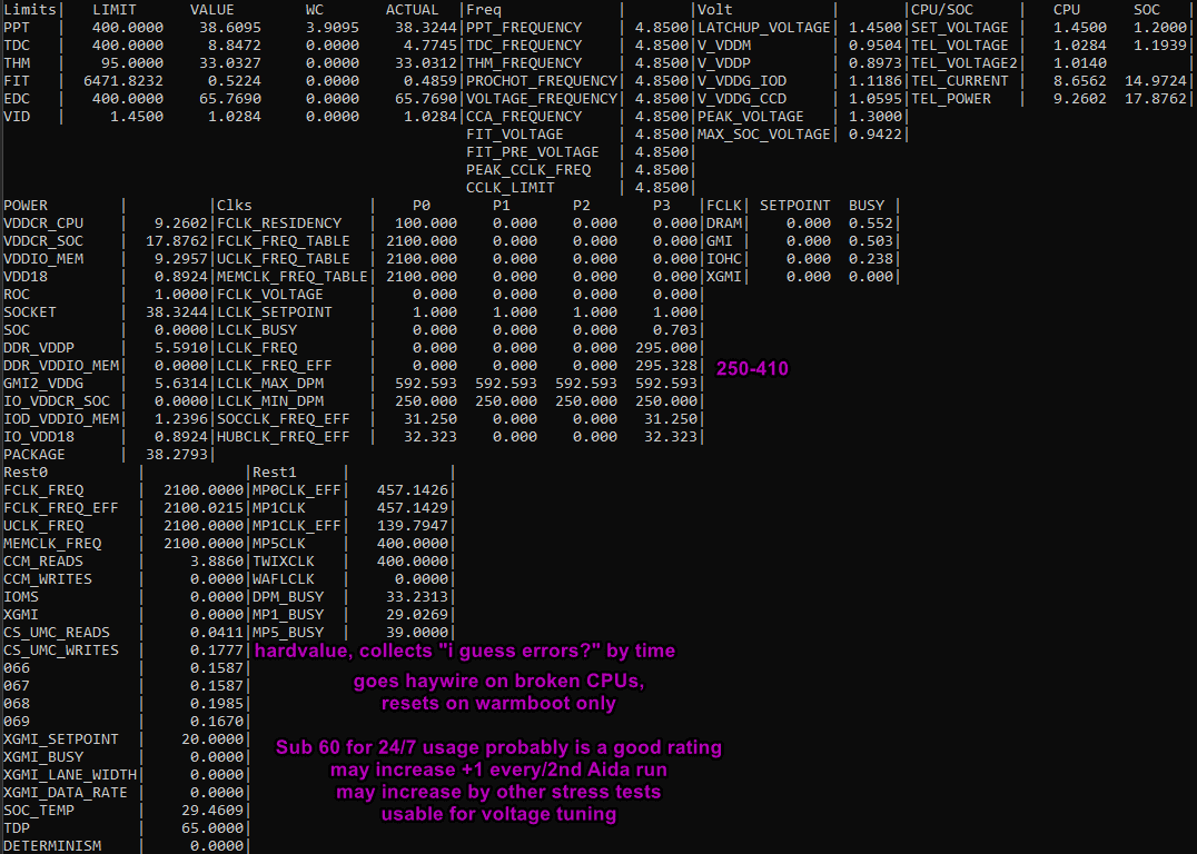

Credits for tool ~ XREHOPE, as always
LCLK recommended is 310-610, but may cause sound issues
X3D may be higher or lower by default. Unsure yet, but sure that SOCCLK is higher.
// AM5 is 150-2150??MHz
Tool still is not flawless (not every sensor is correctly labeled)
But seems current AGESA support remains.
You can run
280-593 on X3D, but i'm experimenting with it still // increased VDDG decreased SOC delta [jumping between 28.2-32ohm procODT], also experimenting tiny bit
High LCLK peak does increase arithmetic processing ability but can cause PCH soundloss. Doesn't seem to make too much IPC difference yet
For sub 2100 FCLK, absolutely not needed to be anywhere near 400MHz range. LCLK on (powersaving) ~ optimized LCLK for PCI 4.0 maybe off.
~location config for 1440p , i recommend that LUXX remakes it for 1080p~
I'm busy yesterday, today and tomorrow morning
But i'll check the messages later
Do not run this tool with Hydra, zentimings on autorefresh or HWinfo
They bother, this utilizes RSMU API & updates every 4-6ms, while HWInfo uses slow SMU consumer-api (every 30ms minimum)
Its low resource usage, but it still has UOPS overhead when benchmarking due to the pooling speed~

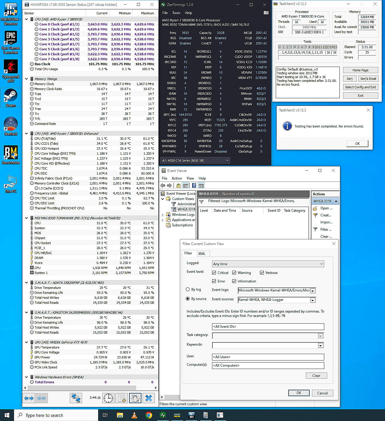

Also was jetzt Sieht sehr nach meiner Erfahrung aus bzgl vSOC / CCD / IOD . VDDP kommt mir bissi hoch vor, kann trotzdem mit ~0,9V laufen, sogar stabiler.

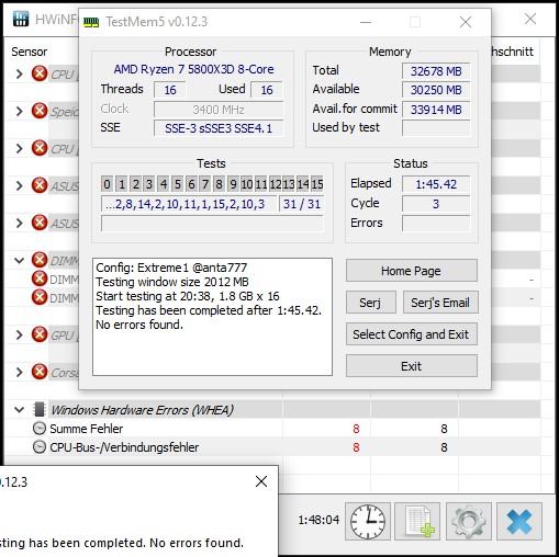

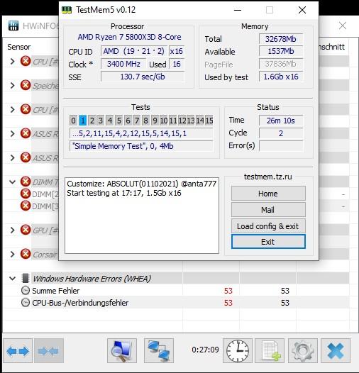

Ein paar Beobachtungen:
- Ich hatte die fixen 593 MHz LCLK -> TM5 WHEAs...
- dann hab ich mal 280 bis 593 LCLK eingegeben -> Lightoom rendern WHEAs...

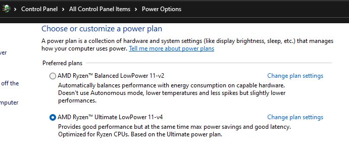

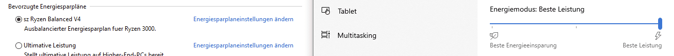

- Ich nutze schon sehr lange diesen Energiesparplan - und hier in der Regel immer beste Energieeinsparung.
- 593-610 LCLK erhöht. Da ich nich den ganten Tag TM5 spielen kann oder will, arbeite ich grad im Lightroom. 222 Fotos rausrender in "beste Energieeinsparung" -> 7 WHEAs
- 593-630 LCLK + "mittlere Einstellung Energieregler" und selbe 222 Bilder rausrendern -> 1 WHEA
- 593-630 LCLK + "beste Leistung" und selbe 222 Bilder rausrendern -> 0 WHEA
Das muss jetzt nichts heißen, aber ich fands berichtenswert. Auch explizit an euch grad:
- Hängen LCLK und Energiesparpläne potentiell irgendwie zusammen?
- Wie sollten bei IF2000 Energiesparoptionen generell gesetzt werden?

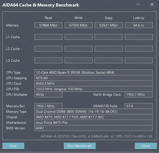

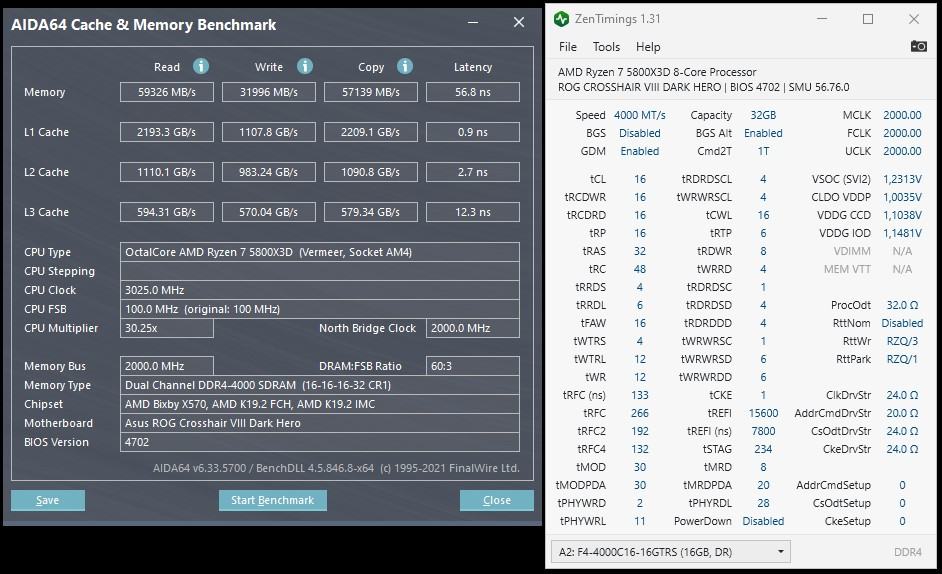

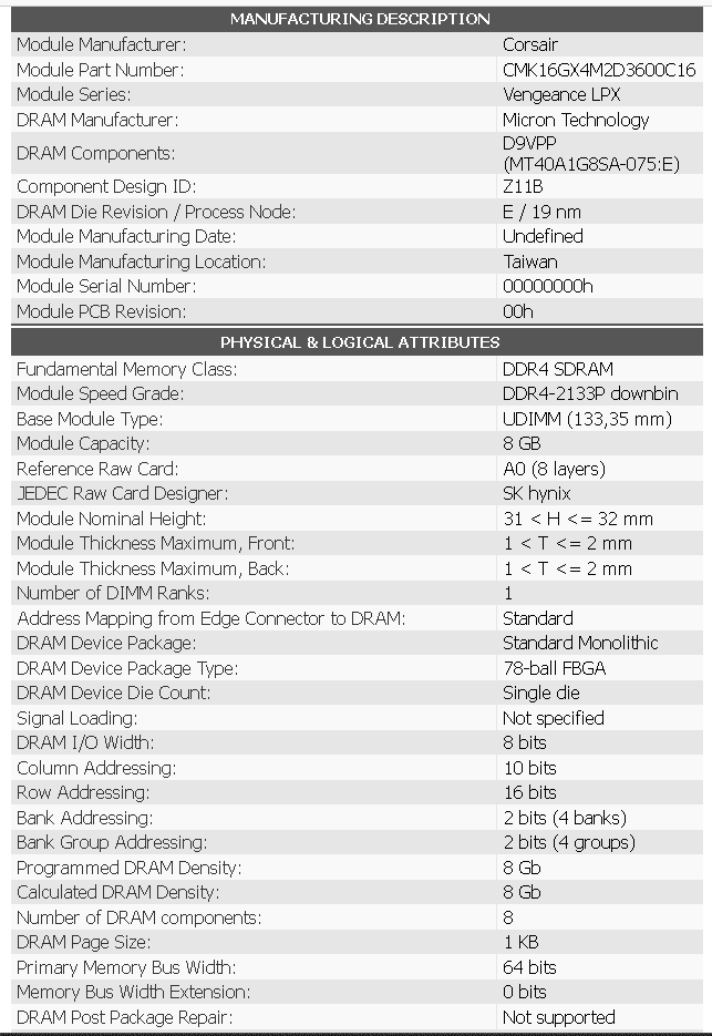

Hi alle, melde mich mit den Werten für mein 4x8 GB Setup zurück und würde mich über Optimierungstipps freuen
Meine Zeit als Schüler in diesem Spitzenthread liegt leider schon ein paar Jahre zurück und allzuviel Zeit ins tweaken will ich nicht nochmal ins investieren.
Viel scheint nicht zu gehen im Vergleich zum 2x8 GB Crucial Ballistix Setup (damals noch mit anderer CPU).
Bereits beim straffen von 3600 MHz gibt es Fehler. Frage mich, ob man da über 3600 MHz hinauskommt?
Das alte 2x8 GB Crucial Setting:
Das aktuelle 4x 8 GB Crucial & Corsair Setting:
Wieso ist der "Write"-Wert so schlecht? War doch immer ähnlich "Read" bisher?

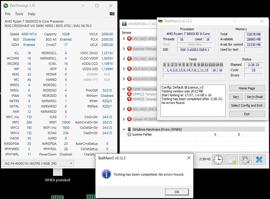

Aber ich sage, der default@1usmus_v3 ist kein scharfer Test!
Jetzt lass ich hinterer mal den extreme1@anta777 laufen und vermute, dass es mir da die Bilanz verhagelt.
@Tatilica But the point is, that default@1usmus_v3 isn't an appropriate test! I'm halfway trough extreme1@anta777 and I already see 4 WHEAs. Yesterday I played CP77 for about 90 min = 7 WHEAs. Same settings.
Maybe the default is ok for RAM-related errors, which it is aiming for. But in my opinion it's not enough for testing WHEAs.
Ist nicht Absolut@anta777 der neue Extreme? Ich hab immer Absolut verwendet, der scheint übrigens beim RAM mehr zu verzeihen als 1usmusv3. der anspruchsvoller war was CAD DrvStr bei 1T GDM off Setup 0-0-0 betrifft.
Interessant zu sehen, dass Extreme mehr WHEA provoziert. Würdest Du auch noch mit Absolut gegentesten? Da ich mit WHEA nicht so andere Kippe bin wie Du, sondern entweder trocken oder gleich ersauf, wäre das spannender in Deinem Setup

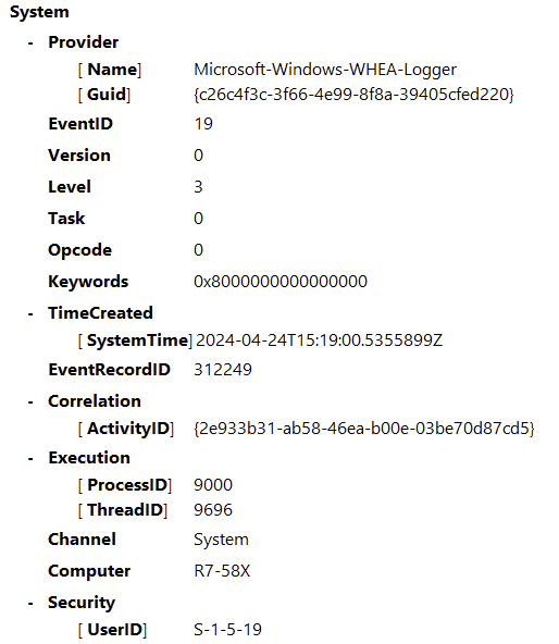

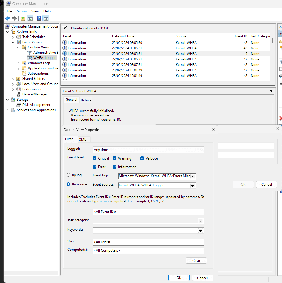

Schaue mal ob du beobachten kannst weswegen du WHEAs bekommst.
Ohne es als instabil zu sehen.
Etwas mehr log daten und die Art des WHEA 19 wäre auch nicht schlecht.
Es gibt verschiedene Arten von dem selben Error log.
Weswegen er erstellt wurde und nicht korrigiert wurde, wissen wir hat nichts mit dem OS zu tun
Aber man könnte nachschauen ob bei dir irgendein Wert hochgeschossen ist
Solltest du bei Win11 sein, lade ich gerne den Powerplan hoch.
Generell war balanced immer zu empfehlen, da custom PP overboost spikes erstellen.
C-State oder DF state wakeup spikes.

Drei unterschiedliche Dinge. #19 ist kein instability error. #18 schon
Ich denke nicht dass die CPU instabil ist.

Da müssen wir nicht weiterreden. Da brauch ich auch keinen weiteren Cycle. Wenn ich jetzt bei diesen hohen Spannungen bei Absolut so ein Durcheinander sehe, dann hat das alles keinen Wert und ich stell mir das beim nächsten Booten wieder auf 1900 um und gut. Und andersrum würde ich mir mit dem Ergebnis vom Default einfach nur selber was vorlügen, wo ich beim CP77 Spielen schon sehe, dass das nicht Bestand hat.
Ich hab mir die Details der WHEAs wie von Veii vorgeschlagen, angesehen. Das sind immer dieselben 19er,
@ApolloX : da sind wir offenbar einer Meinung, was die WHEA 19 Wall bei IF 1900 speziell beim 5800X3D angeht. Ich hab auch nochmal übers Wochenende alles mögliche eingestellt, und es wirft einfach ab 1933 schon Fehler ohne Ende. Ich find das "don´t give up" Mindset hier eh super, nur gibts da offenbar eine unterschiedliche Einschätzung der Erfolgswahrscheinlichkeit. Ich schätze die so bei ~5% ein bei ein paar Monaten Test-Aufwand nebenbei, auf Basis der wenigen mir bekannten Erfolgsmeldungen >1900. Das isses mir nicht mehr wert, und ich denke das ist eine fair gesetzte Erwartungshaltung

Im WHEA-Suppressor thread wurde viel diskutiert was die einzelnen logs den eigentlich bedeuten.

Und nochmal, ich stehe ja auch ganz offen dazu - ich steh bei ~95% vom Erreichbaren, Du bei ~100. Vielleicht ist´s in paar Monaten bei mir entspannter und ich steige nochmal in die Log-Thematik ein, bis dahin verlasse ich mich auf @unifyx und @ApolloX , die mir dann hoffentlich schon in 1-3 Posts sagen können was zu tun ist nach der Versuchsorgie mit Dir
Maybe~
Ich weiß ApolloX kann es besser~
Das arme TM5, soo viele Anschuldigungen und Erwartungen für das kleine Tool für Aufgaben welche garnicht zu ihm gehören.
Der Arme Dev
Nur bitte ladet Daten hoch.
Das hier ... sind keine Daten
Sie sind nicht brauchbar, außer sich zu beschweren dass es nicht läuft
Wir wissen alle schon dass es bei 95+ % der Leute "einfach so" nicht läuft.
Es ist eine traurige Realität aber so wurde die Hardware verteilt.
Doch keiner von uns bewegt sich dorthin sie sich anzuschauen.
Es ist ungenügend mit memtests kommt man nicht weiter
Es gibt zig programme welche diese Auslastung erzwingen können dass sich als Report dann darstellt
Bloß wo sind diese Reports.
Kein ZenPT log wärend der Error kaam bzw vor.
Kein Verbose logging fenster, was es logt wie viele es logt, welche Sensoren aktiv sind. Video ??
Kein Package Throttle test, obwohl das überhaupt nichts mit WHEA zu tun hat (1CCD max write bandwidth test)
Kein CPU stability test, nur low IPC memtests. Wobei auch voltage instability kaum WHEA's auslöst.
Womit soll ich den bitte arbeiten wenn man nur Luft postet.
Das klingt soo harsh, aber es ist traurig zu lesen "es läuft nicht, ich hör auf"
Wenn man sich nicht mal die Mühe macht diese Requests sich anzuschauen welche mehrmalig geschrieben wurden. 😔
Natürlich dass dann nichts rauskommt.
Aus nichts kommt nichts. Es ist kein mem-stability problem, wobei auch das unklar ist
~ wenn man GDM rennt und FCLK nicht von MCLK:UCLKK trennt. Welches auch als Request gebeten wurde.

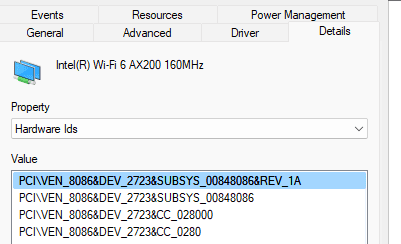

Keiner hat sein NIC überprüft
Keiner (zu 98% sicher) hat sich https://www.overclock.net/threads/w...h-fclk-without-performance-penalties.1778781/ angeschaut
WHEA sind größtenteils Boardfokussiert und CPU Substrate fokussiert. Weg von MCLK und manchmal weg von der CPU ~ WHEA #18 gehört dann den Kernen.
Nicht jeder WHEA #19 ist gleich
Verpeilt ~ busy
Hier bitte:
~angehängt~ , minimal von mir angepasst
Import:
cmd mit admin rechte
cd C:\Users\USERNAME\Downloads\Ryzen_LP1.4 (zum pfad)
powercfg /IMPORT "C:\Users\USERNAME\Downloads\Ryzen_LP1.4\RyzenLP1.4.pow"
win+r control panel
Aktivieren und neustarten ! (Wichtig aufgrund von CPPC)
HWInfo nicht mehr benützen und nur ZenPT + Event Viewer nutzen um logs auszulesen
HWInfo kann eine Race Condition erstellen und somit auch der Grund für Logs sein,
abseits davon dass es nicht alle WHEA's loggt ~ da windows es standartmäßig selbst nicht macht
Wenn man mir dann auch etwas Information über den NIC (Ethernet) gibt, kann man gegenprüfen ob dieser OK ist
Aber ... ich arbeite mit Luft.
Wortwörtlich keine Reports außer Beschwerden dass es nicht läuft~~
Zb:
Ich hab durch d*mmheit und Lernexperimente mein NIC zerschossen.
Das ist das Fenster welches ich brauche ~ neben dem ZenPTMonitor Video bevor und wenn ein Error Spam kommt (mit load, egal welcher Art diese produziert)

194,4 KB
CP2077_5800X3D_4000CL14_GearON_101.75_PBO 100-70-60_CO-PerCore_LCLK DPM off #.png
interessant , das es nicht nur im Intel RAM OC Thread und im OC Forum solche Probleme mit der Person gibt sondern auch hier - und das er die schuld und falsches verhalten immer auf andere schiebt ...
und 0 Einsicht hat obwohl er sich teilweise falsch verhält.
nur er hat recht -> alle anderen haben unrecht ...
@Tatilica there is a chance that you arent at all
But also a chance that it doesnt matter, as critical reports ≠ instability
All the logs for you report zero, even in verbose.
You need to have reports of #42, per active sensor
And report of #5 on successfull initialization of target sensor.
Those appear every successfull boot.
Both are missing here, soo chance is high that its service and group policy is disabled on win 10
On win 11 such is harder, soo i dont think you are on it.
Suppressor was used to prevent dpc spikes due to error spam
At the time the spam was due to NIC issues and chipset issues in general (600errors/sec) without being a performance penalty
Such is not needed anymore and full stability + log free should be targeted.
// NIC FW reflash may not be needed anymore, but i need to verify myself. No trust, but "should" be resolved by now on last 2-3 AGESA and with latest drivers.
Log free doensnt mean clean log. It means no warnings in there.
Vebose logging remains required, to approve sensors are even active.
You may be at 6/10 sensors, may be at 10/10
But currently its unknown because event-viewer service appears disabled. Or log was cleaned
Sensor active log depends on what FW is on the Chip
(microcode + X, patches over to ARM inside chip, on boot if required)
And what settings Boardpartner configured for corresponding bios defaults.
Any case , no logs there means they are disabled on OS level.
Soo please look for a fix.
