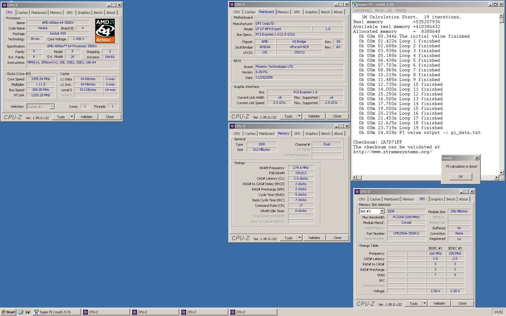

I can do 1M as well:
280 MHz | 2,0-2-2-5 1T | 3,70v | 2x256 MB | Corsair C2 PC3500 v1.1 (Dimm 1 and Dim Copper HS in DC) | BH-5 | NF4 | sparks.nl |
Validation
HWBot
Edit: Indeed this run was easy 😜
