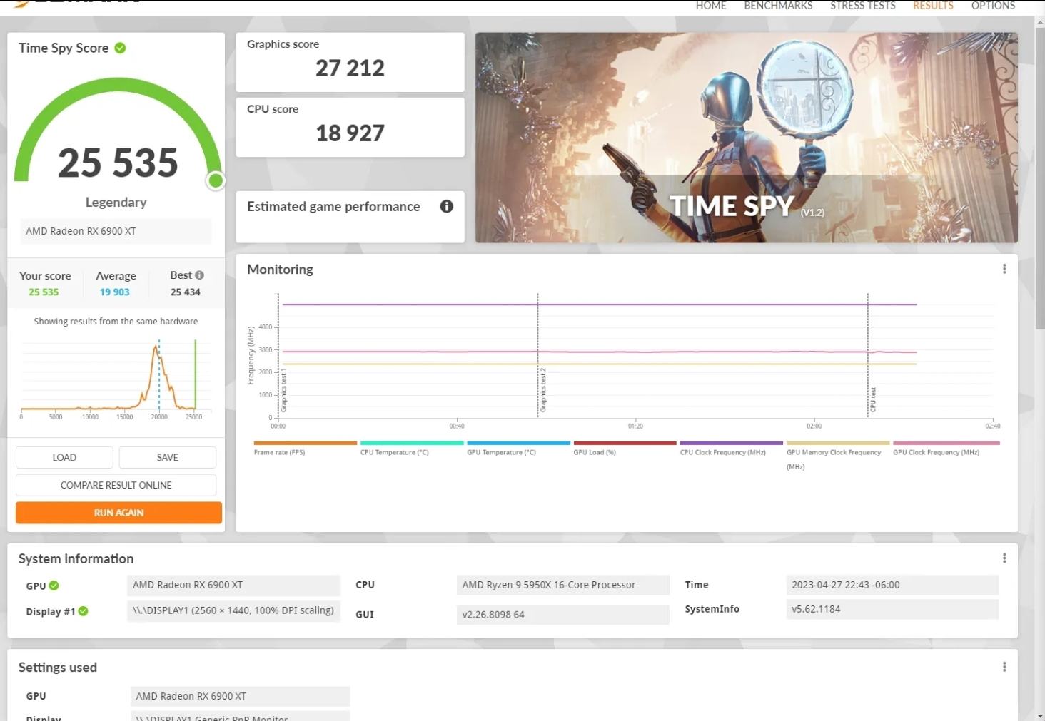

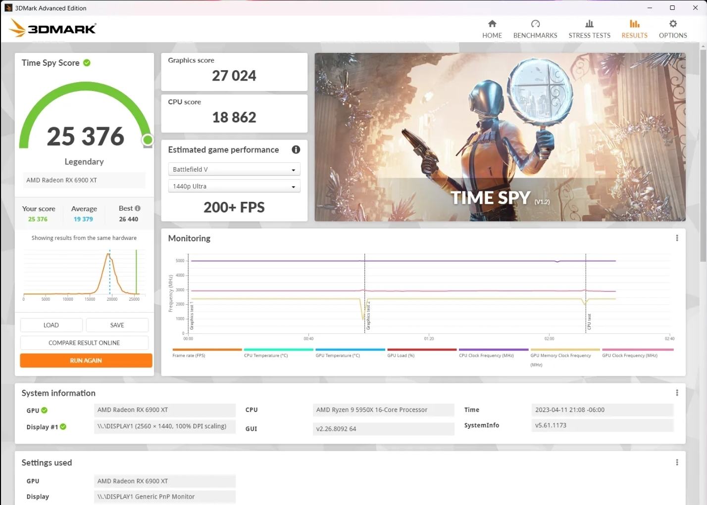

Hello all! I'm new here, but I've been following this page for a bit. I've been trying to learn as much as possible to get the highest scores I can with my 6900xt red devil ultimate.
I've used quite a few of your mpt settings, amd have so far reached a little over 27k gpu scores in timepsy.
I just received my evc2, and I have been struggling to find clear pics of the exact settings I need to adjust in the evc2 here.
If anyone could please help me out, I'd greatly appreciate it!
I will post my mpt settings once I get home from work.

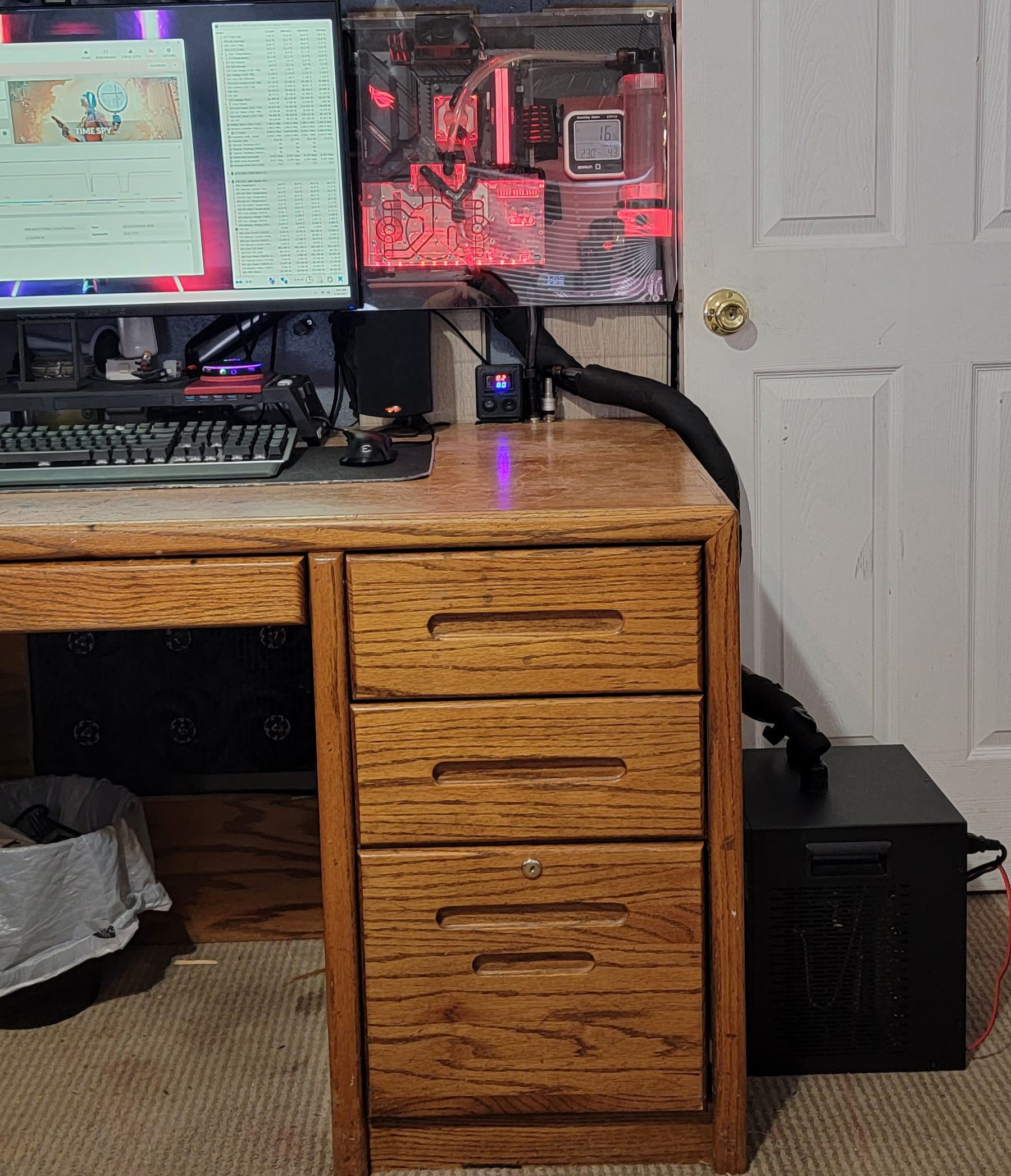

Here are a couple pics of my setup, and scores.
I'm on a 5950x
6900xt
32gb ddr4 3800cl14

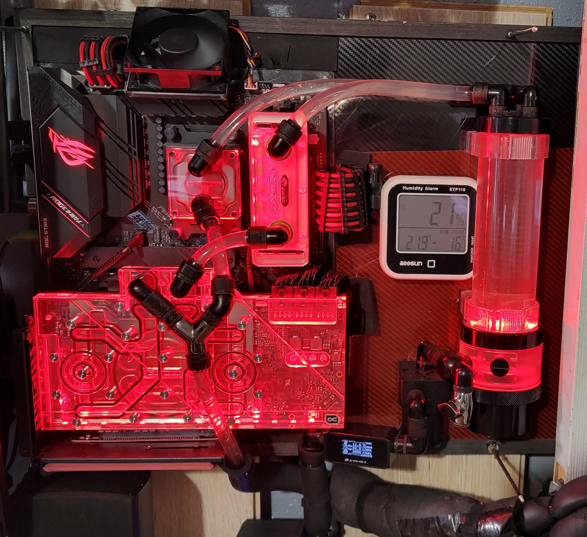

Watercooling, 1/3hp chiller, amd 1260mm external radiator with 18 140mm fans that turn on when the coolant temps get too low, I use this to help avoid condensation.
I also monitor dew point with the meter inside my custom made wall mount case.
6900xt is on liquid metal, and glid thermal pads. Kpx thermal paste is on the cpu.
Awesome stuff mate! That's pretty much where I am with my chiller....I need more.....im slowly but surely working my way to sub zero territory....gonna go the modded aircon glycol chiller and chill box first.....then after that stops fuelling my fire it will be board insulation/dry ice/ln2 😃
I've done the sub zero stuff before. Having the mobo, and gpu completely waterproof. But it was ugly. I sold that old chiller setup u had with that waterproof combo. I regret that now. This 1/3hp chiller isn't strong enough unfortunately. I'm looking to get into a 1/2hp or 1hp version. But at 1000usd+ . I'll have to save a bit to get.
I'm hoping to get into the mid 27k gpu scores or higher, but I want a good base to start off at with the evc2.

I was able to break past 270xx, and got 272xx gpu scores. I still haven't installed my evc2 yet. I hoping someone can either pm me with starting settings for the evc2, or send me pics of their settings? Thank you!

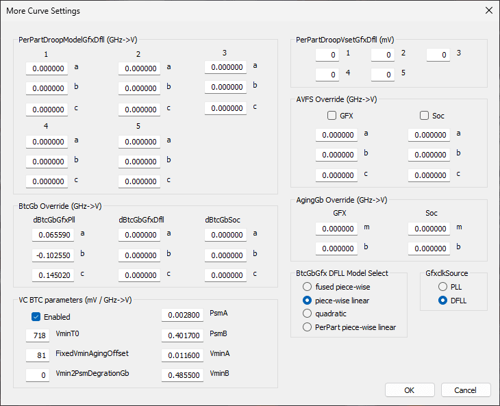

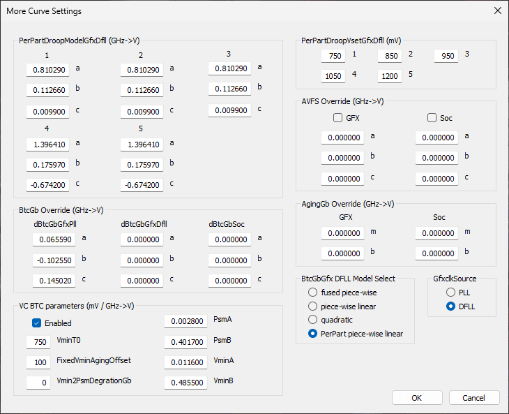

Frage an 6900 XTXH-Eigner ohne Fremd-BIOS: Ist More Curve Settings ("More"-Tab) genauso leer wie bei meiner 6900 XT Ref und ist "piece-wise linear" markiert?
Oder sieht es eher aus wie bei der 6900 XT LC oder einer 6x50 XT, mit aktiviertem "PerPart piece-wise linear"?
Wer eine Radeon-6000 weder mit LC- noch mit 6x50-BIOS hat, keine XTXH und trotzdem ein "gefülltes" More Curve-Settings-Fenster, möge bitte ebenfalls kurz Meldung machen.
Ist für einen Artikel "Inside MorePowerTool und MoreClockTool". Danke im Voraus! :wink:
