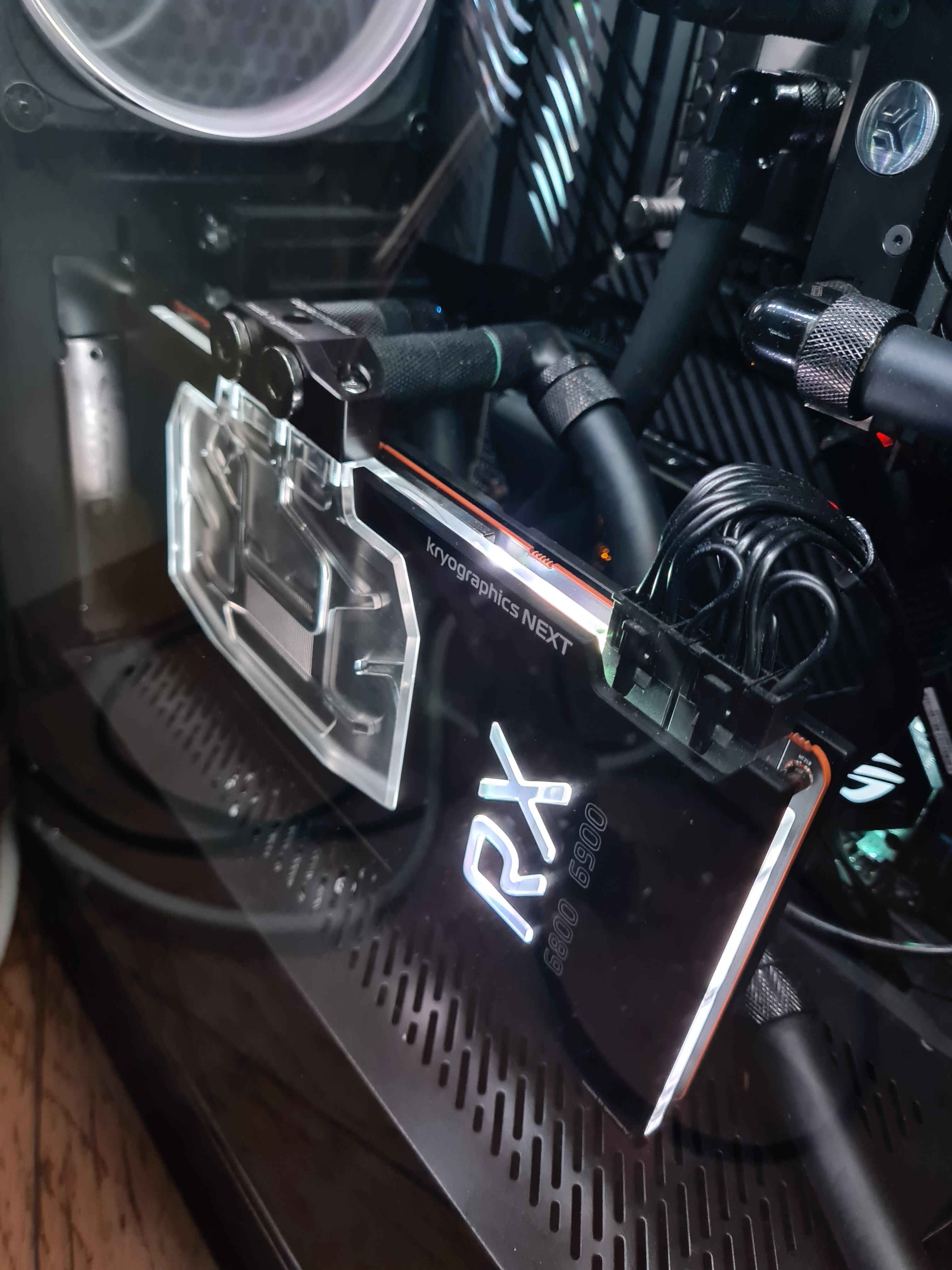

how You cool Your card? can You show some photo ?
Ehm with a waterblock?
Aquacomputer + backplate with pads.
2xMoRa 360
can You put some fan/fans on backplate ?
Yeah one fan should work

Dont make a sense. 79 Hotspot/ 47 core...
Maybe the ac dont fit perfekt. Should try another Block.
