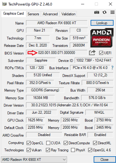

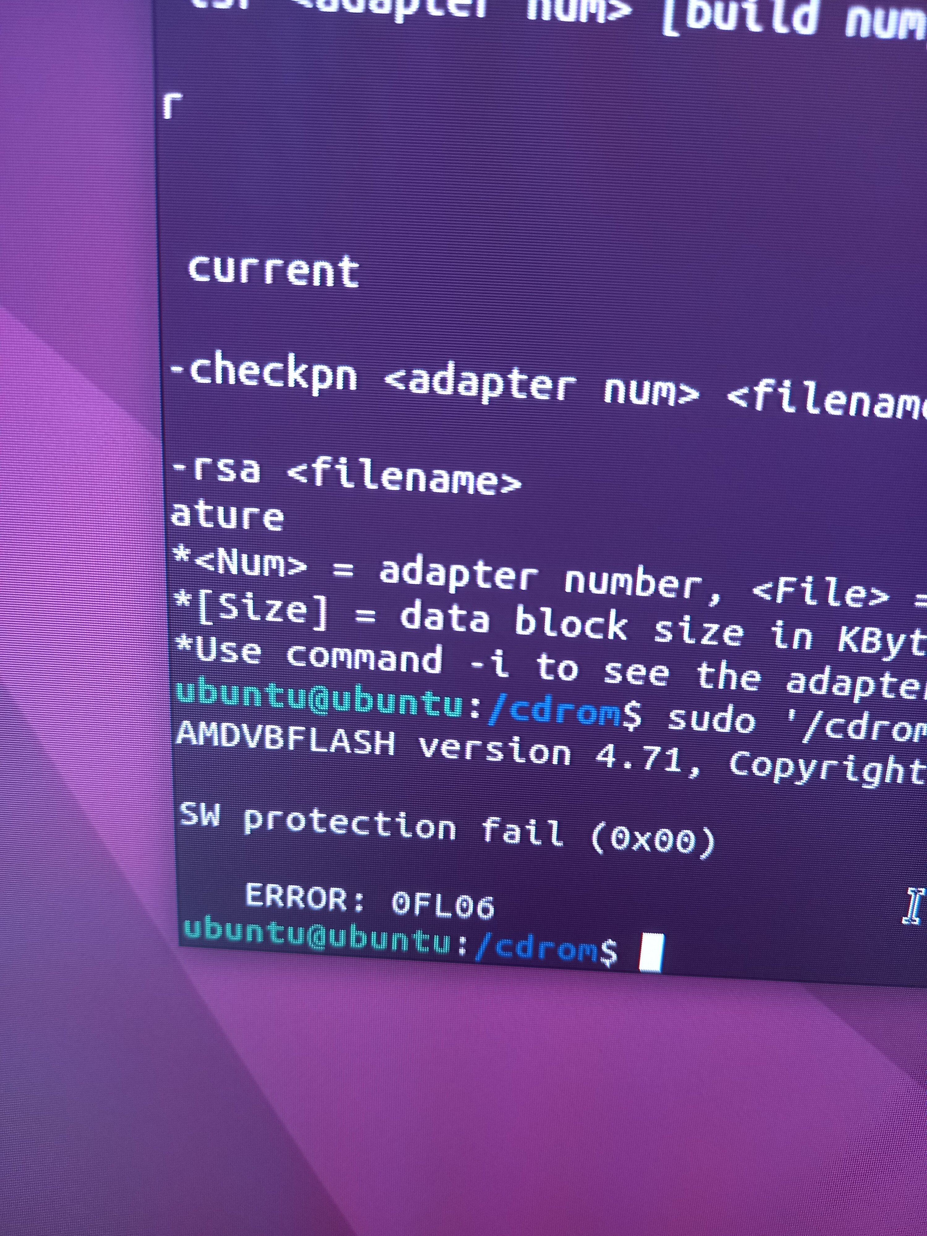

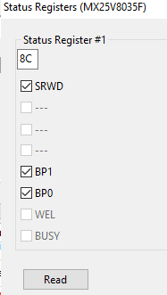

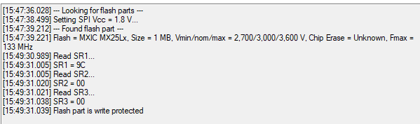

All very good information..thank you...hmmm ok you say you don't really know about the spi way....I would actually be a guinea pig now if I just decided to pull the card and give it a go? It may work? 😆😆😆 what's the worse that could happen? 😆😆😆😆😆😆 or! You are saying that now it is locked...external has no chance?
I don't know the scenario of "SPI fixing SMU/SME lock"
SPI will force "Flash-ROM" to be in full accessible state, and for example software for CH341 can put "expected protection" back
But current EVC could only read and remove WP
While current CH341 Neoprogrammer, (v2.2.0.10) can only do
Up to 8C but not 9C like it's expecting
Soo if Card has removedWP, soo 0x00
Turns to 0x40 once receiving power
But SME expects 0x9C - it will refuse to run full initialization and update // even if bios is fully compatible
Yet,
If the same thing happens on same firmware, same vbios and same memory training strap
It will just lock it down again to 9C, verify firmware, bootup and everything is fine ~ but you accomplished nothing
The problem,
Replacing the brain , without the body expecting a change, only works if the replacement is compatible and doesn't force an internal update
If you updated tho, and it expects a change it doesn't get ~ of course it won't boot up with then new "different" firmware :
It maybe fixes itself, as you will force remove write protect ~ before even being able to flash
But it also may as well do nothing, when initialization refuses
From my side, it makes more sense to protect you from such event vs having to dual GPU flash unlock and flash it back ~ when the card hangs in an init loop
^ which people at elmorslabs had ~ hence i'm aware of the resolve, but not about the "SPI will fix everything" topic. It can not fix everything as ROM is not fully used.
Not much different on Navi10/11
Not much different on RTX 2000/3000/4000
The worst would be, having to solder wires and prevent the rom from being locked ~ then still do vbflash recovery (IF you mess up)
Option given before, was how to be aware of what happens (or has happened) while being in a functional state. To prevent non init boot-loop :)
Soldering is option #3,
You can do whatever you please, but a warning has been given
It was bothersome to recover and i've sit through it.
I wouldn't like to solder much on a potentially given back card, as the state of vbflash is not unlocked. You can put yourself in a situation having to RMA the card.
I know this, as if you check the #support thread in ElmorLabs discord ~ i've been assisting the 3rd person that tries to recover from an rebrand or generally stupid attempted idea.
Soo my recommendation stays,
Try to follow the instructions given, or "yolo" it and it might even resolve // we might learn something new
First before doing anything ~ confirm current state of the GPU , if locked or not
As again, using 3.31 or 4.71 vbflash "with a successful operation" ~ will indeed lock it down. That's the certainty i can give you. And a certainty how you recover from this.
The rest ~ your expected methods ~ misses data.
Ok thank you! I will get back to you on the status when I get a chance to run the check lock command!!

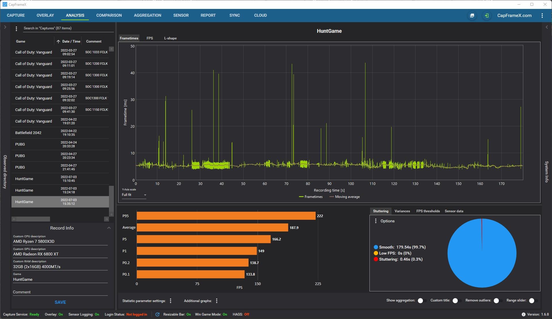

Danke für die Rückmeldungen. Ich bin davon ausgegangen, dass dies ein allgemeiner Radeon Thread ist und nicht nur für's OC/UV. Man möge mir verzeihen.😉
Ich hatte zum Release eine 6800XT und war mit der Leistung in Hunt Showdown zufrieden. (110-125 fps) Aufgrund einer Pause habe ich damals die GPU verkauft. Es geht mir nicht darum, das letzte Maximum aus meinem System herauszuholen.
Eigentlich wollte ich mir irgendeine leise 6800xt holen. Dabei ist mir aufgefallen, dass die 6900xt zum Teil deutlich unter UVP verkauft werden. Deswegen komme ich zu meiner eigentlichen Frage, ob die 6900xt (aktuell) "viel" mehr Leistung in wqhd gibt, als eine 6800xt. Auf alte Tests möchte ich mich dank verbesserter Treiber nicht verlassen.

So I didn't force flash my card...I merely tried it with 4.71 and got the mismatch...so it never did any bios flash....in my photo...it shows 0x00...is that how it should look when I enter the check lock command? If that's the case I haven't locked my rom yet?

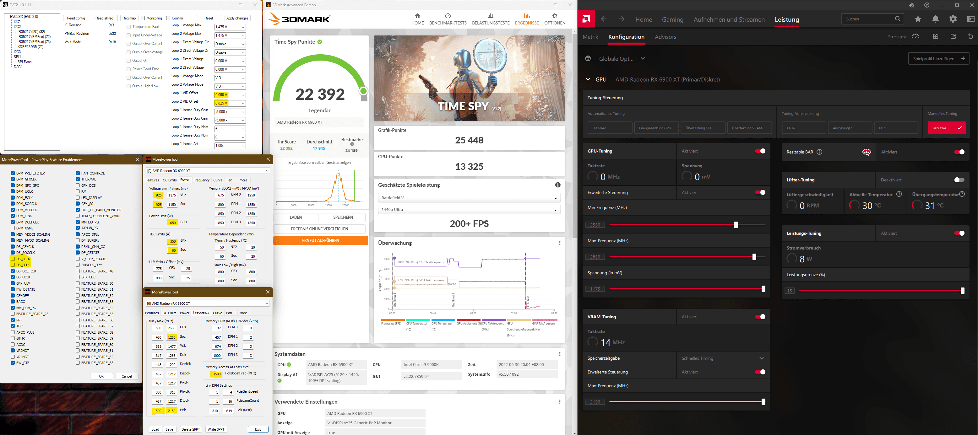

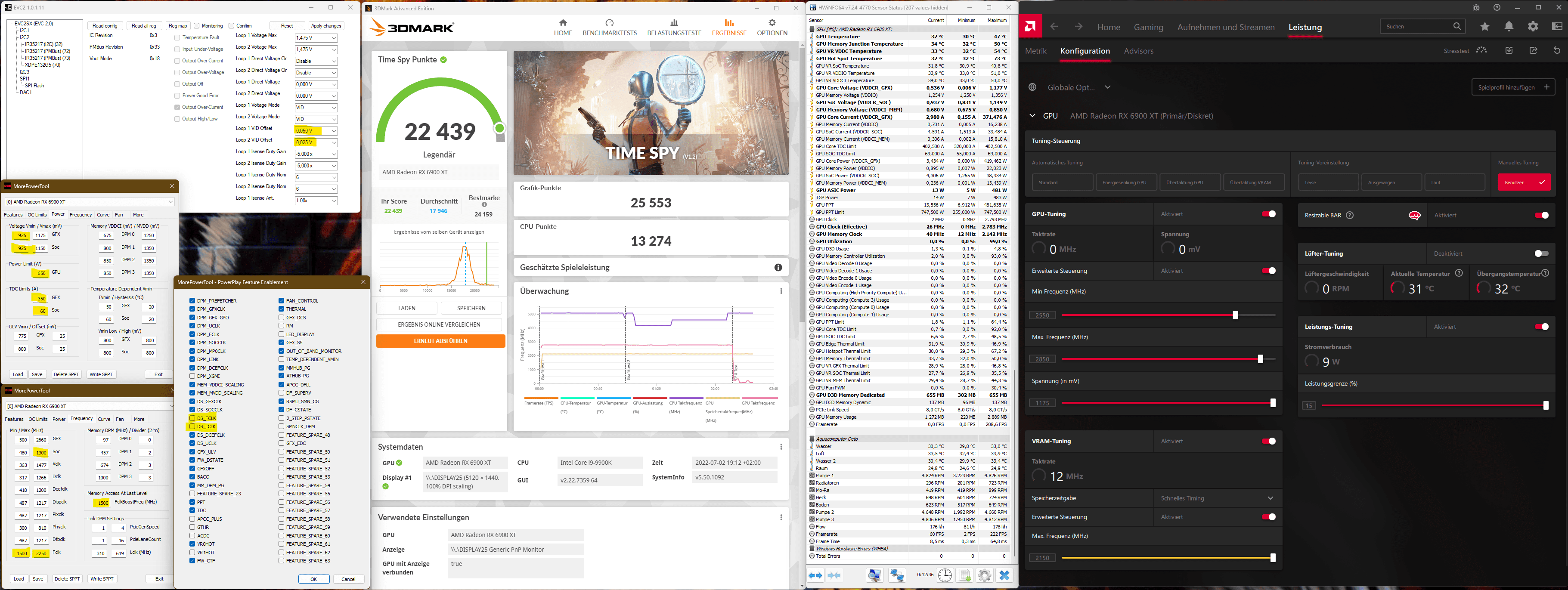

Anlässlich 22.6.1 noch mal was zu Treibervergleichen. Hier hatte ich ja schon ein Spiele-Roundup interner Benchmarks gepostet, 22.5.1/2 vs. 21.11.3.
Von den zwei DX11-Spielen, die hier im Einsatz sind, startete das gemoddete GTA V unter dem "Wundertreiber" nicht mit meinen OC-Einstellungen. Das hat sich nun geändert, entweder weil AMD in 22.6.1 gegenüber 22.5.2 was verbessert hat oder weil der Einsatz einer kleinen Mod (PackfileLimitAdjuster, :wink: @19Phil88) geholfen hat. Ergebnis: GTA V performt mit 22.6.1 besser als mit 21.11.3, 64 zu 60 FPS im Benchmark.
Das zweite DX11-Game, Dirt 3, zeigt immer noch Bildfehler (zu dunkle Farben) mit dem neuen Treiber. Weil das hier beinahe täglich gezockt wird, ist das ein Ausschlusskriterium für 22.6.1. Den kann ich also ebenso wie seinen Vorgänger in die Tonne treten.
In den Spieletests blieb Time Spy außen vor. Das habe ich nun nachgeholt und bestätige, was hier angedeutet wurde: 21.11.3 ist in Time Spy besser als die Mai- und Junitreiber 22, eindeutig und reproduzierbar. Für Bencher, die gern die letzten zwei-, dreihundert Punkte rausholen möchten, kann das einen Versuch wert sein. Ein paar Best-Runs von heute mit beiden Treibern (daily Gamesettings):
22.6.121.11.3
25141
25520
25217
25574
Settings
Das ist übrigens nichts Neues; @Devcom hat den TS-Vorteil des alten gegenüber den neuen Treibern schon vor Wochen mal erwähnt. Bedeutet nicht unbedingt, dass 21.11.3 jetzt der TS-Treiber ist; 21.10.2/3/4 z. B. könnten genauso stark sein. Und dann gibt es ja noch den guten alten 21.8.2, der einiges mit sich machen lässt.
Eine weitere Bemerkung: In den letzten Wochen mit den Mai-Treibern ist es mir erstmals passiert, dass der Screen nach restart64.exe häufig schwarz blieb, so wie es von anderen Usern schon berichtet wurde. Das Phänomen ist mittlerweile, nach ein paar Windows-Updates* und Treibertauschs (immer mit DDU) verschwunden. Ich kann die erweiterte H-Methode wieder machen, wie ich lustig bin, sie klappt immer.
Erwähnt wird dies als Anreiz für diejenigen, die damit Probleme hatten, es ruhig mal wieder zu versuchen. Solche Probleme müssen nicht für die Ewigkeit sein. Die Automatisierung, die hier fast ausschließlich verwendet wird, ist nun leicht entschärft mit 10 statt 8 sec. Pause zwischen den Restarts, damit der Treiber länger Zeit hat, sich "zu sammeln". Dafür wird das Bestätigungsfenster zum Abschluss bereits nach 5 sec. "gekillt". Details, nur der Vollständigkeit halber.
*Windows 11-Version ist 22H2 Build 22621.169 (Insider Release-Preview-Kanal).

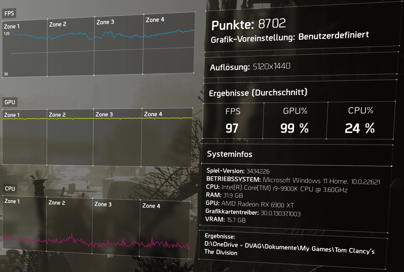

Das war die Reaktion auf meinen Hinweis, dass der 9900K @5,1 GHz allcore in Time Spy GT2 nicht mal vollständig hochtaktet, weil er es offenbar nicht muss.
Vertiefen wir das mal. Wenn die CPU in GT2 nicht ihren vollen Boost-Takt rausholen muss, kann ein vermeintlicher Flaschenhals eigentlich nur in GT1 liegen. Also hab ich dort ein CPU-Limit von der ersten bis zur letzten Sekunde erzeugt, mit einem Lauf in der internen TS-Auflösung 1280x768. Die niedrigsten CPU-FPS liegen mit 180 zu Beginn der dritten Szene an. In meinen Tests mit dem anspruchsvollen 2850-MHz-Setting schafft die GPU an dieser Stelle 150. Näher kommen sich die beiden FPS-Werte nirgends. Und am Ende von GT1, wo die Top-3-Karten in ihren High-Score-Runs 240 FPS liefern?

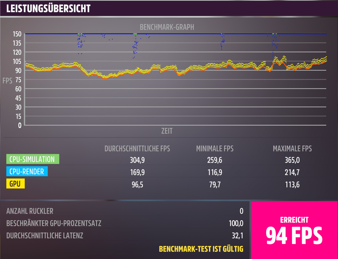

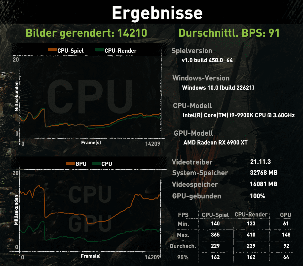

Nun ging es aber gar nicht um Time Spy und 180, 240 oder 520 FPS. In den Treibertests, auf die du, Holzmann, dich beziehst, werden weniger als 120 FPS erzeugt, weil das die Max-Hertz meines Monitors sind und ich die Grafiksettings der Spiele darauf einstelle, darunter zu bleiben. Die Auflösung von 5120x1440 px (das ist nahe an 4K) sorgt für maximale Grafikarten-Auslastung. Gibt es die geringsten Zweifel daran, dass der 9900K in meinem Games-Roundup jederzeit 120 FPS liefern kann?
Freundlicherweise geben einige Spielehersteller in ihren Benchmarks Hinweise darauf. Frisch aus der Küche:

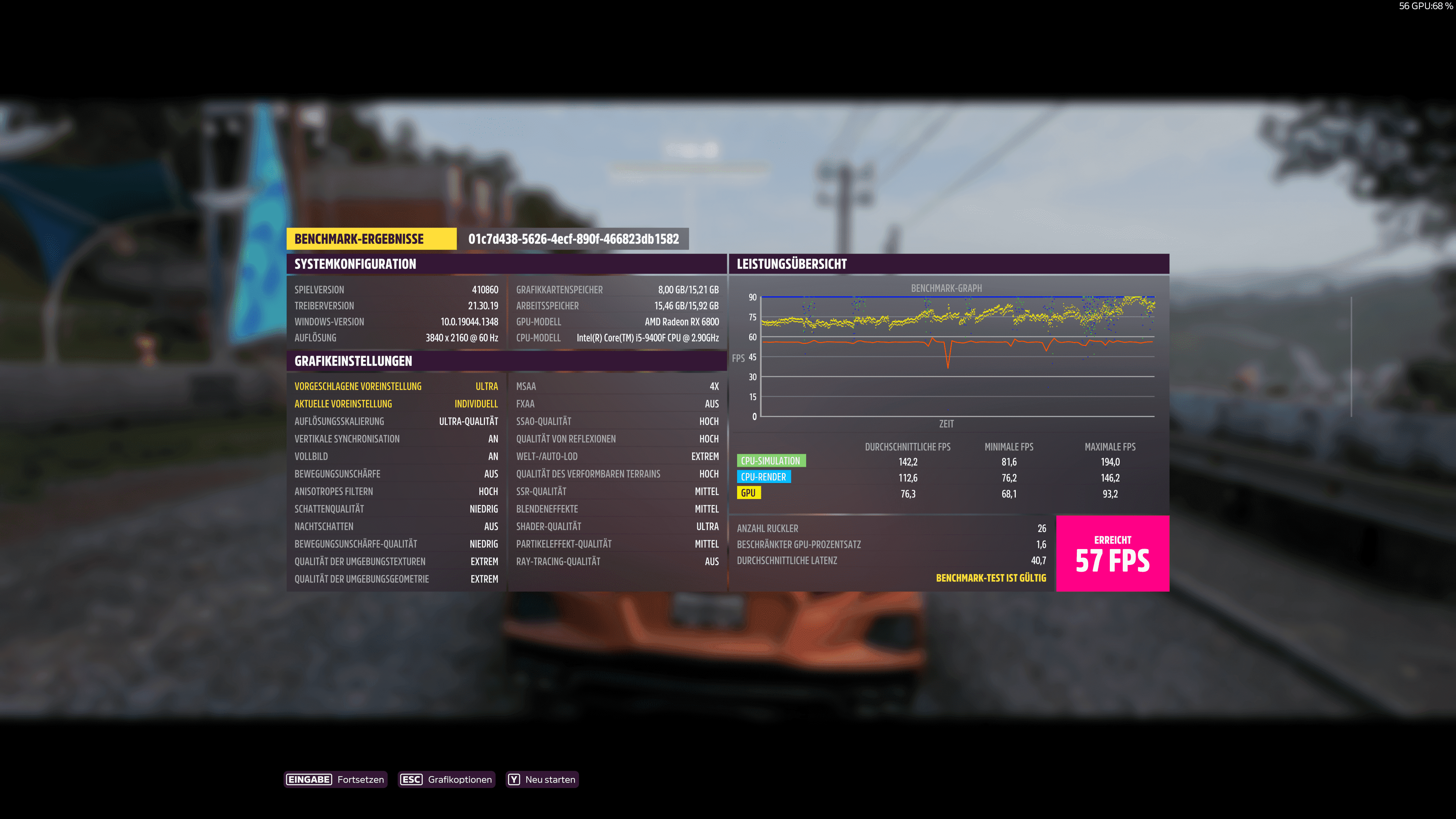

Shadow of the Tomb RaiderThe Division 2Forza Horizon 5 (sogar mit Punktewolke :love:)
Zum Vergleich mal der FH5-Benchmark mit @GerryBs System: So sieht ein partielles CPU-Limit aus. Die blauen CPU-Punkte fallen an einigen Stellen tief in die gelben GPU-Punkte. Erhellend sind auch die Werte bei Ruckler, GPU-Beschränkung und Latenz. Das ist alles CPU/RAM.
Quelle

Ankommen werden am Ende bei dir IMMER exakt die niedrigstmöglichen FPS, nämlich die 110 der GPU.

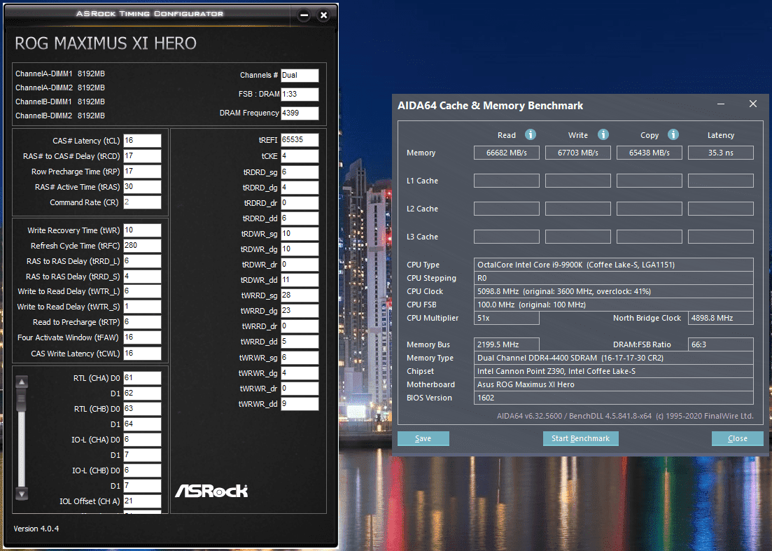

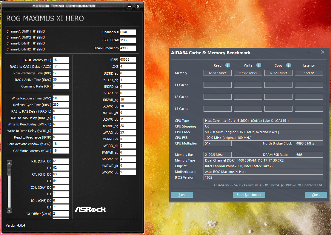

Den CPU-Vergleich habe ich Anfang letzten Jahres übrigens selbst durchgeführt, 8600K vs. 9900K, wenn auch noch mit schwächerer Grafikkarte und entsprechend niedrigeren FPS. Unterschied: gleich Null, weil GPU-Limit.
Übertragen auf 9900K vs. 12900K: Deine topaktuelle CPU wird am Ende von Time Spy GT1 sicher mehr als 520 FPS liefern. Aber was ändert das an den limitierenden 240 GPU-FPS? Richtig, nichts.
Und weil im zitierten Beitrag auch der RAM angesprochen wird:
Kaufst du dir aktuell DDR5, hängst du in Bezug auf Latenzen dem ordentlichen aktuellen DDR4 noch hinterher und büßt so an manchen Stellen auch mal ein paar FPS ein. Beim Verhältnis Durchsatz/Latenz ist es aktuell noch so, dass du massig Aufpreis für letztlich nur sehr wenig Leistungsunterschied zahlst und alles zusammen wird nur relevant, wenn du dich mal im CPU-Limit befindest, was in 4K eher selten sein wird.
Die RAM-Performance (8600K vs. 9900K) habe ich seinerzeit ebenfalls verglichen, sogar mit identischen CPU-Taktraten. Ergebnis: nur minimaler Vorteil für den 9900K.
Quelle
Das war der maximal geschärfte DDR4-3200@4400 CL16, wie er heute noch fast genauso hier läuft. Der Durchsatz ist mit hoch taktendem DDR5-Speicher sicher noch deutlich besser. Aber schau dir die wichtigen Latenzen an. Was schafft dein superfancy Trident Z5 RGB DDR5-6600@6800 CL32 da gleich? Zeig doch mal die Latency laut AIDA64. Die effektiven Zeiten habe ich für deinen und meinen RAM schon mal ausgerechnet: 7,3 ns hier, 9,4 bei dir. Dabei sind die Unterschiede bei sekundären und tertiären Timings nicht mal berücksichtigt; verwendet wurde einfach die Formel

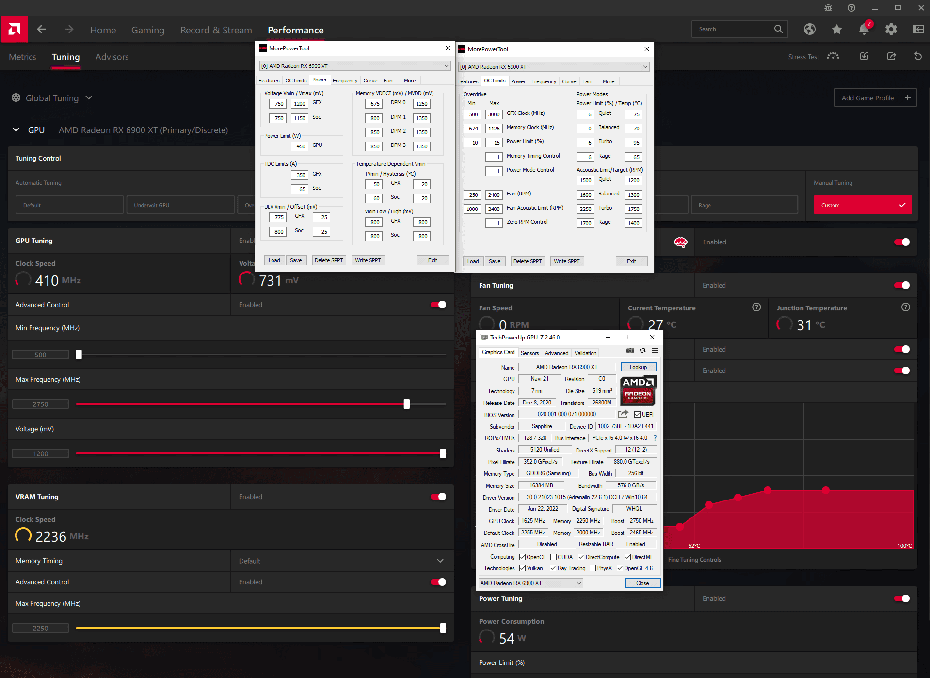

Dieser Treiber wurde gerade von AMD Software heruntergeladen
Dann brauch ich ihn ja nicht zu installieren. Oder tritt die Besonderheit nur mit diesem Treiber auf?

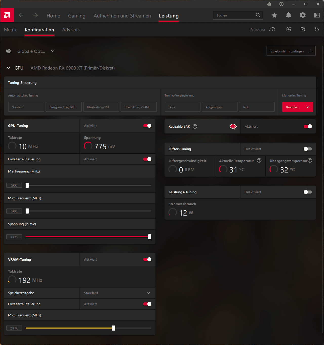

Schreib mal bitte, was ich tun muss, um mit der 6900 XT Reference 2250 MHz VRAM-Takt einstellen zu können. :)
Rübergeholt vom UV-Thread:
Ich bin mir nicht sicher, ich habe das gerade heruntergeladen und den maximalen VRAM-Takt und die Kernspannung geändert. Wenn es also gleich ist, sollten Sie einfach den maximalen VRAM-Takt in mpt erhöhen können, und es wird funktionieren
Nein, geht nicht, jedenfalls nicht per MPT. Erhöhe ich dort das VRAM-Limit und dann den Takt im Treiber über 2150, geschieht das Erwartete: Fail Safe mit 500 MHz max GPU-Takt.

Mag sich mal jemand dazu äußern, der sich mit BIOSen auskennt?
Kann mal Jemand mit DualBios das komische Bios von Garlic draufflashen?
(siehe Post#641 im UV-Thread)
Solange man net dasselbe Bios auf dem ROM hat, ist das Ganze schlecht nachvollziehbar.
(weil die Nr. eigentlich eher zu ner KXTX passt)
btw.
Bei Flashversuchen mit 6950-Bios gabs meist Probleme mit SAM/rBar.
(müsste man evtl. OFF lassen auf dem Motherboard. ... erstaunlich das rBar bei Garlic funzt)
Mag mal jemand sich dazu äußern, der sich mit BIOSen auskennt?
Vielleicht ist das Bios meiner GPU etwas anders? Vielleicht kann das ein anderer TOXIC-Besitzer ausprobieren?
Ich kann auch mein MPT-Profil senden, wenn ich nach Hause komme, wenn ihr wollt.:unsure:
