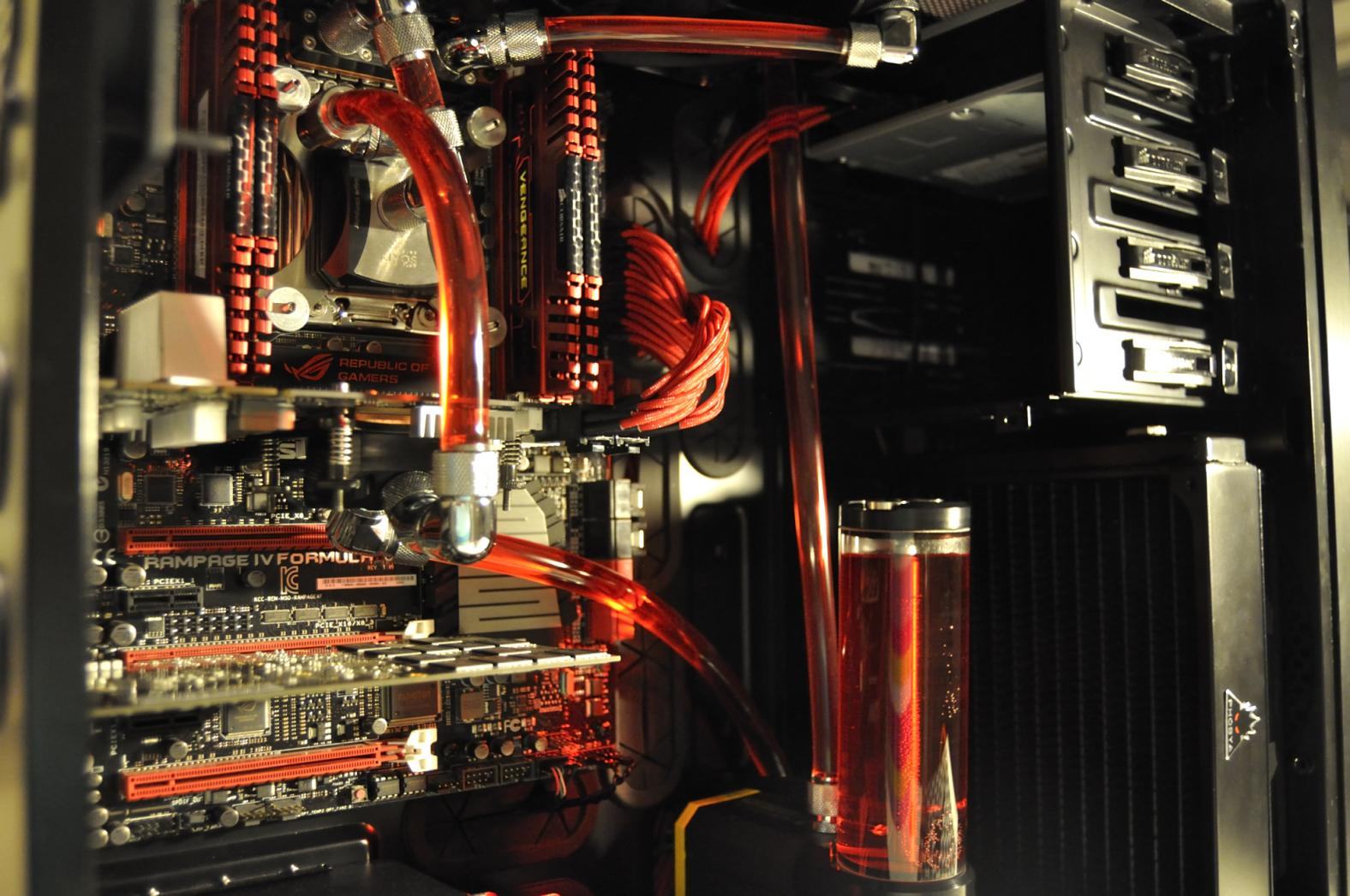

Components in loop (also see attached pictures, albeit before installation of flowsensor):

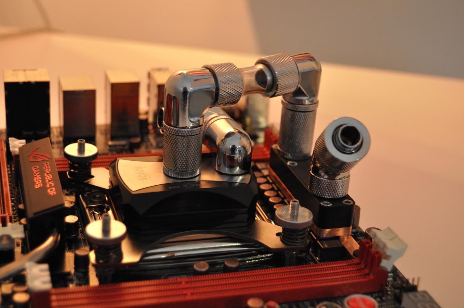

i7 3820 on Rampage IV Formula MB with Aquacomputer Kryos Delrin CPU block and Anfi-tec PWM block
GTX 670 with Alphacool HF 14 GPU cooler (and passive Vreg+ramsinks)
Aquastream XT ultra pump with aquainlet PRO 150 ml reservoir
Phobya Xtreme 200 - V.2 - Full Copper radiator (front) with Phobya G-Silent 18 700rpm Red LED fan
Alphacool NexXxoS XT45 Full Copper 280mm radiator (top) with 2x Noiseblocker BlackSilentPRO PK-2 fans
Aquacomputer Durchflusssensor "high flow"
Tubing: Tygon 2375 13/10
Fittings from Alphacool (some 45's and 90's angles)
Homemade red coolant (I am a chemist):
Benzotriazol (cas # 95-14-7): 1 g/L
Amaranth dye (cas # 915-67-3): 1 g/L
Deionised water
Algaecidic Cu-ions...well they come from the components...right?
The coolant has worked perfect for months. If you see algae or any precipitation in that, call me...

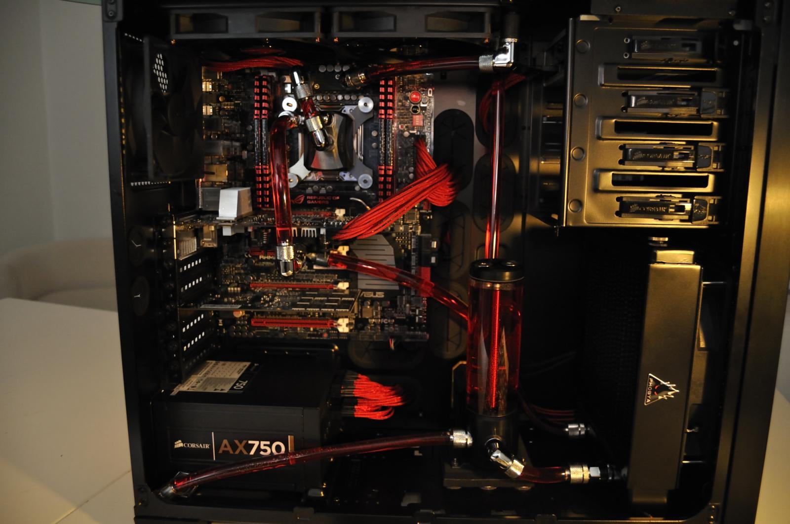

Fans on rads are all blowing into case through Demciflex filters (positive pressure). Fan (120 mm) at back is blowing out.
All in Corsair 650D case, see pictures.
Performance (fans+pump at max):
For ambient = 25C: water delta T = approx. 14-15C. So the water hits 40C.
CPU: Approx. 57C, GPU: Approx. 55C
Flowrate: 142 L/h

The first picture is a bid dark to be sure, but, is the top radiators air provided by the (warm) exhaust of the bottoms radiator?
The surface should be fine for your components, i have round bout the same delta, with a 360 only. (which is similiar to a 280) . Id recommend to check if theres any Air in the loop and if you can provide more fresh air to both radiators. This will lower your temp most. Mount the fans that they will pull fresh air from the outside into the radiator.
GPU temp is a bid high, i guess its the block too. Usually you should have lower deltas to water with small gpus ;)
Regards
Good point Vonali regarding airflow. Rule for this: all air into PC through the radiators or all air out of the case through the radiators.

thanks GliderHR. i do have fresh air coming through both radiators from the outside.
Doesnt look like it! Exact the opposite. Mount the Top Fans on the case, then the radiator. Your fans direction is from the inside to the outside with warm air from the bottom rad. Thats why the top radiator is kinda useless.
vonali, nope, the top fans are pulling air in from the outside not pushing, through the top radiator.

Could you change the Radiators and Fans Position? So they are taking fresh air straight from the outside and not inhibited from the radiator? I would try this first....
