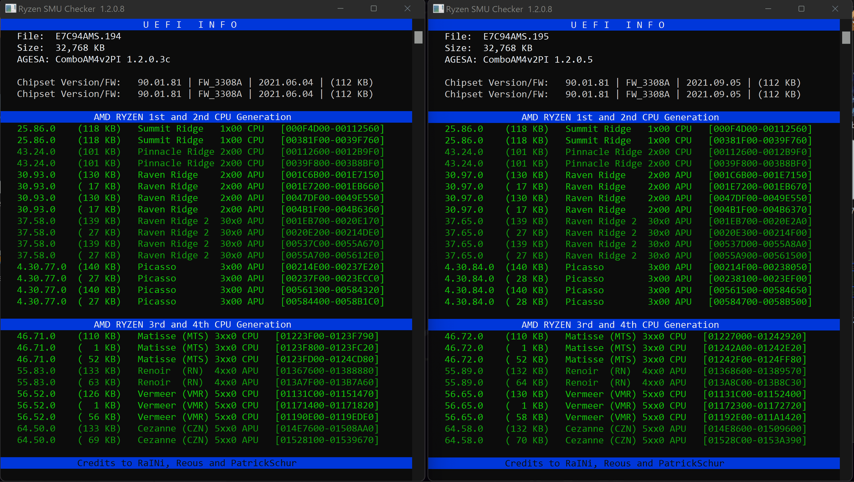

Hier sind alle Files enthalten, habse auch runtergeladen.
Owner hat es für das unify X schon drauf, gibt ein paar nette Änderungen.
Vddg für jedes ccd einstellbar z.B. oder ein negativen Offset auf max Boost beim Boost override (-1000mhz)

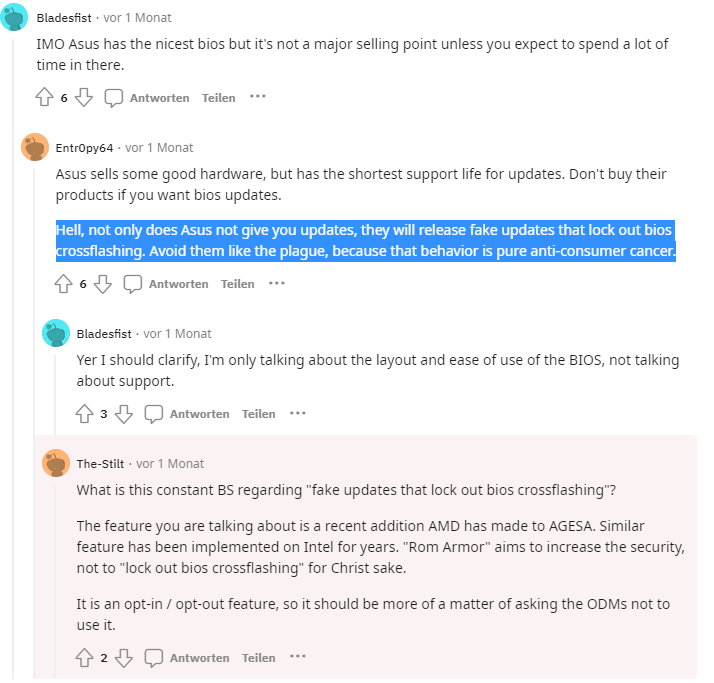

If security vulnerabilities would be fixed ~ in this case "SMU RACE" then it also introduced ROM ARMOR
I can not out of clear mind say, downgrade back would be possible after the flash / up to how gigabyte implemented default flags
But it' s a good step forward for security ~ up to on which side you stay
* ASRock allowed downgrade on the introduction of SPI ARMOR ✅, ASUS did not on boards without ext-flashback ❌
Sadly this side missunderstood
Some people think having unrestricted writes to SPI flash is OK:
As demand to allowing targets via userspace to excecute and rewrite ROM
While the target was not OS userspace, but also not being restricted fully without ability to unlock and with NDA requirement to even get the information for self repair or modification
Slight difference of viewpoints, but hard to title correct judgement ~ when there was no attempt of talkpoint. Easy to blame people over the net :)
Anyway ~ keep in mind this might lock SetupVar access, might lock downgrading ability (up to vendor) and can render crossflashed boards as soft-bricks by the nature of it.
Not that it was introduced with malicious attempts as here quoted
But in the sense, that it very likely ~ can cause you modification "complications", away from any Vendors intentions
I do think that changelogs should state the introduction of SPI ARMOR, when "the cat has already left bag."
The only part i'm personally not happy with,
Is being "read only" after post ~ by Vendors supplying (AMD) decision, without the ability to rewrite it (in case you need to update/downgrade) & in such case "service" boards
And the 2nd sideeffect that ROM-Armor toggle is wiped from SB as option. Soo it indeed falls under "enforcement" and not "choice" as Mr. Pikhur states
It's not a choice we get ~ which is why i understand the reddit guy, but he phrased it wrongly (likely)
Corresponding Vendors are to blame, not the feature itself.
But the feature by AMD is used not as a "choice" option ~ and then "shut-up" the information about it, even when it's "supposed to be no security risk anymore"
I understand where The Stilt is coming from and we could talk nicely ~ but i don't think i can agree with both points. Neither the reddit guy, nor The Stilt's response on this thread
Comparing an issue for intel boards which can require user to go as far as short pins to follow an undocumented mode ~ "just to gain the ability to downgrade or service"
Vs actually having a choice to select it ~ as Mr. Pikhur & the SentinelOne Team probably had as intention.
There is a difference of enforcement here. Soo reddit user titling it "malicious" has some ground ~ but it's not "the feature/fix" that is the problem here.
It's the Vendors implementation and followups by it without being made aware, nor have the ability to talk about it or get a choice to toggle it
Very easy taken out of context 🤭

MSI Rolls Out AMD AGESA 1.2.0.5 BETA BIOS Firmware To X570 & B550 Motherboards
What's new:
1. Update to COMBOAM4v2PI 1.2.0.5
2. SMU firmware updated for AMD Vermeer, Cezanne, Picasso, Raven Ridge
3. TPM enabled by default
Bin auf erste Erfahrungen gespannt obs stabiler läuft wie 1.2.0.4 A und wann da mal von Gigabyte was kommt.
