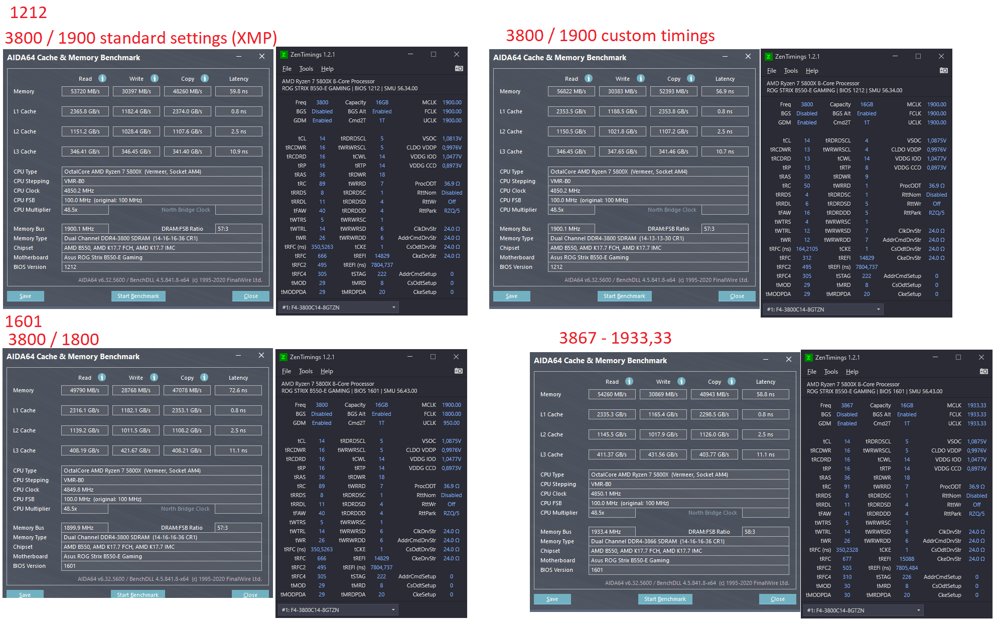

Hi! I hope english here are okay.
MB: B550-E Gaming
Ram: G.Skrill 3800 CL14.
CPU: Ryzen 5800x
With bios 1401, 1601 i can't boot if i set my ram to 3800 and FCLK 1900. The MB are showing error code 07 when it is trying to boot.
I have only activated the XMP profile + FCLK nothing else.
The ram timings rn. with FCLK on auto it can boot, but not at 1900
If i put beta bios 1212 on i can run without any errors with FCLK 1900 / 3800
Do your guys have any suggestion i can try before i flashback to 1212?
What you can try:
- Boot first with 3600 and then change to 3800
- Is 4000/2000 with CL16 booting?
Do you have any old picture with 1212 bios to compare the voltages and ProdODT value with 1601 bios?

Okay i will try that.
4000/2000 can boot but i am getting BUS/interconnect errors
I do not have any SS of 1212 but i can maybe flashback later and take some if that can help
Try to set VDDG CCD to 1.00V. If this doesn't help also change SOC to 1.125V
@ JBKDK
try additionaly to increase VPP_MEM Voltage to 2.550V
I am now back on 1212 and everything are good
I have taken this SS. Not sure if there are other things to try on 1601 but it seems like 1212 are best for me rn.
@JBKDK - Just for the records.
In your case it was impossible to boot with DOCP enabled.
Higher clocks were possible but not 3800/1900?
thank you, i wont try 1601-BETA.
