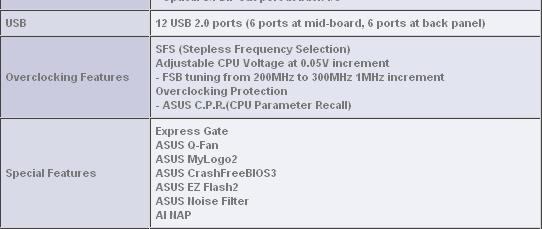

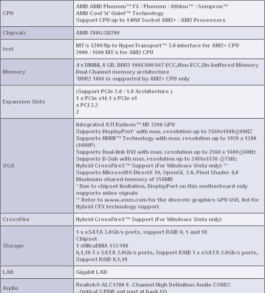

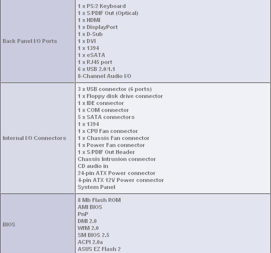

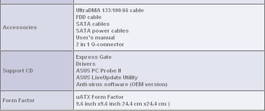

1.2 Spezifikationen
attachment.php
attachment.php
attachment.php
attachment.php
