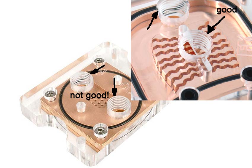

Could you tell me if that is when using 13,3 fittings or 14mm?
Because if using 13,3 barbs the thread hole has to have cutted edges a little bit more so the o-ring could contact the surface.
One option is to use thicker O-rings, which I can supply.
