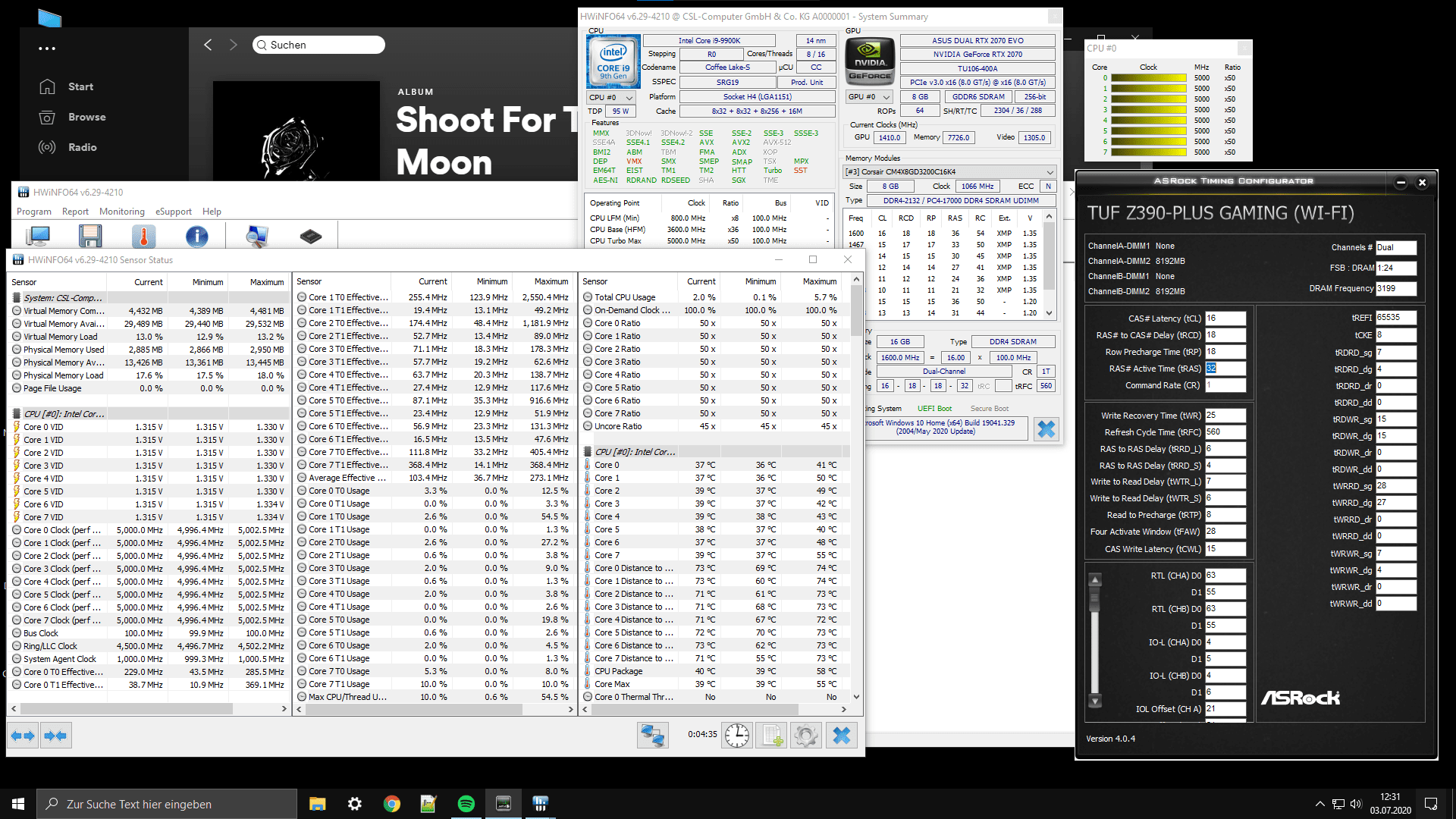

hasey

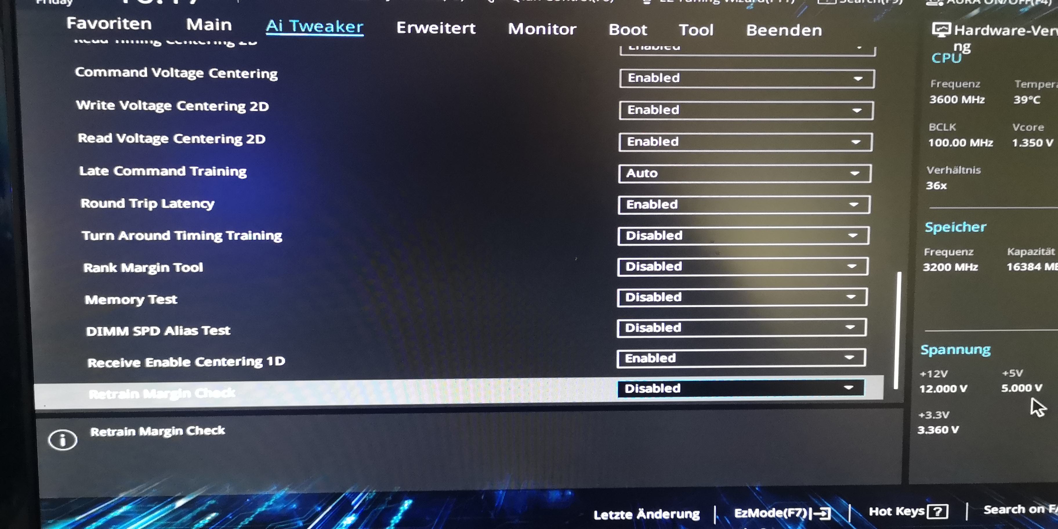

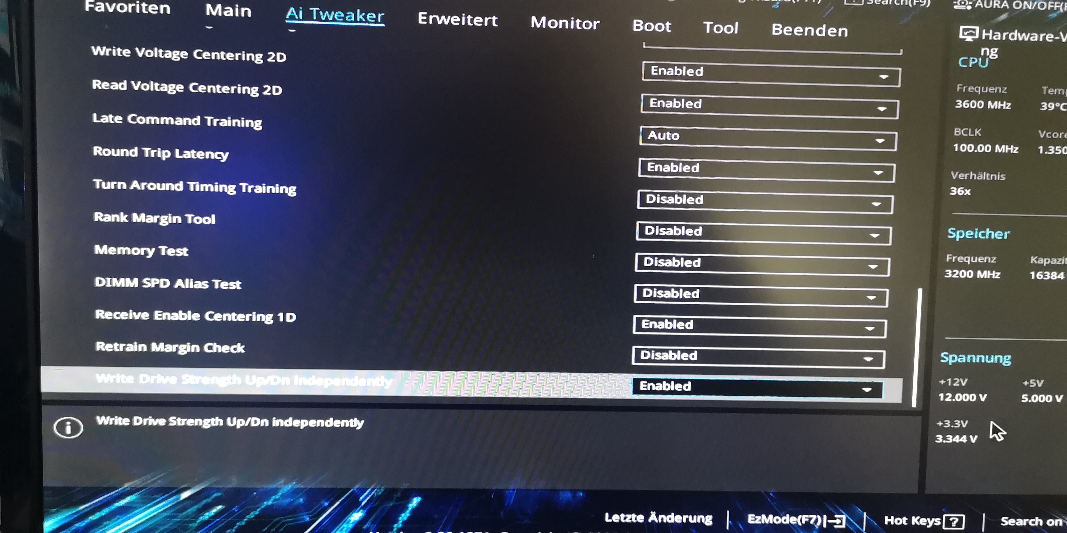

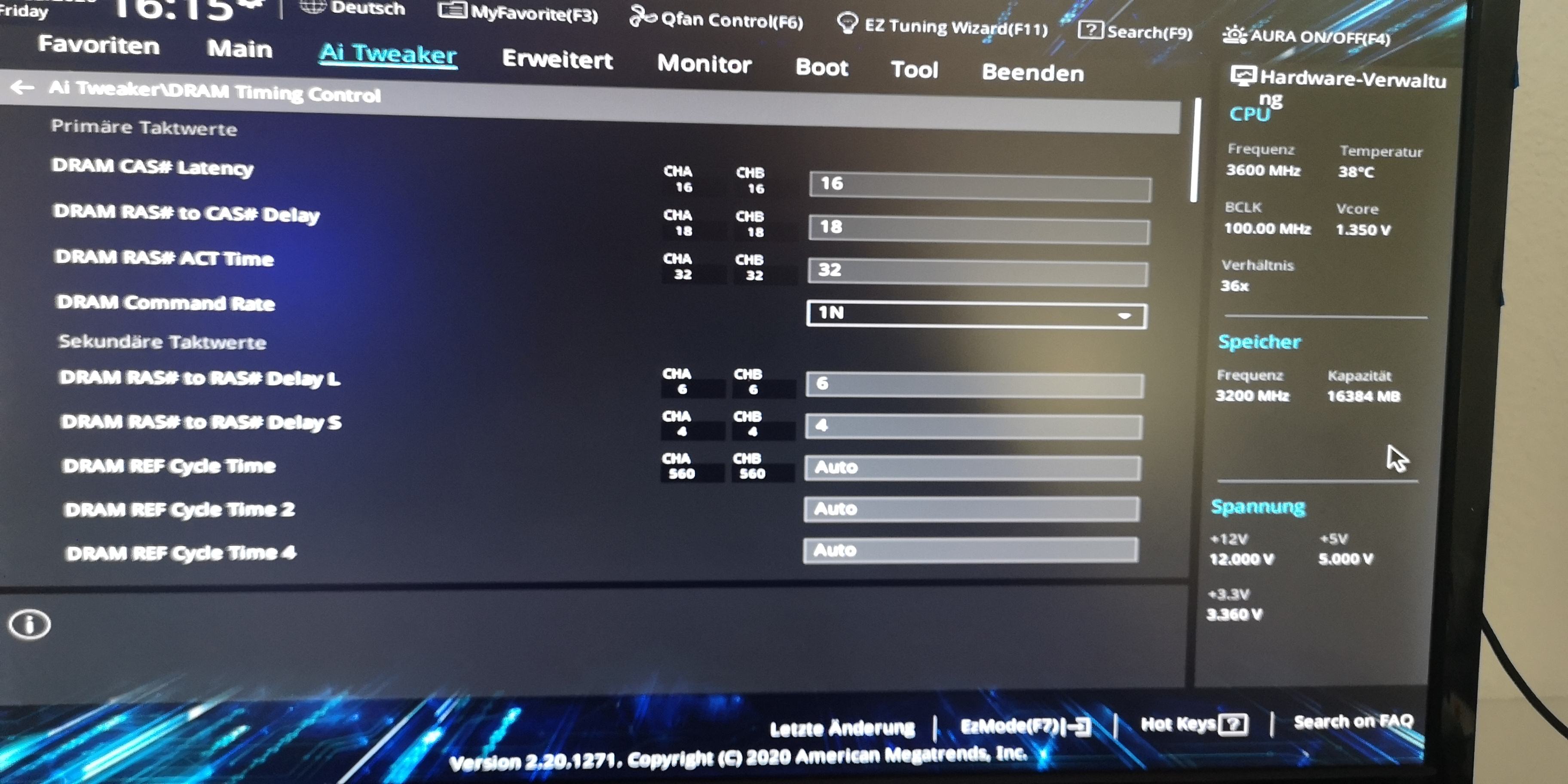

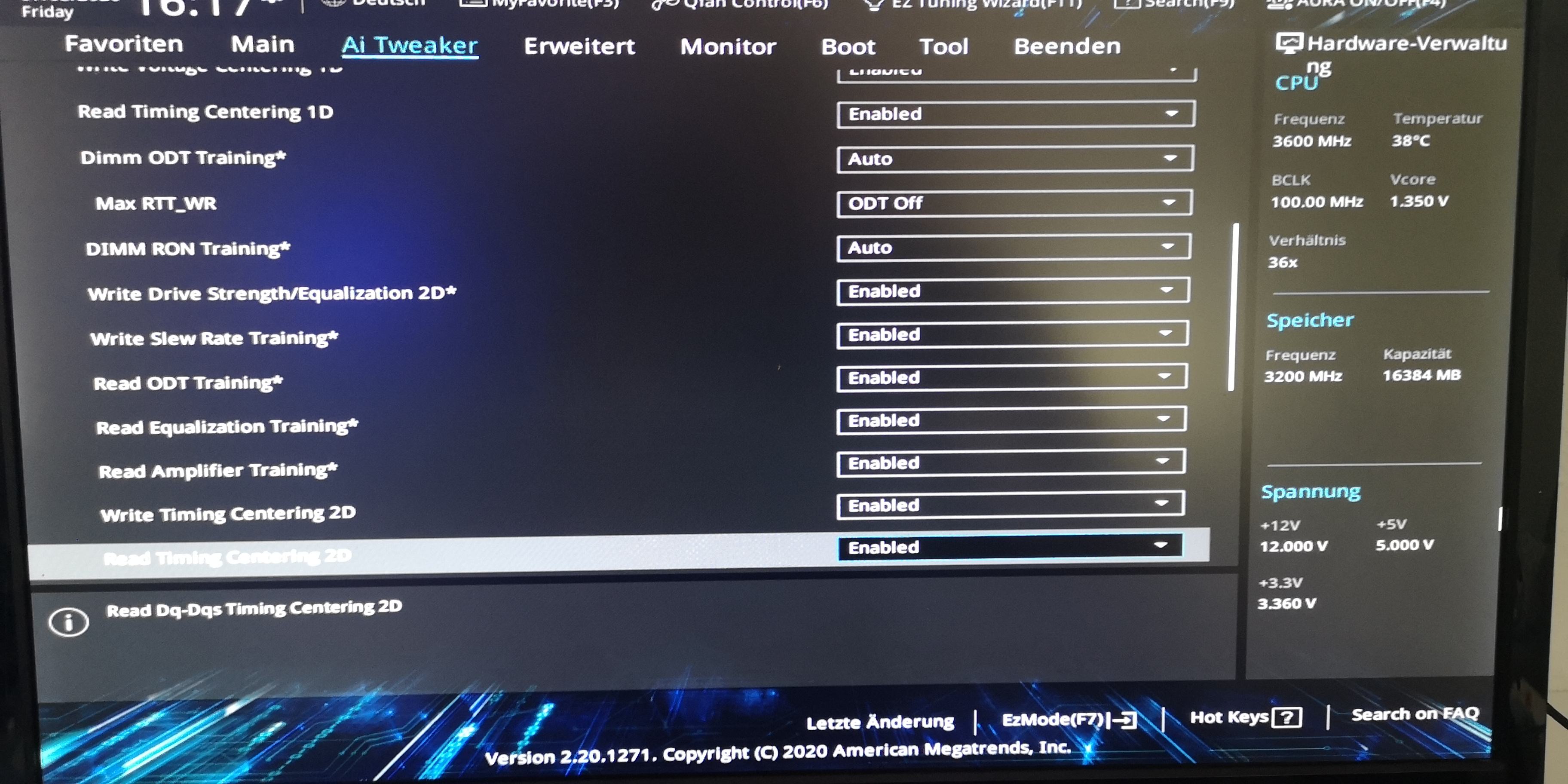

@GrennHaseynator English better? So i cant see DRAM Voltage. VCCIO and VCCSA too on HWinfo64. thats the only thing we care about. you need to scroll down on the right of the 3 windows.
2. we dont kown what you tried already. did you reset you bios before loading the OC? did you raise the voltage? 1.4V or higher? did you loosen the main timings? like 18-22-22-42? did you disable fast boot (under DRAM timings near the bottom) and enabled MCH full check (also there)? did you raise IO/SA manuell to 1.35V if the auto is too low?

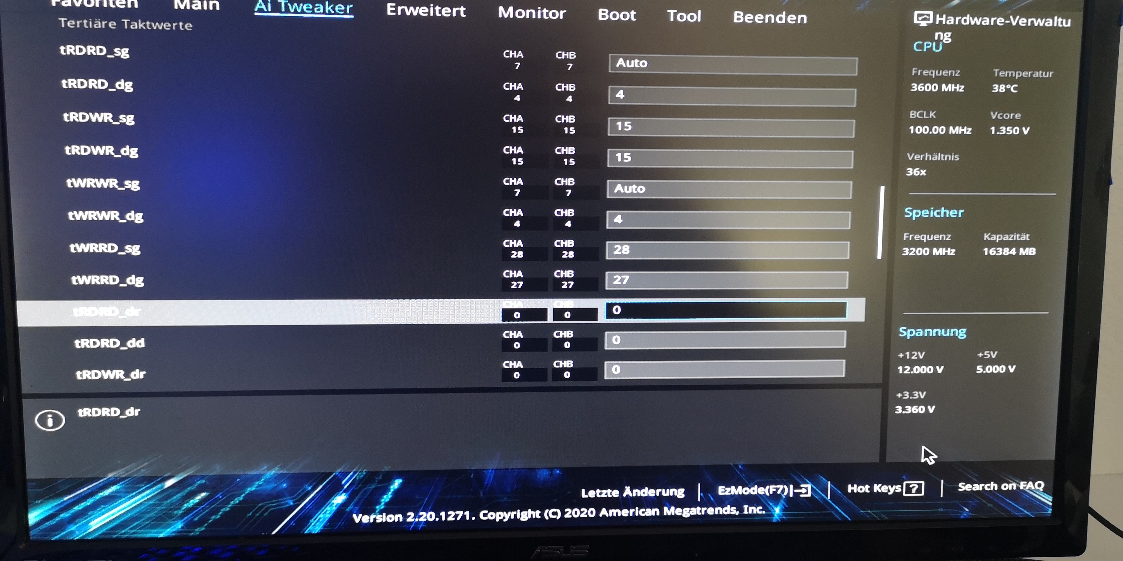

@Maurise that shouldn't be a problem.. so .. here are some bios settings about the voltage and also the timings and trainings..
What do u mean with reset bios.. started with reoptimized settings or real reset with jumpers or something like that?!
Fast Boot is Disabled .
The Voltage at the moment (on pics) was more like 1.35 .. just started to push up after i wasnt able to connect 3333mhz .. but it made no difference .. after that, i started to write here in this thread
"Did you loosen the main timings?" more on 16 18 18 and with fullcheck on auto
on IO/SA i did nothing before ..
Thx for answer by the way

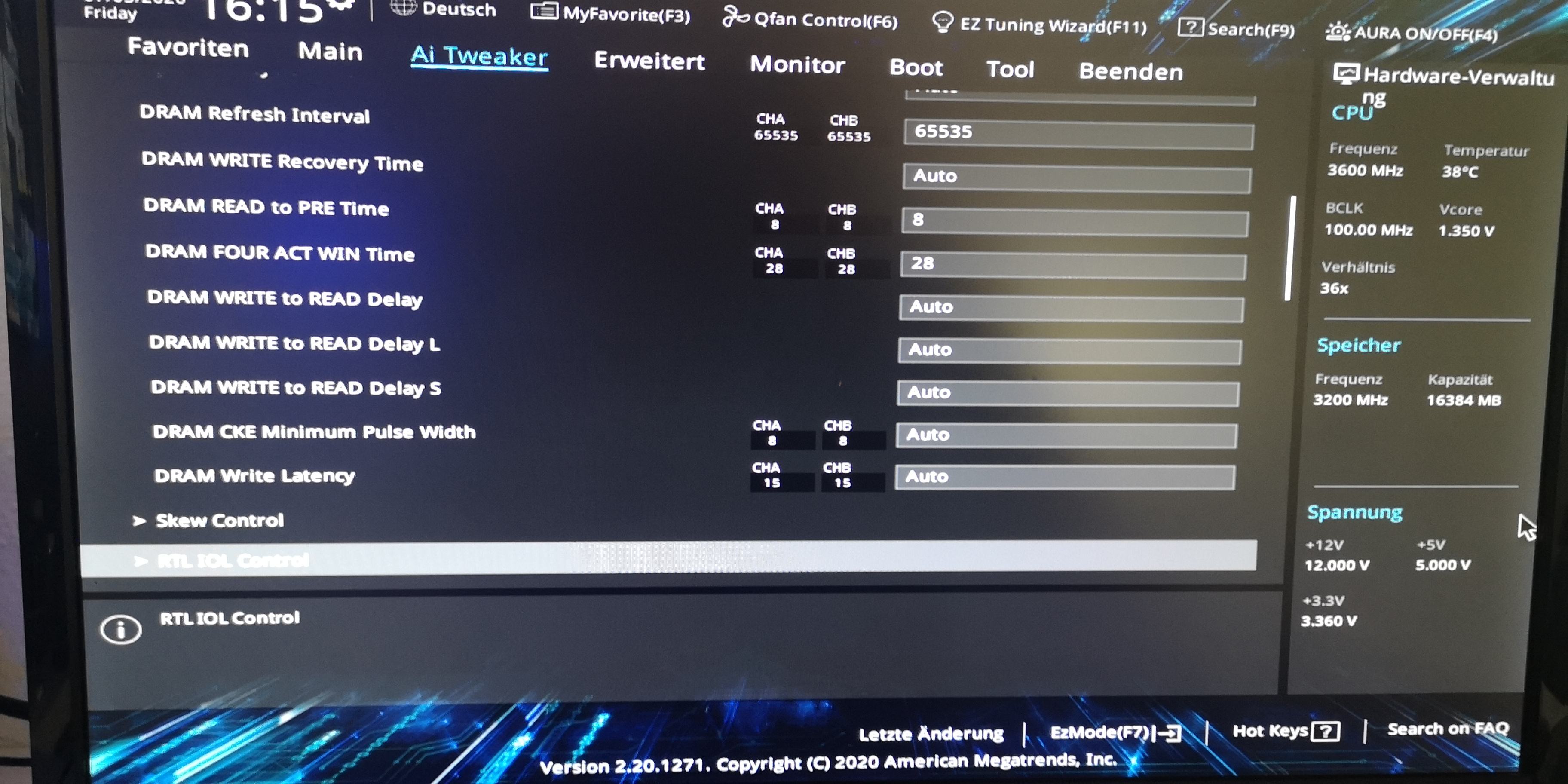

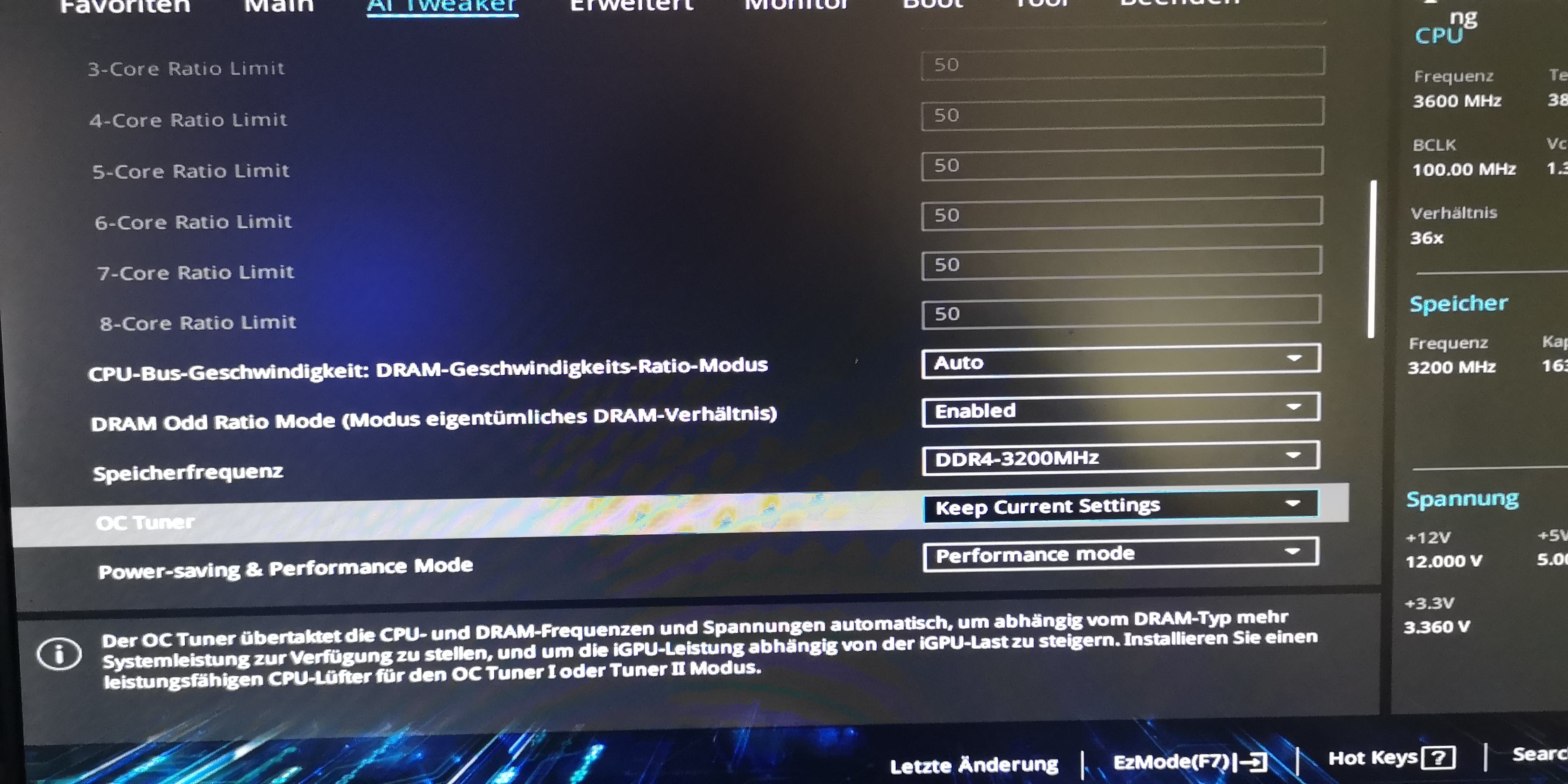

yea optimised defaults. your MB traines things like the Skew (ODTs and slopes), bit lanes or subsurface timings you cant influence directly for each boot. if you dont reset them for a new boot where you like to try different timings or frequency, the board can get stuck at old settings that dont work with your new OC.
i would reset. go with manuel instead of XMP and set 18-22-22-42 as the main timings. disable fast boot so your MB trains better and enable MCH full check. not auto. DRAM 1.45V. IO 1.35V, SA 1,35V. first you go with 3200MHz and then work your way up. If you cant get past 3333 with that i dont see a way to make you boot higher. you have SK Hynix MFR ICs as RAM. I dont have that much experience with them but my HyperX Predator 3333MHz 16-18-18 would not go past XMP. i bought new RAM that OCs a lot better and learned a lot after that. it can be you RAM is just not capable of running higher. Because of the ICs or because you are unlucky.
also we dont have OC tuner as an option with maximus MBs. dont know but thy it with activated and deactivated or so. might help dont know
if you have something like a Mem_OK switch on you MB disable it.
okay ill try this later when i got the time ...
yea i read something like that the second profile of them is optimized for train pro timings
mem_ok on mb to off? isnt it unsafe for hardware?
if it would be unsafe i would not advice to do it. its not like the LN2 switch that enables you to set much higher voltages. and even with that its hard to kill RAM. Dont know if its ok for your ICs to get 2V but normaly they can. and you wont even go near that even if you would try to boot it like that. unlike the CPU. if you not on negative temperatures to much voltage can kill a CPU. RAM is not that picky

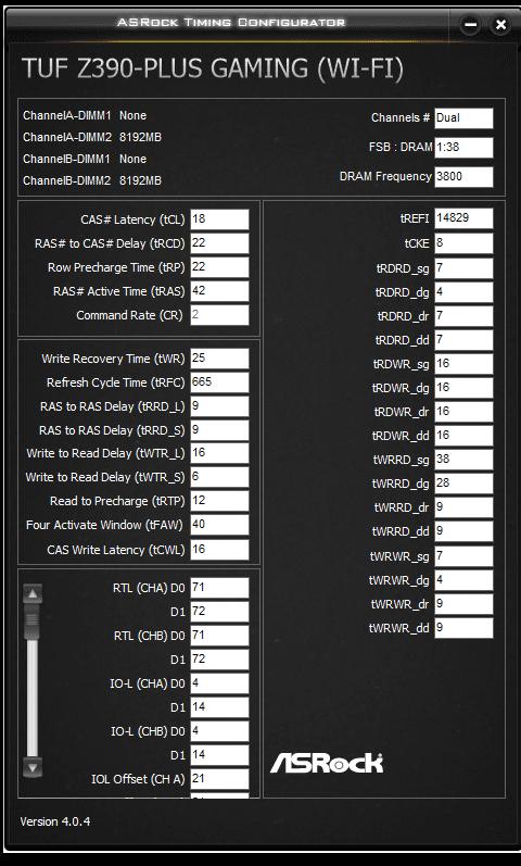

@Maurise well great.. i did it exactly as u wrote and came up to 3900mhz with these settings, than i tried also 4000 mhz and i chilled at blackscreen after saved on bios. After that, i wasnt able to boot on 3900mhz so i keep it on 3800 for now.. nice!
What would you recommend as the next step for me?
1. Do my OC settings on CPU
2. Advanced settings
3. tight dram timings
like that?
btw should i switch off MCH full check again?
What is about realtime memory timing? its disabled at the moment..

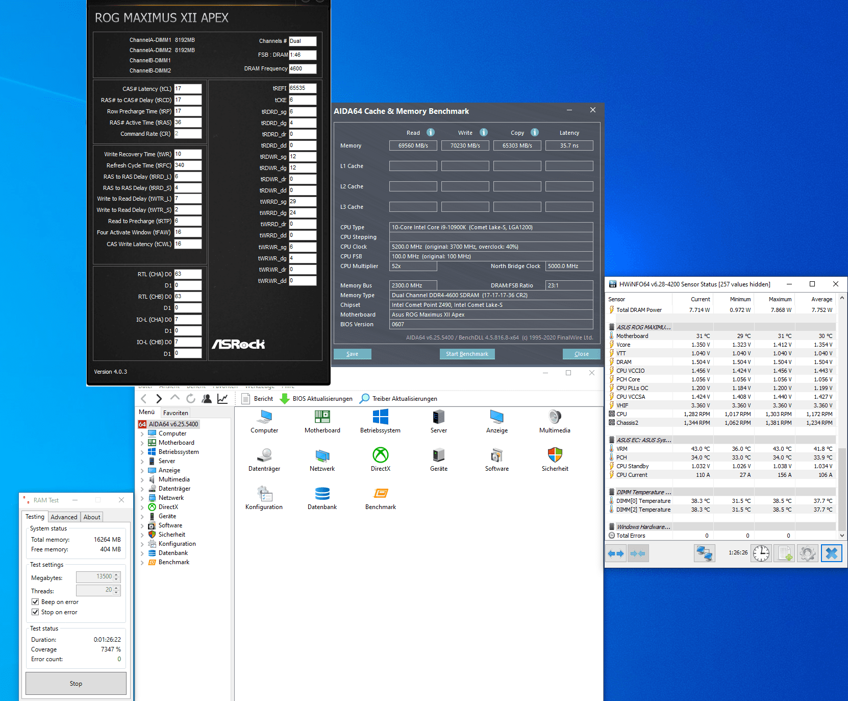

Hat jemand noch ein paar Ram Settings Hilfestellungen für mich.
Das ist mein 24/7 Setting.
Ram Spannung liegt bei 1,42 Volt IO 1.3 SA 1,30625
Die Patriot 4400C19 laufen ähnlich wie meine Trident Z A2 3200C14.
17-18-18 @ 4600 bekomme ich leider nicht stabil. Auch nicht mit laschen Subtimings.
Witzig ist, dass ich einfach mein 4600C17 Profil von den Trident Z laden konnte und es lief auf anhieb. Zeigt mir, dass das Custom PCB von den Viper 4400 und den Trident Z RGB sehr sehr ähnlich ist, wenn nicht sogar identisch.
Normalerweise ist mein Profil für die 4600C17 ziemlich zickig bei anderen Modulen und vor allem mit anderen IMCs. (tCKE4 z.B) Aber die Patriot machen das auch einwandfrei mit.
Kleiner Temperaturetest noch auf Nachfrage:
60 Minuten mit low RPM Silent Wing davor.
Dann nach 60 Minuten den Lüfter abgemacht und weiterlaufen lassen. Nach 10 Minuten war dann Schluss.
Hier noch der Vergleich zu meinen Trident Z 3200C14:
@GrennHaseynator 3800 is good. with only 2 DIMMs in you wont get much more on that MB. you can try with more voltage if you want, but keep in mind at some point you need to cool your RAM. its not like you can damage it with that, but it will get instable with heat. over 1.5V doesnt give you much more headroom under 4400MHz so i would ceep it at that max. you can try 1.55V if you like. If you are happy with your frequency then go down with CL 16 is good. 14 min but i dont think you get there. tRCD/tRP 20 or 19. tRAS can go down to 32 but i would test that step for step. 38 or 36 should be fine.
if you have that testet for stbility with memtest or such min. 1h you can do the other. the others is a little bit more work. tRFC you can go down 20 at a time. if you cant boot go 40 back up and it should be good. tREFI should go to the max. 65535 or so. should be fine. if not try about half that. for the others you can try to get what their are at 2133 stock after reset. only the _sg and _dg are important for your 2DIMMs if you have 4 you must use _dd too and if you have 16GB DIMMs normaly _dr.
tCL should be about what your CL is. tWTR_L/S are set by tWRRD_sg and dg so let them on auto. tWR is set by tWRPRE far below with +20. so tWRPRE on 30 is tWR on 10 for Asrock timing configurator. in reallity its -1 like shown but thats not important.

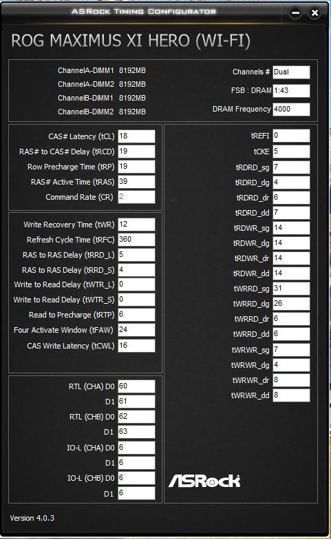

@Eiswuerfel wenn du nicht mehr Spannung willst um die CL runter zubekommen, und mit den sekundären zufriden bist versuch doch die tertiären auf JEDEC zu setzen. tRDRD_sg abwärts 6 4 7 7 10 10 10 11 28 23 6 6 6 4 9 9 laut Asrock timing config. sollte gehen.

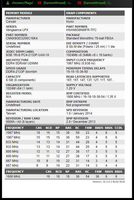

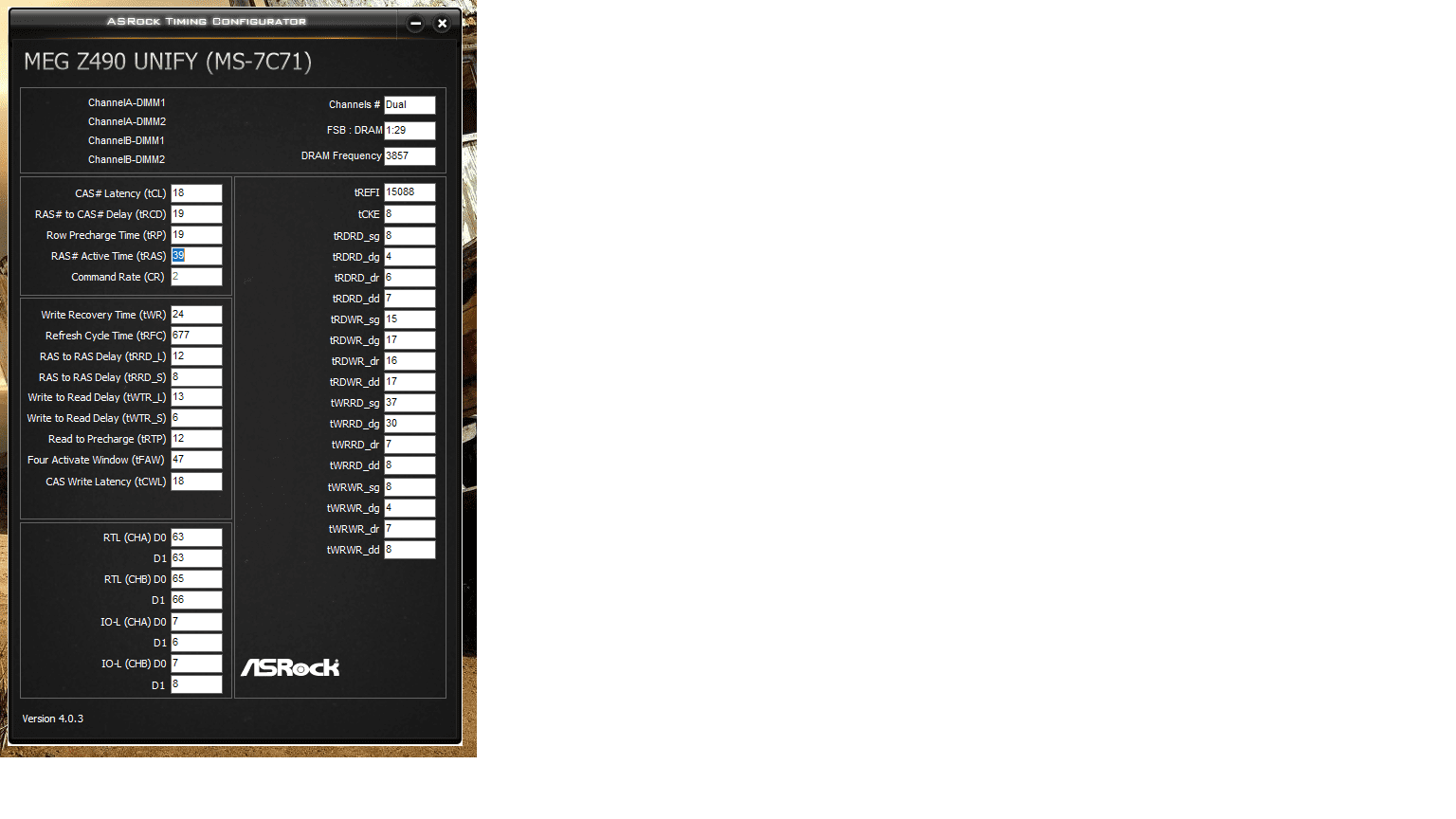

moinsen, wo kann ich bei den F4-3866C18Q-32GTZKW an den Subtimings noch was rausholen, ohne die Spannung zu ändern?
read und copy scheinen mir bissl niedrig zu sein. Kann es sein, dass der Timing Configurator noch nicht mit Z490 klar kommt? Liest bei mir nix aus. :d
klar kannst du subs ändern ohne Spannung
Du musst nur die richtige Version haben, kann dir gerade aber nicht sagen welche.
Aber das findet sich per sufu besitmmt sofort im forum.
hab die 4.0.4.
Kommt erst die Fehlermeldung Acces violation at adress 00403652 in module 'AsrTC.exe'. Read of adress 00000018
und dann das
zumindest wird schonmal das Board erkannt. :d
4.0.3 brauchst du.
ok. ich schau mal.
so sind die XMP Timings.

Du kannst es mal mit 4000 und das hier versuchen, wenn das mit CL18-19 nicht läuft CL19-19.
Was auf 0 ist heißt Auto lassen RTL/IOL natürlich nicht übernehmen.
