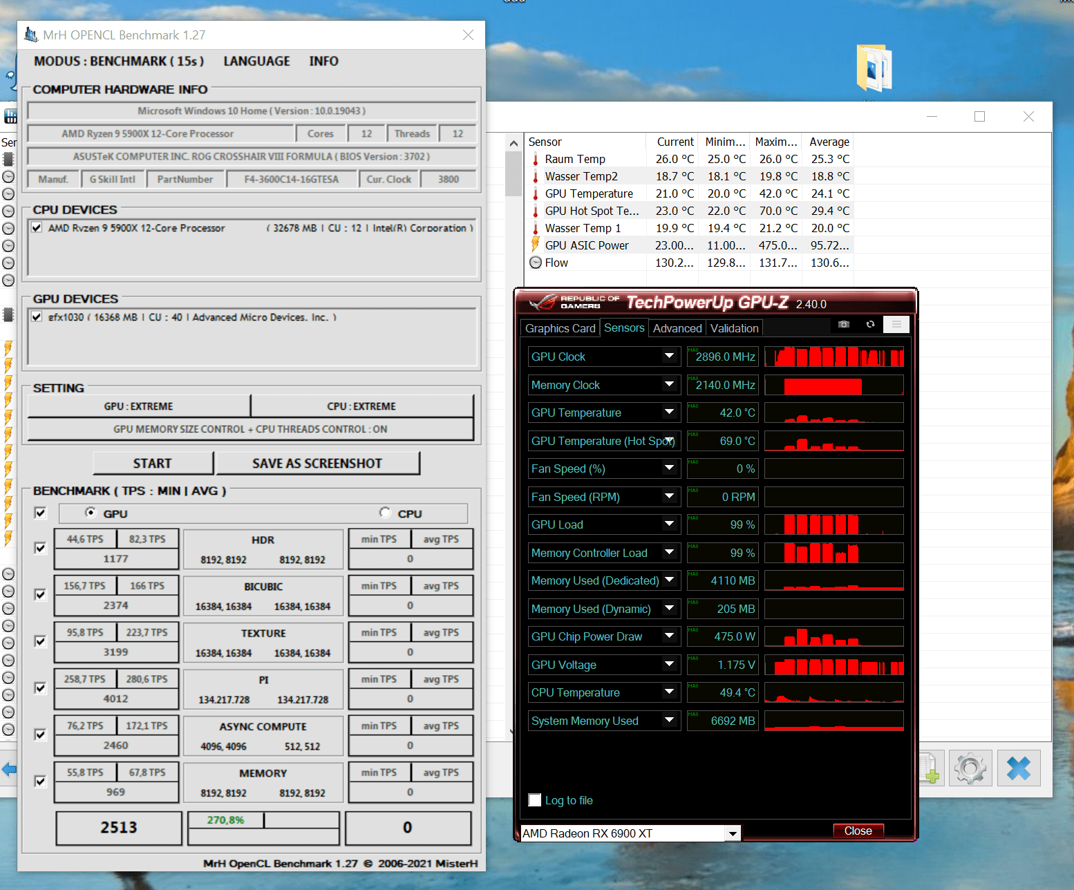

yes i enlabed this in feature option , how i need set hysterese ?

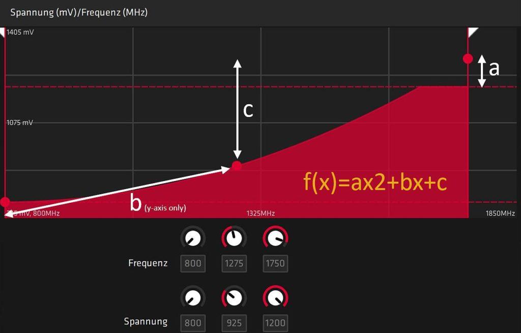

the card takes the voltage like the curve it described
may be you can do some tests with other SVO-values, but thats not so easy, to be stable
probably a=0 would be nice to have in your case, but you have to the test it out, how b and c must be compatible
if you lower a, the c must be lower in the same way and b higher, would i think
is any way to change curve ?
SVO change soc voltage not gpu voltage
thats normal
probably a=0 would be nice, but you have to the test how b and c must be compatible
yes i see it , and change , but this change only soc voltage
i don´t believe thats only SOC
i think, it should work like navi as GFX curve
i tell you , this was i see , changing curve give me only raise soc voltage
linear drop also not working
in my opinion LD is only in use in Deep Sleep actions
if the the driver drops the clock he use the LD values and not curve in the lower states
minGFX + LD-value = effectiv Volt-value needed für the lower Clock at State XYZ
