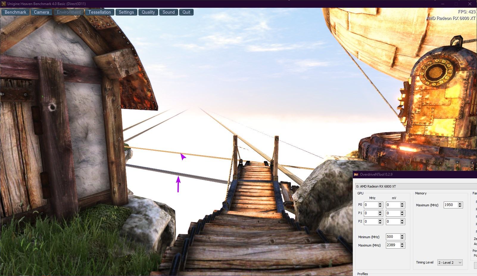

Aber memory technisch ist Unigine Heaven zb einfacher "fehler" darzustellen sowie spiele wie APEX & Warzone
1950-1997 geht noch , aber verschmiert texturen
Streched/artifacts
EDIT: Zb sowas

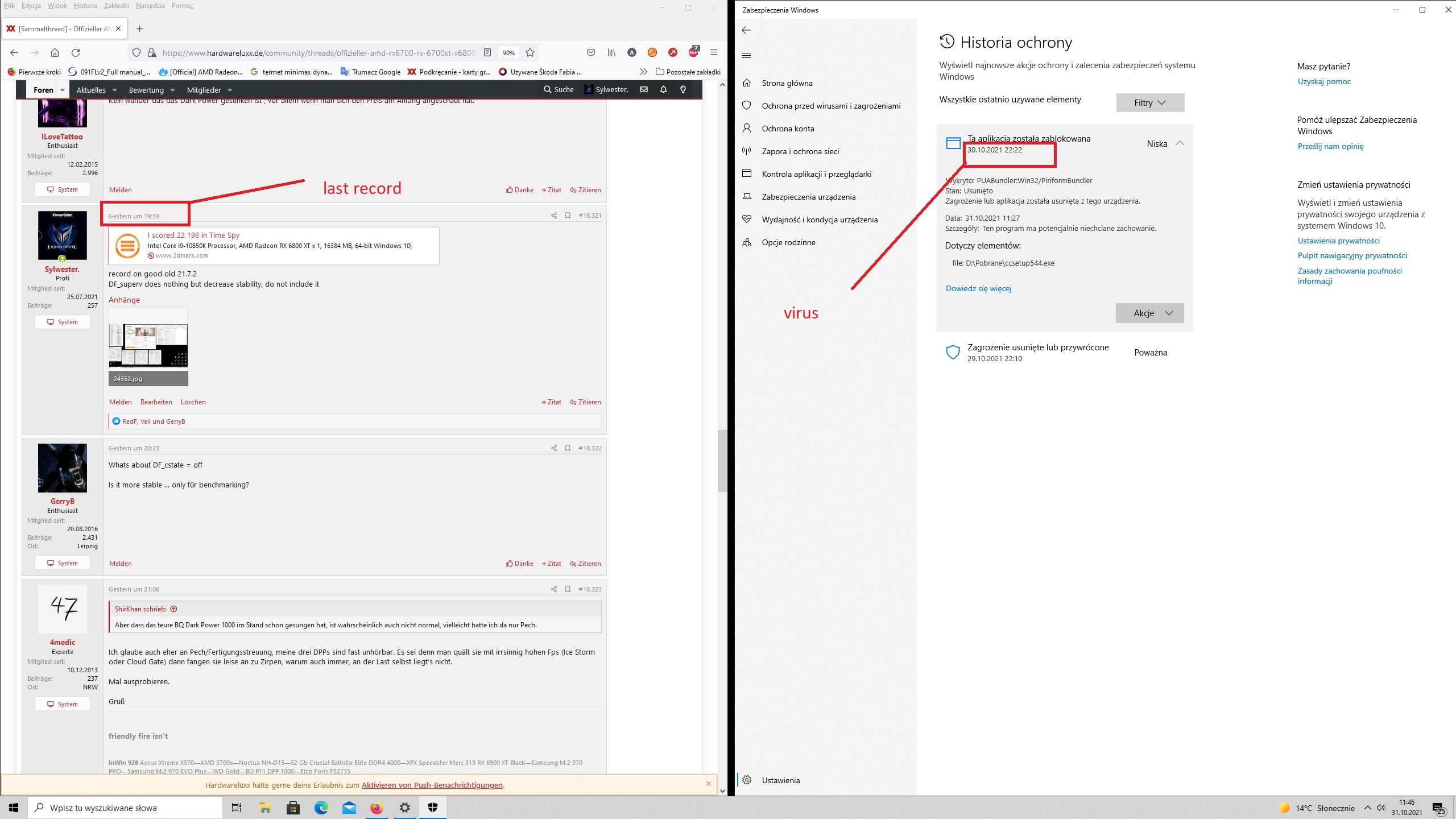

Well Gentlemen, I'm sweating today, hand, foot, brain on the wall :eek:, at some point after get last record, the computer began to go crazy, at first I thought it was Windows, but on the backup system on second ssd same thing 😵‍💫, ALL my settings caused the driver restarts , whatever i set, I think to myself "I beat the card ", chip degradation as in the bank :cry:. I shuffled the drivers, settings in the motherboard bios, nothing, my pants are full to the brim, I crashed the card like nothing, in the meantime I tried another mpt file, nothing. I'm totally bummed, I threw away 1200 euros :wall::wut:, finally I threw away all the mpt logs, based on the pictures posted here I recreated the files based on a new base file ripped once again from the card through gpu-z and it start work again :banana:
F. ..k but I was sweaty, adrenaline like I was jumping off a bridge with a rubber from my pants
I'm writing this to point out that if something starts to go wrong with the oc, it may be worth rewriting the settings to a fresh file.
ps.
I don't wish you the nerves I had today, when it didn't work I prayed "if the card doesn't turn out to be broken I won't overclock anything anymore, nothing ever again" but when it worked back, of course "under stress people talk such nonsense":fresse:
sounds like the L!ME-effect
Good Luck with the new MPT-File!

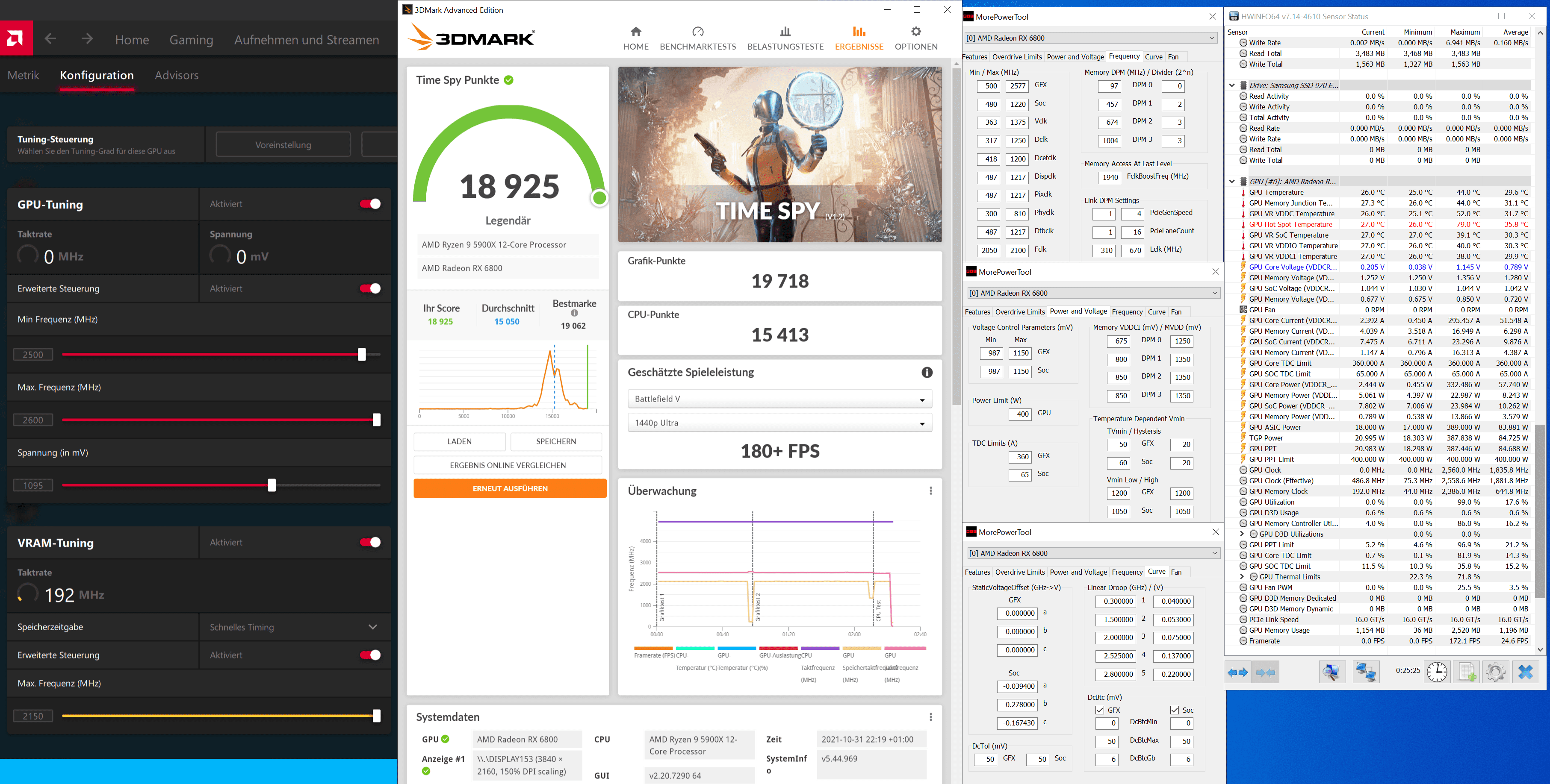

Werde heute noch mal 6800 LE anschmeißen ,mal sehn was mit dem Voltmod noch möglich ist .
Mensch...mach kein Schei...
Jetzt wo ich wenigstens von weiten deine Rücklichter sehe kommst Du mit sowas :heul:.
Mal sehn was der Winter bringt. Luft ist halt nichts für Benchrekorde.
WTF !!!
Yesterday's problems were not an MPT file error, it was a virus, it became active yesterday after 10 pm then I had problems, now I have removed it and the old mpt is working
Yes CCleaner ist a Virus.

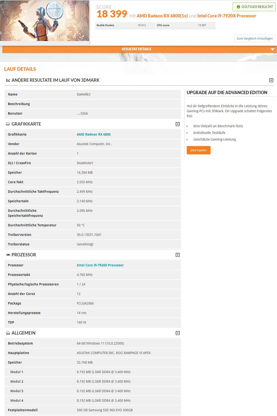

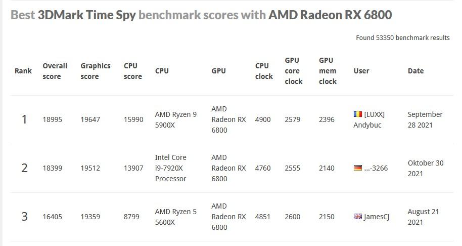

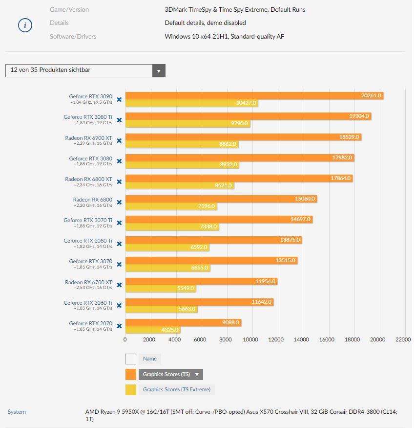

Wow, 19,5k@air ist ja mal wirklich seeehr gut, hätte ich net für möglich gehalten! >=3080Ti@stock
(aber noch net in der Luxx-Liste oder bei PCGH eingetragen)
und Das ganz ohne Klimagerät-Modd ala J+H

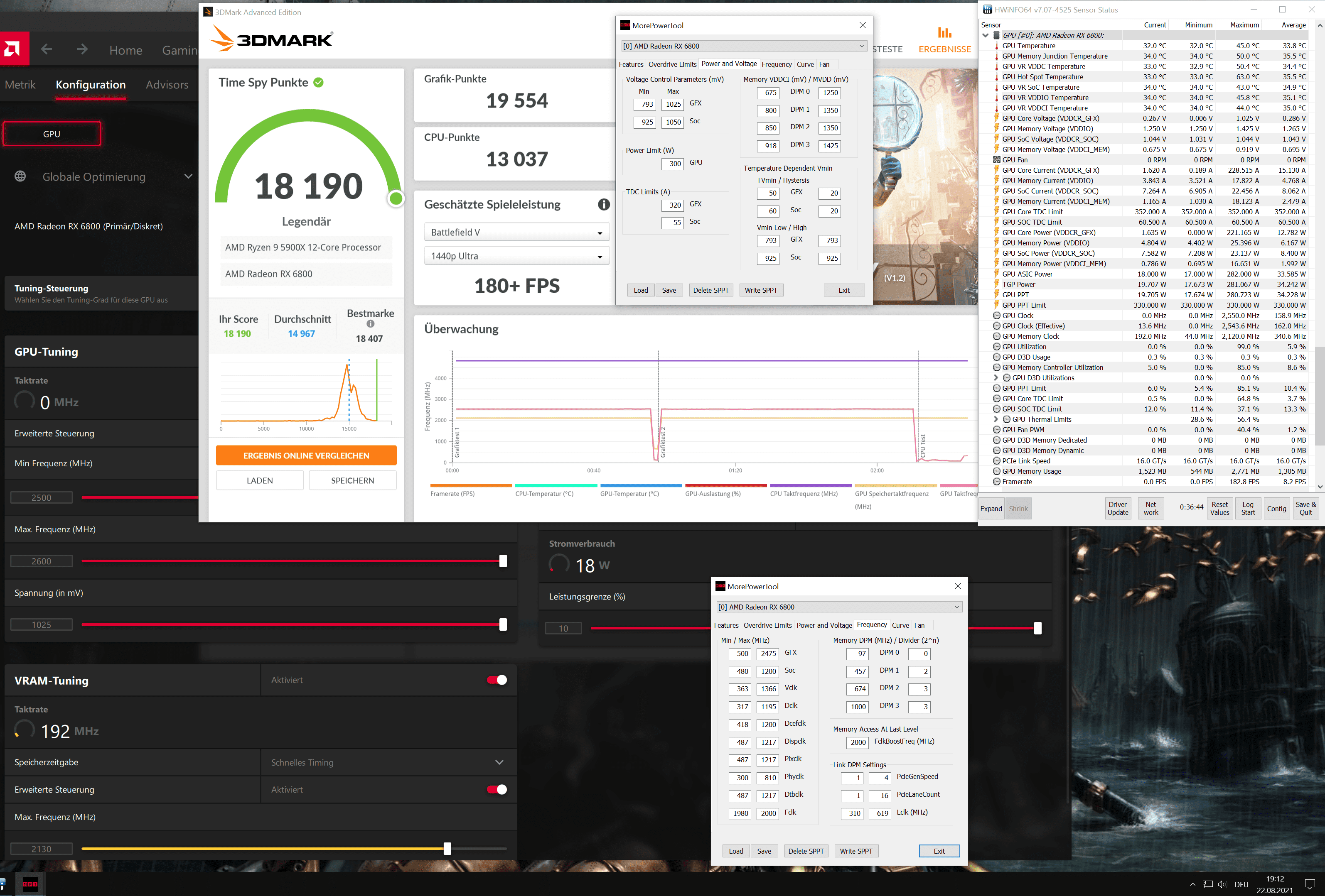

I see, thanks for that reference! I'll try to finetune my OC now.
i think Youcan give to the card 1150mv (like stock6800xt) and more power if you have watercooled card i think about 300W (+15% give to Your card ~ 350W) than check oc , how max clock You can set in watman ? if You rise only volts , power limit will by limiting Your oc
I did try to push this and 1150mv is possible, my temps at 1100mv never goes beyond 72C when running Time Spy.
So thank you guys for all the help here, I played around with the settings and boy is it possible to go beyond the stock performance :d
Started out with my previous OC limits
Went for a random raise of the voltage just to try things out
Tried 1050-1100mv
Finally pushing to 1100 min/max and that maxed out the adrenalin settings, so really noo point trying to raise the voltage further without altering with the overdrive limits (which I still don't know how and if it works?)

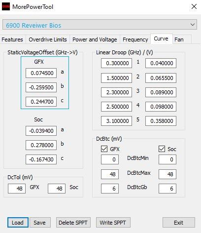

You can have a look at the setting of Andybuc. This was with the 6900 bios load in the mpt.
= higher fclk
But in the frequency tab and at Voltage you must change the values to the origin 6800 values.
(I think the new 6900 values in the curve tab are working without need to change to the origin 6800)
You can find some 6900 bios here:
edit: surprisingly in the todays run Andybuc did´nt change the values Mhz+Volt
He let the values @6900 or 6800bios!?

Der gute Score von DaHell war mit W11, ... scheint besser zu laufen als vermutet. (@INTEL)

Well guys one brave😈 6900xt guy needed, I uploaded the mpt file from the 6900xt bios, I adopted the 6800xt settings but there is something else not included in the mpt file that we can't see which in the 6900 bios won't let my card exceed 2100 flck and this card does it with a finger in the hole (hdmi or dpwhatever You like 🤭), so there is a chance that uploading the 6800xt file to the 6900xt will unlock higher flck
Just don't all throw Yourselves at each other. One desperate man is enough.
