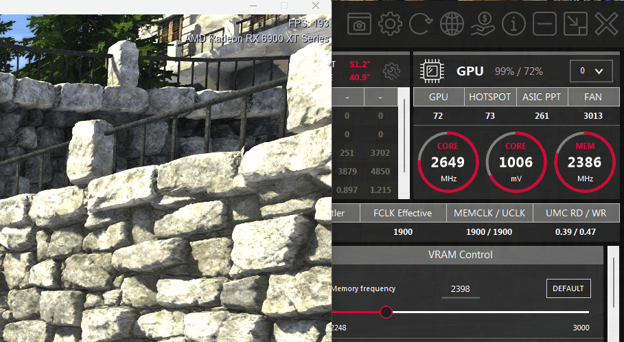

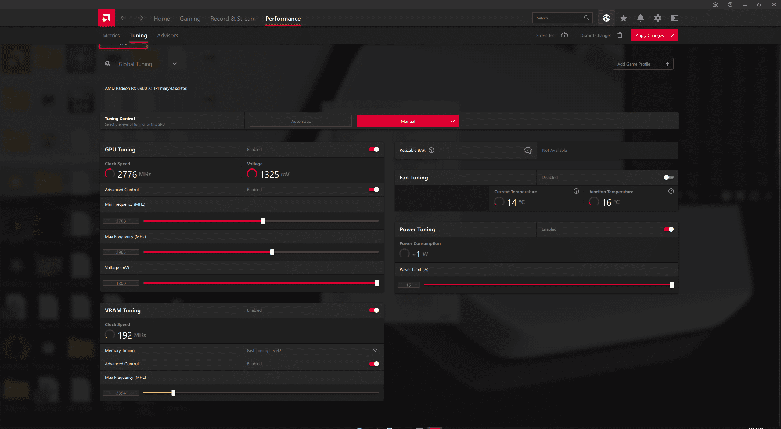

gave it another crack today...last night it rained and was quite humidso waited till today...even with the conditions I could only get the water down to 9.5.
I upped the volts to 1.325 and the gpu clock to 2960...average clock according to 3dmark was 2904..I could never get 1.325v stable let alone 2960mhz.
My max before the chiller was 1.318v and no more than 2920mhz on the core...so I'm gonna continue on this route..bit more voltage when I can get the water cooler...
Haven't tried messing with the memory yet..but keeping that cooler should maybe also allow me to get that clock up a bit more also...
Anyway the chiller has helped a bit...hopefully can squeeze more out of it with the right conditions...unfortunately my cpu score was down around 1000pts again,so my overall took quite a hit 😪

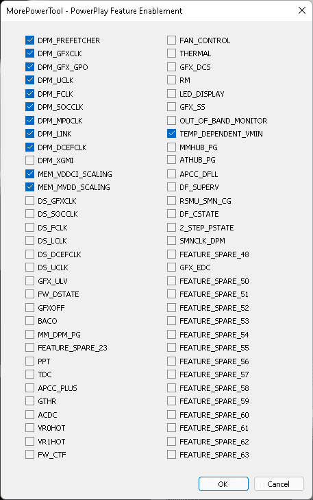

This was a comment from me because i was working on MoreClockTool, which uses the AMD Display Library. And there was a note that v17 would require at least 22.7.1, but this is about other features, not Overdrive. So, maybe not helpfull.
If you have problems with Wattman, you can now try MCT:
RDNA1 is not yet fully supported.

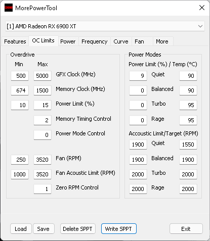

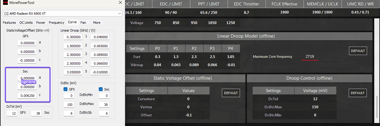

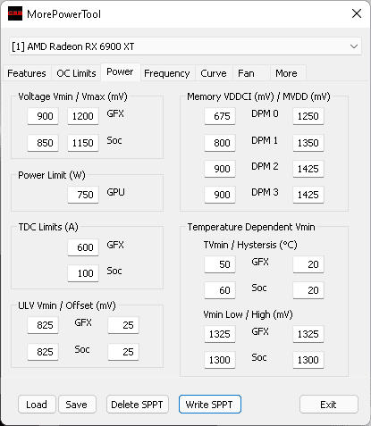

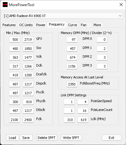

Ooook...here are the MPT/wattman settings for the 26343 run....
Any subheadings I didn't post for MPT I didn't touch anything...maybe I have a couple of settings too high? But when testing scores only went up a little...nothing negatively affected the scores...but not big jumps..eg SOC,FCLK etc
Damn I just noticed I didn't include the frequency tab😆😪..im gonna have to get back on the pc

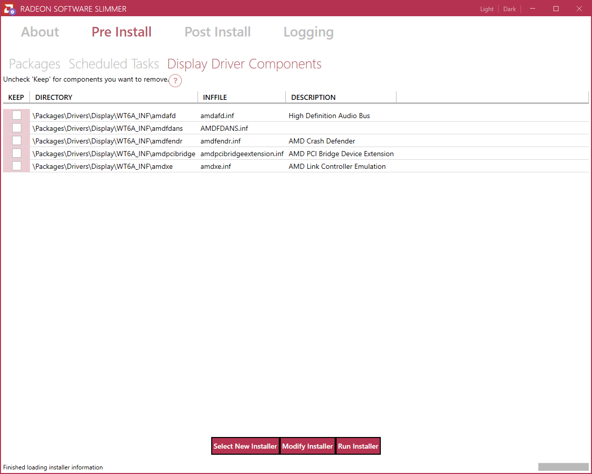

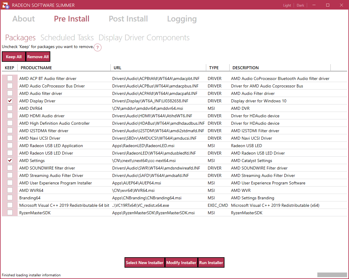

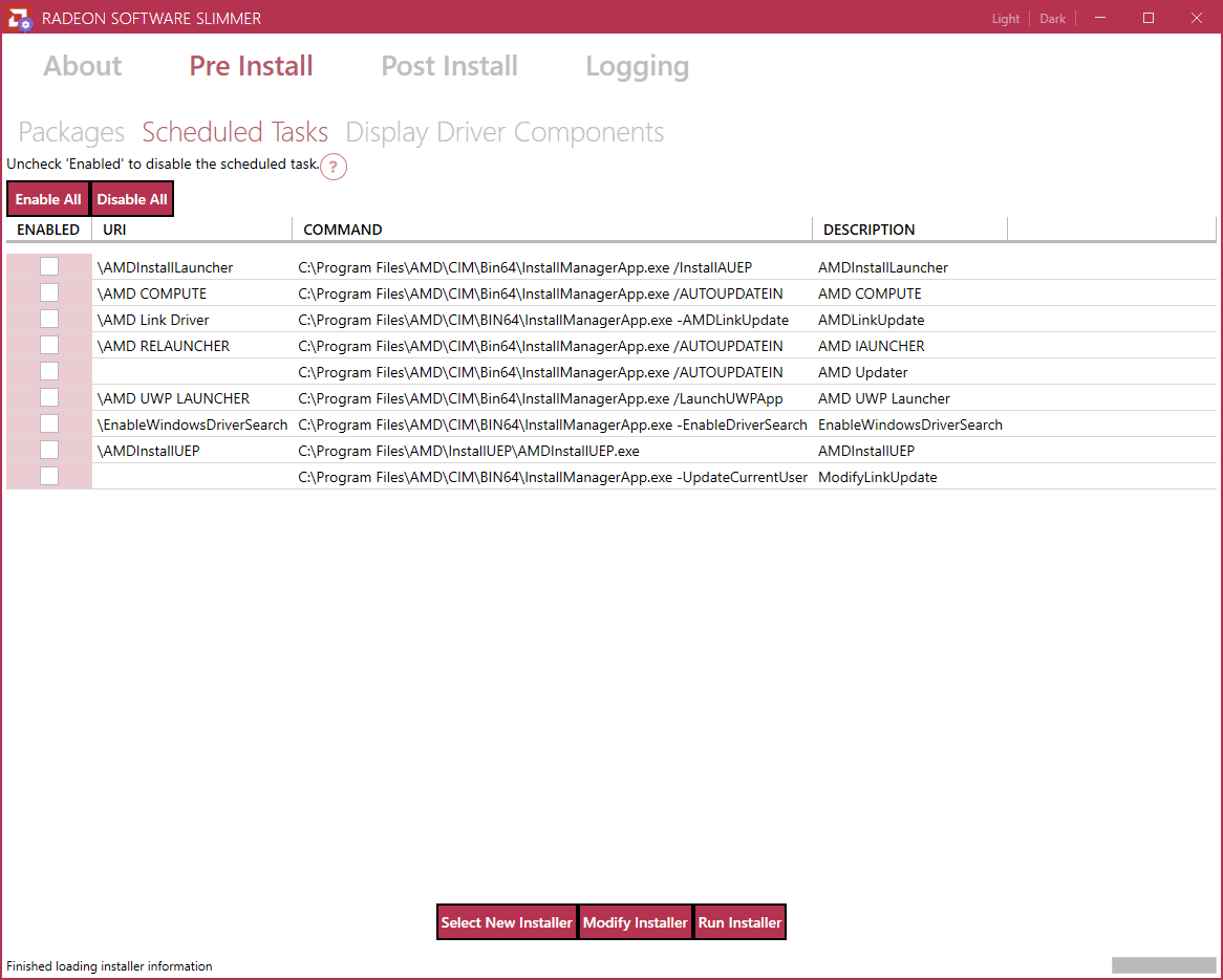

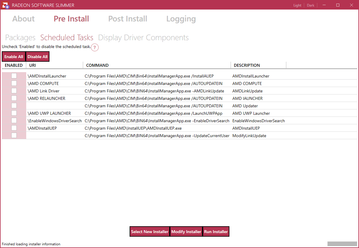

Hi,
nachdem hier verstärkt das MoreClockTool anstelle des Wattman zum Einsatz kommt, möchte ich den Radeon Slimmer auch auf dem Gamingsystem einsetzen, um einen schlanken Treiber installiert zu haben. Dies sind normalerweise meine Einstellungen (außer dritter Screen, das ist experimentell):

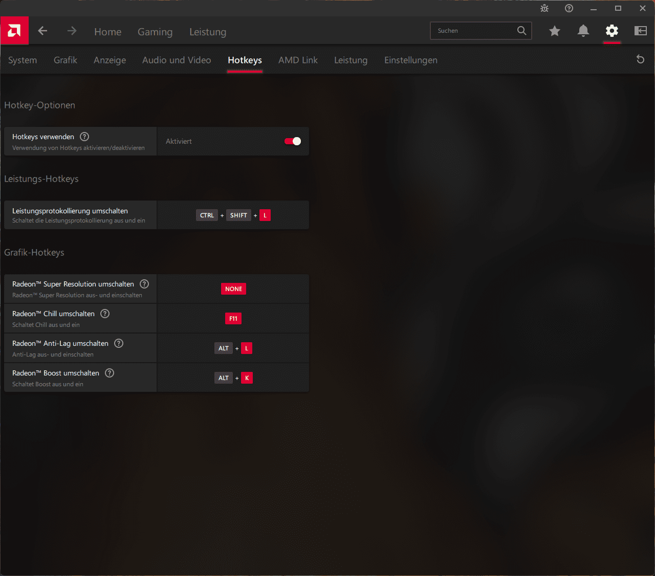

Das einzige Adrenalin-Feature, das ich behalten möchte, ist die Screenshot- und Aufnahmefunktion, aufzurufen standardmäßig mit STRG+Shift+I bzw. STRG+Shift+E. Das funktioniert mit den oben gezeigten Slimmereinstellungen nicht mehr, Menüeinträge und Hotkey-Optionen fehlen.
Kann mir bitte jemand sagen, was beim PreInstall des Slimmers aktiviert bleiben muss, damit die Software per Hotkey Bilder schießt und Videos aufnimmt?

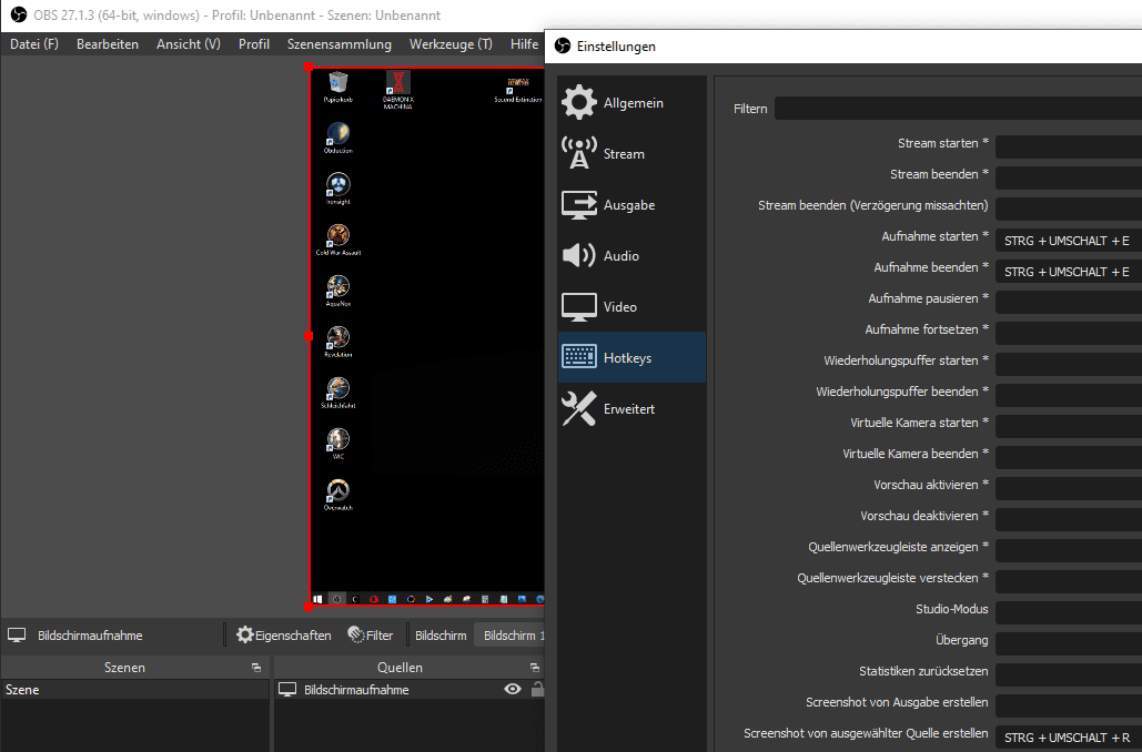

Vllt. braucht ja OBS-Studio nur den nakschen Treiber!?

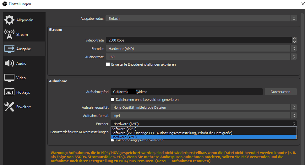

Dort kann man sich auch Hotkeys einrichten, darf nur net vergessen, den Bildschirm als Quelle auszuwählen.
Je nach Intention könnte man dann die Videoaufnahme per GPU-Hardware oder per CPU-software erledigen,
falls einen der Fps-verlust stört und die CPU stark genug ist.
Ja, die Idee ist, eine Software zu verschlanken. Nicht, aufgrund der Verschlankung eine zweite installieren zu müssen.
Niemand? Muss ich wirklich die PostInstall-Methode verwenden und jedes Häkchen einzeln testen?
... oder man ist so intelligent, die 2. nur bei Bedarf/Videodreh einzuschalten

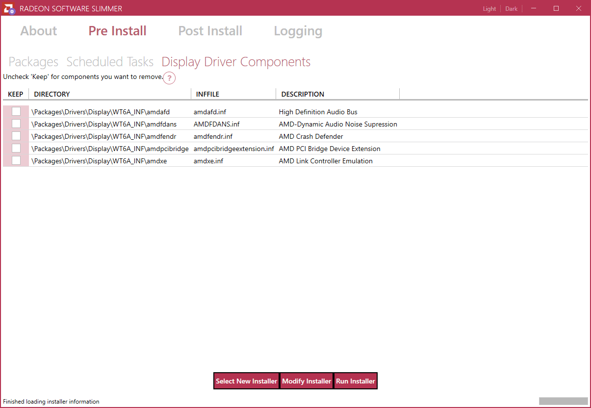

Mag sein, hilft nur nicht bei meinem kleinen Problem. Der Vorteil des Slimmers ist ja gerade, einzelne Treiberfunktionalitäten abwählen zu können. Also danke für dein Engagement, aber da du die Antwort offenbar nicht kennst ...
@ShirKhan im Ryzen RAM OC auf discord sitzt ne Gruppe um @Darki24 die den slimmer recht viel nutzt.
Ich schau mal nach. Die Funktionen stehen ja erklärt dabei, wenn man auf das ? klickt wird man auf die Homepage geleitet.
Da ich diese Video Funktion nie nutze installiere ich halt immer nur den Treiber und das CCC, mehr nicht. ;)
Hoffe das hilft.

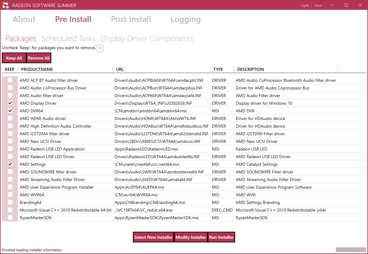

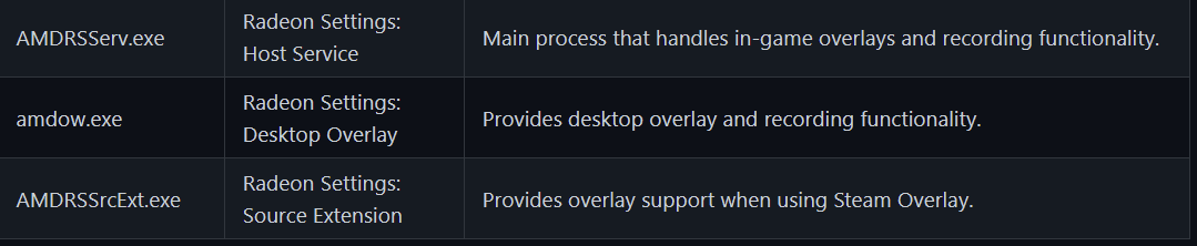

Neue Erkenntnisse.
Zuerst dachte ich, nicht so richtig, obwohl du dankenswerterweise die passenden Grafiken und Webseiten verlinkt hast. Denn nur "AMD DRV64" habe ich im Slimmer-GUI (1.7.0., neueste Version) gefunden. Keine der anderen Dateien/Beschreibungen.
Glücklicherweise ist es genau dieses AMD DRV64, das die Screenshot- und Aufnahmefunktion herstellt, inkl. Hotkeys. Volltreffer! (y)
Und nicht nur das: Meine leise Hoffnung über die oben gestellte Frage hinaus war, dass die Treiberprobleme hier nach 22.5.1 nicht mit den Adrenalin-Grundfunktionen zusammenhängen, sondern irgendwas mit dem vielen Stuff zu tun haben, den AMD in den letzten Monaten dazugebastelt hat. Also habe ich nach folgender Slimmer-PreInstall-Konfig den Exceltest gemacht.
Und siehe da: Die Maus bewegt sich ganz normal, nicht verzögert. Excel-Zellen lassen sich verschieben. Kein Blackscreen. :banana:
Natürlich muss das weiter beobachtet werden. Aber 22.8.2 hat nun eine neue Chance, auf dem Gaming-System zu bleiben. Was mich freut, denn er ist performanter als 22.5.1.

Glücklicherweise ist es genau dieses AMD DRV64, dass die Screenshot- und Aufnahmefunktion herstellt, inkl. Hotkeys. Volltreffer! (y)
