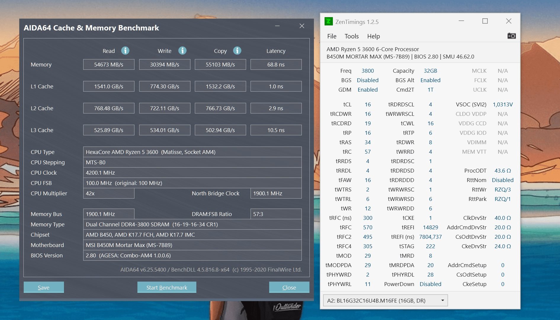

Hi, guys. Can you help me tighting my timings and improving latency please? Any help is very welcome. Thx in advance.
I have 2x16gb Crucial Ballistix 3200mhz E-Die
Can you further reduce tRFC? Have you already tried lower sub-timings and ran into problems?
I am just asking because I see you are running 1T without GDM. Despite this being a lot more tricky, it can be faster. But on the other hand if you don't want to test a lot of settings, then switching to 1T with GDM on, might drastically help dropping timings.
I'll try to reduce tRFC to 554. If I lower sub-timings, it won't even post.
As for GDM, I can't enable it, it's greyed out and I don't know why.
I'm not an expert and I'll say I have difficult to understand how these timings work.
Can you set Command Rate? What are the values there? 1,2 and Auto? If so, you need to chose Auto and should now be able to turn GDM on. This will help a lot with stability.
Yes, it's 1, 2 and Auto. I'll try Auto, thx.
Edit: So, tRFC won't post set to 554 or lower. GDM on and Command Rate set to 1T, I lowered tRCDRD to 19 but it seems a bit unstable. First test latency is 68.8ns and then up to 70.9ns
What else can I try? Sorry, I don't understand much of this.

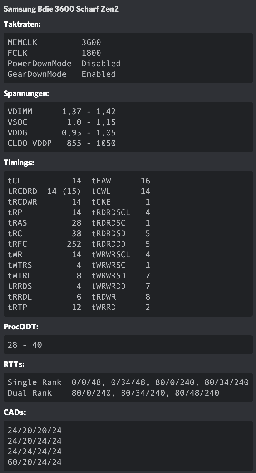

You may want to scroll through the screenshots in this thread to get a feeling about your values:
@iLLuminatusANG
tWTRS 4
tWR 12
tCWL 14
tRP 10
das sollte noch drin sein. wenn nicht, testen obs läuft mit *scl von 3 auf 4
tRFC 270, skaliert mit VDimm. Bis 1,46v probieren. Vielleicht geht auch 266

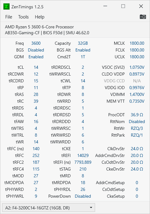

Aktuell habe ich das Problem, dass ich von der tRCDRD nicht unter 15 komme bei meinen B Die's Bei den aktuellen Timings im Anhang bin ich mit der anta777-config stabil. Leider sind die AIDA Werte nicht überragend. Geh ich richtig in der Annahme, dass ich mit weiteren Absenken des tRFCs die Latency reduzieren könnte? Ich fahre, glaube ich, schon recht knappe Subs. Vielleicht kann jemand noch mal einen Blick drauf werfen? Ich hab mich den der Berechnung im ersten Post orientiert, bei github auf der Memtest-Seite werden aber teilweise andere Berechnungen herangeführt. An der Stelle bin ich etwas lost :(
@Eckengucker
DRAM-Calculator 3800er timings save-settings und freuen

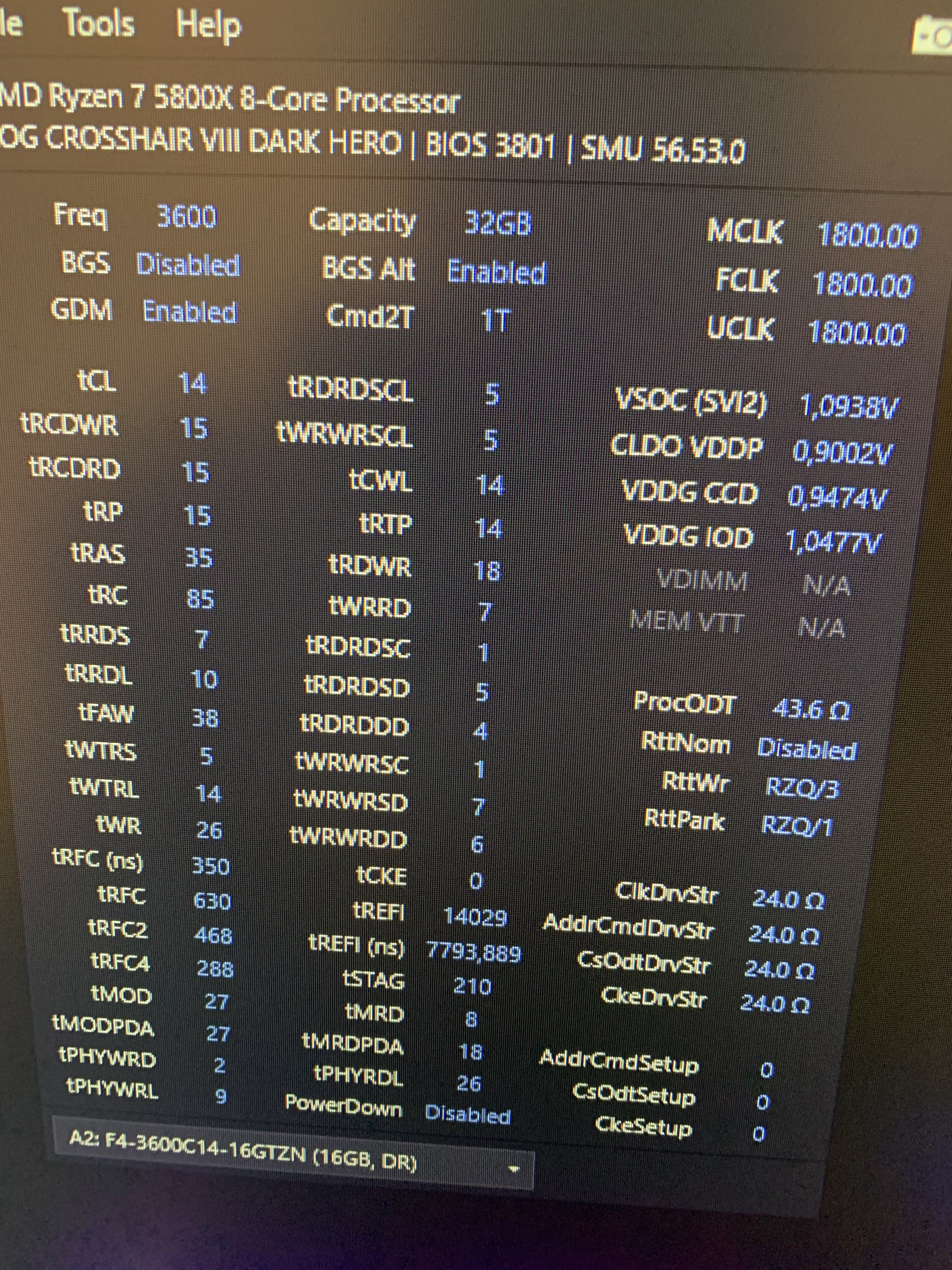

Hallo habe mir diese Kit gekauft F4-3600C14-32GTZN + Dark Hero VIII Bios ist aktuell 3801 + Ryzen 5800x nun wollte ich den RAM OC machen und wollte wiesen ob es sich lohn die 3800cl14 oder lieber anpassen die 3600cl14? oder eventuell mehr erreichen hat jemand eventuell erfahrung damit bis viele kann ich mein ram oc machen.
der ryzen läuft mit PBO Manual 120-85-130 curve 30 negativ all core
habe hier vieles gelesen und viele sagen dass mit diesen werten stabil laufen sollte?

@Eckengucker
du bist schon ziemlich am Limit. Viel wird da nicht mehr gehen. Vergleich nochmal mit diesem Preset...

Was mich nur etwas wundert ist seine 'hohe' Latenz. Laufen bei dir viele Hintergrund Programme?

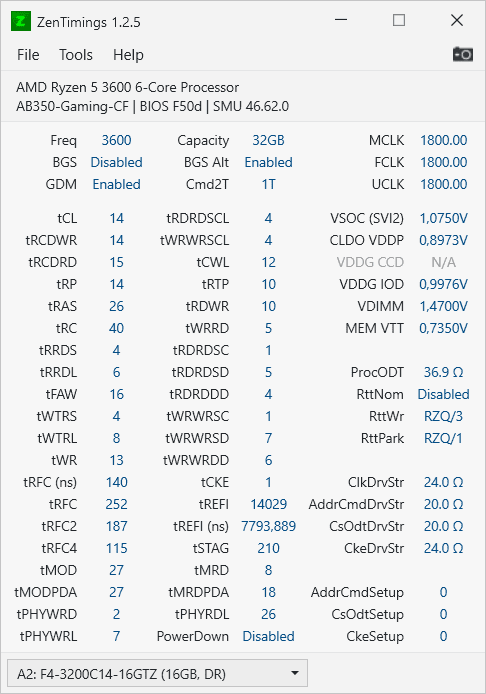

Danke euch beiden. Ich habe aktuell folgendes Setting stabil zum laufen bekommen:
Ich werde im abgesicherten Modus noch einen Benchmark durchführen, viele Programme laufen eigentlich nicht. Das Windows ist auch eine spezielle Ghost superlight Edition mit sehr wenig Ballast. Leider bekomme ich aus irgend einem Grund die tRCDRD nicht runter. Ich kann machen was ich will. Testmem5 wirft direkt nach 2 Minuten Error 4. Ich hab schon alle möglichen anderen Presets angeschaut, jeder kommt dort deutlich drunter. Ich bin bisschen mit meinem Latein am Ende..

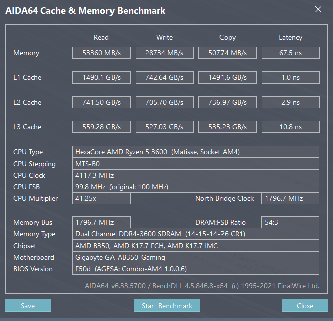

Ich hab im Abgesicherten Modus noch mal gebencht. Wie zu erwarten war sind die Werte eine ganze Ecke besser.
Ich vermute, dass die Latenz auf Grund meiner alten CPU so hoch ist. Zen 3 kommen ja in der Regel unter 60ns. Ich würde gern an die 64ns ran, was hätte auf die Latenz Einfluss? Die tRFC?

Ich hab im Abgesicherten Modus noch mal gebencht. Wie zu erwarten war sind die Werte eine ganze Ecke besser. Ich vermute, dass die Latenz auf Grund meiner alten CPU so hoch ist. Zen 3 kommen ja in der Regel unter 60ns. Ich würde gern an die 64ns ran, was hätte auf die Latenz Einfluss? Die tRFC?
tRFC ist hier ein besonders guter Parameter ja. tRFC skaliert auch recht gut mit Spannung :)

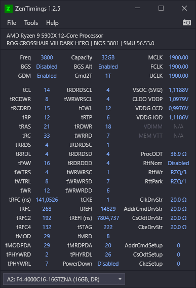

Hat mich auf die Idee gebracht da nochmal ran zu gehen und zusätzlich noch ein paar Subs mit runter zu drücken... Wenn man bei maximal 1,45 Volt bleiben möchte denke ich dürfte das hier passen?
CL14 mit 1,5 Volt möchte ich nicht... tCWL 12 werde ich bei Gelegenheit mal versuchen... Ansonsten schätze ich dürfte nicht mehr all zu viel zu holen sein außer mit mehr VDIMM...

sieht sehr gut aus.
genau, das einzige wo du noch sinnvoll was probieren kannst. Hat es einen bestimmten Grund, dass die VDDP 1,0v hat? Sollte auch mit 0,9v laufen.
Nein hat keinen besonderen Grund. Ich nutze Autoeinstellungen bzw lass das Board alles selber Regeln. Manuelle Spannungen nutze ich nicht ehrlich gesagt...
