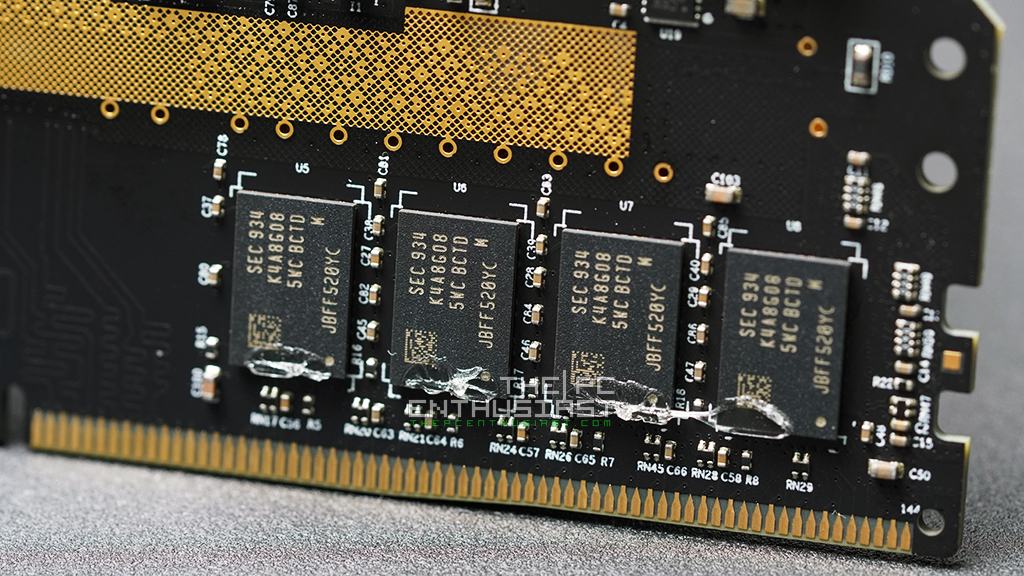

Nachdem die ICs nun öfter auf Retail Kits auftauchen, habe mich noch mal ein wenig nach Reviews umgesehen und bin tatsächlich fündig geworden:
1) Corsair Dominator Platinum RGB CMT16GX4M2C3200C16 @ The PC Enthusiast
Corsair-Dominator-Platinum-RGB CMT16GX4M2C3200C16 (C-Die, thepcenthusiast).jpg

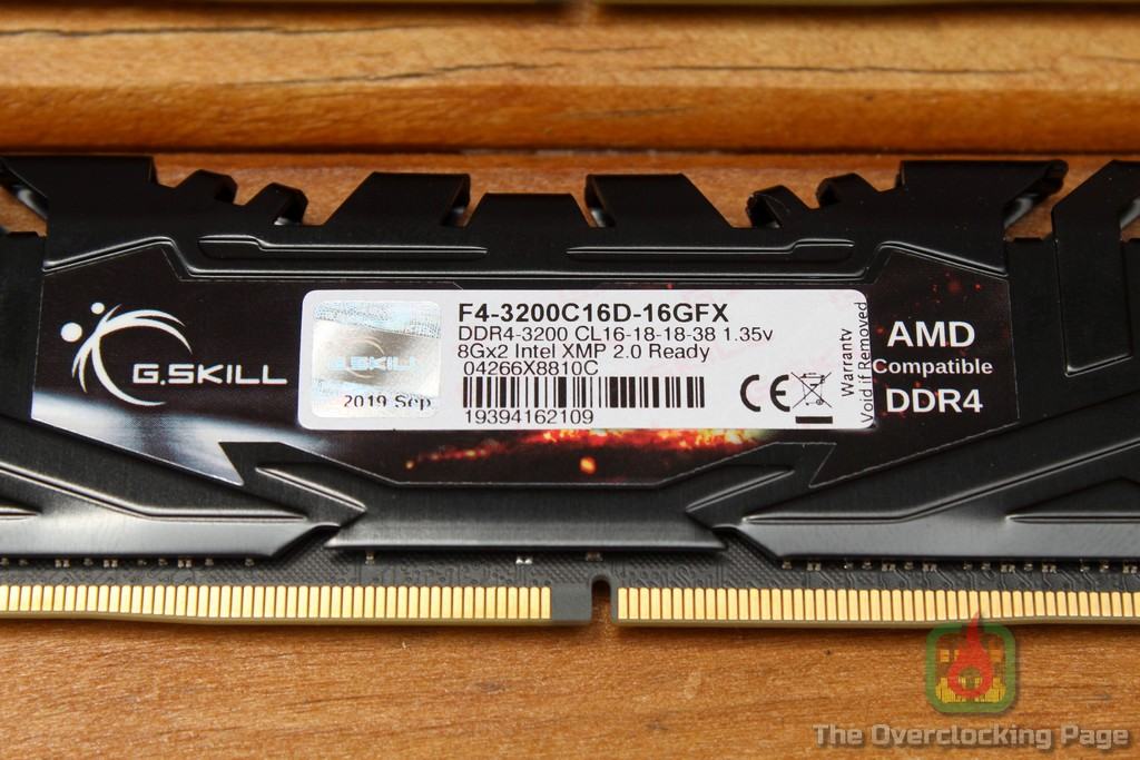

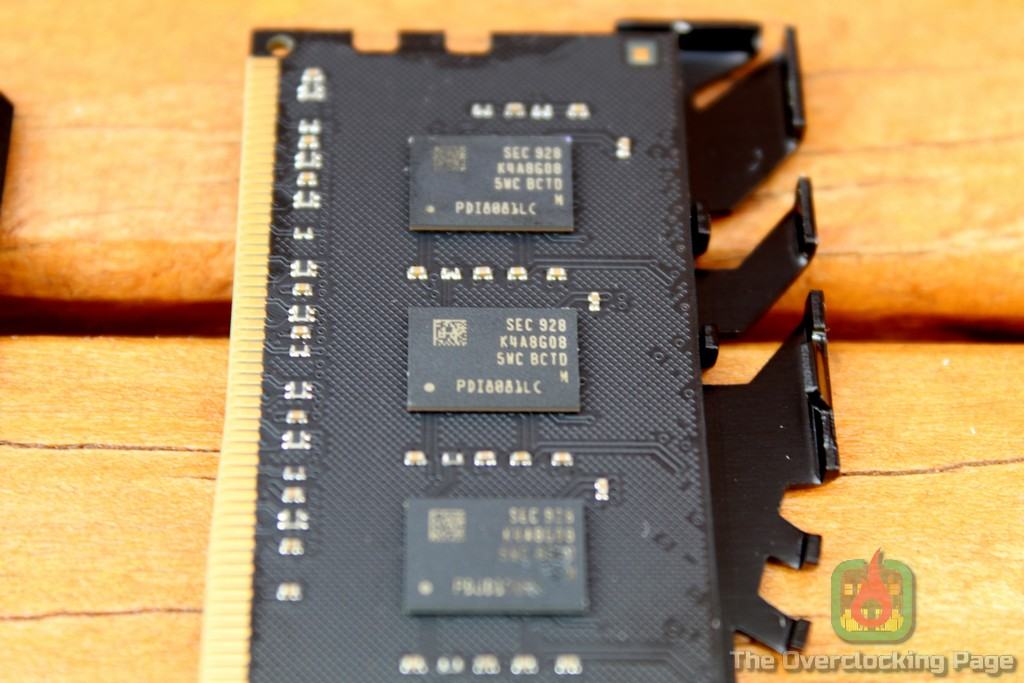

2) G.SKILL Flare X F4-3200C16D-16GFX @ The Overclocking Page
G.Skill Flare X F4-3200C16D-16GFX (C-Die, theoverclockingpage, 2).jpg G.Skill Flare X F4-3200C16D-16GFX (C-Die, theoverclockingpage, 1).jpg
Sind beide auch in der Liste der bekannten C-Die Modelle ergänzt.

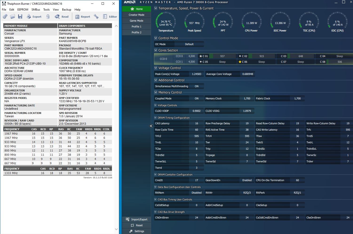

I have corsair rev 4.32 ram (2x16GB) (CMK32GX4M2A2666C16). MSI x570-a-pro, 3800X. Thaiphoon claims it is b-die, but I have heard differently, that 4.32 is c-die.
I have found that it is stable at a higher frequency than what is reported in this thread.
1.40V is stable at 3400Mhz 40/53/60 Omh procODT, 16-19-19-38 (tRFC 595). Once I found that 3400 is stable at 1.40V, I dropped it sequentially. 1.35 will not POST, 1.36 has errors after a short time, 1.37 has errors after around 10 minutes, 1.38V - 1.40V are all stable.
I also tried 1.28V, and it does not post at 2933Mhz.
I am happy with this overclock, but I am confused as to why my corsair 4.32 has a much different profile than what is described in this thread.
That is most certainly the case and has been for all Ver4.32 based kits that I have seen up to today.
You might have misread the screenshots then. With Zen2 it is usually possible to achieve DDR4-3600+ with very little effort. Performance should be best at your highest possible 1:1 ratio, so 3733/3800 in most cases. In general your overclock falls well wihin our tested results. However your kit seems to have a little bit better voltage tolerance than some of the OEM sticks or average kits, if it scales up to 1.4V.
The high tRFC requirement and the scaling of the primary timings are all pretty typical for C-Die, actually.

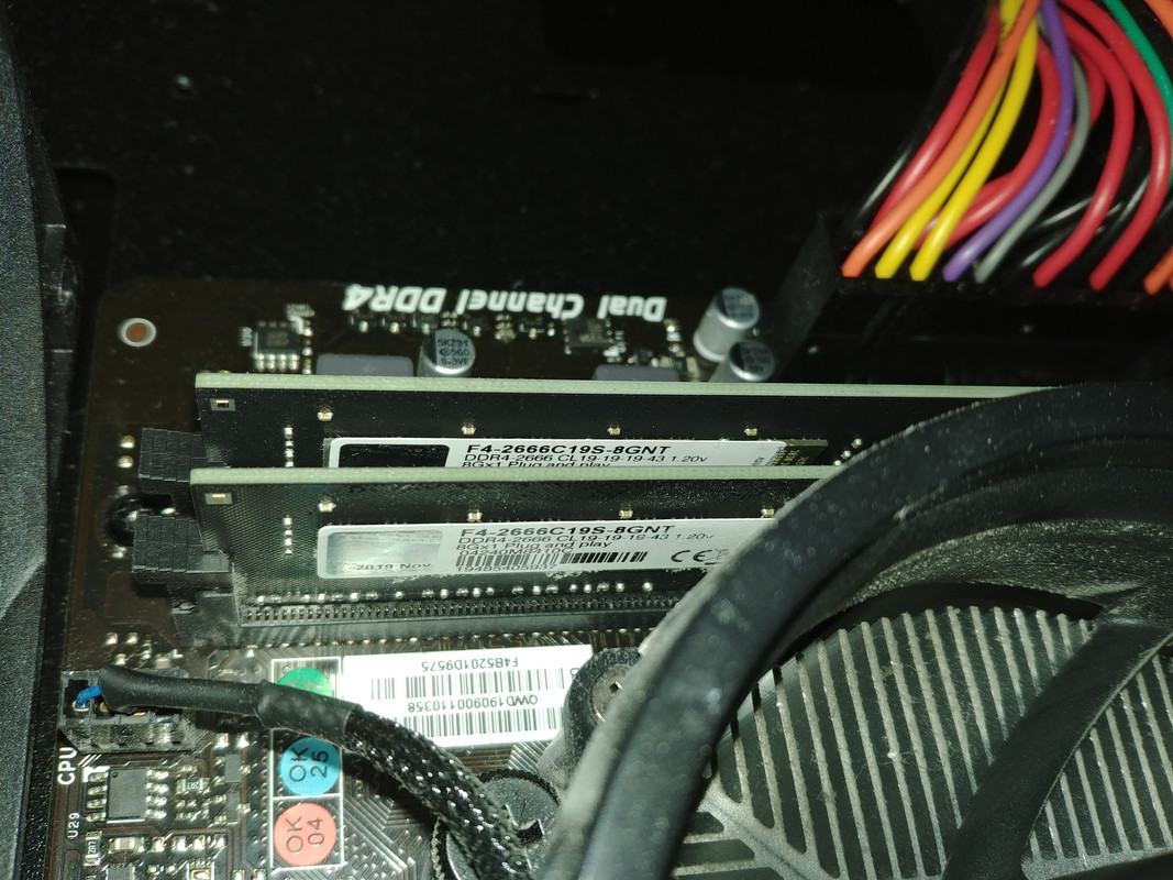

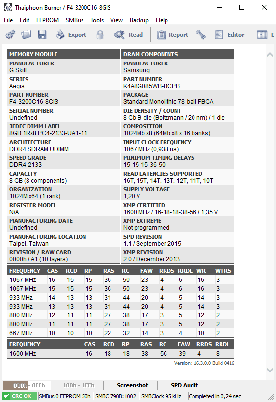

Code endet auf ...10C :).

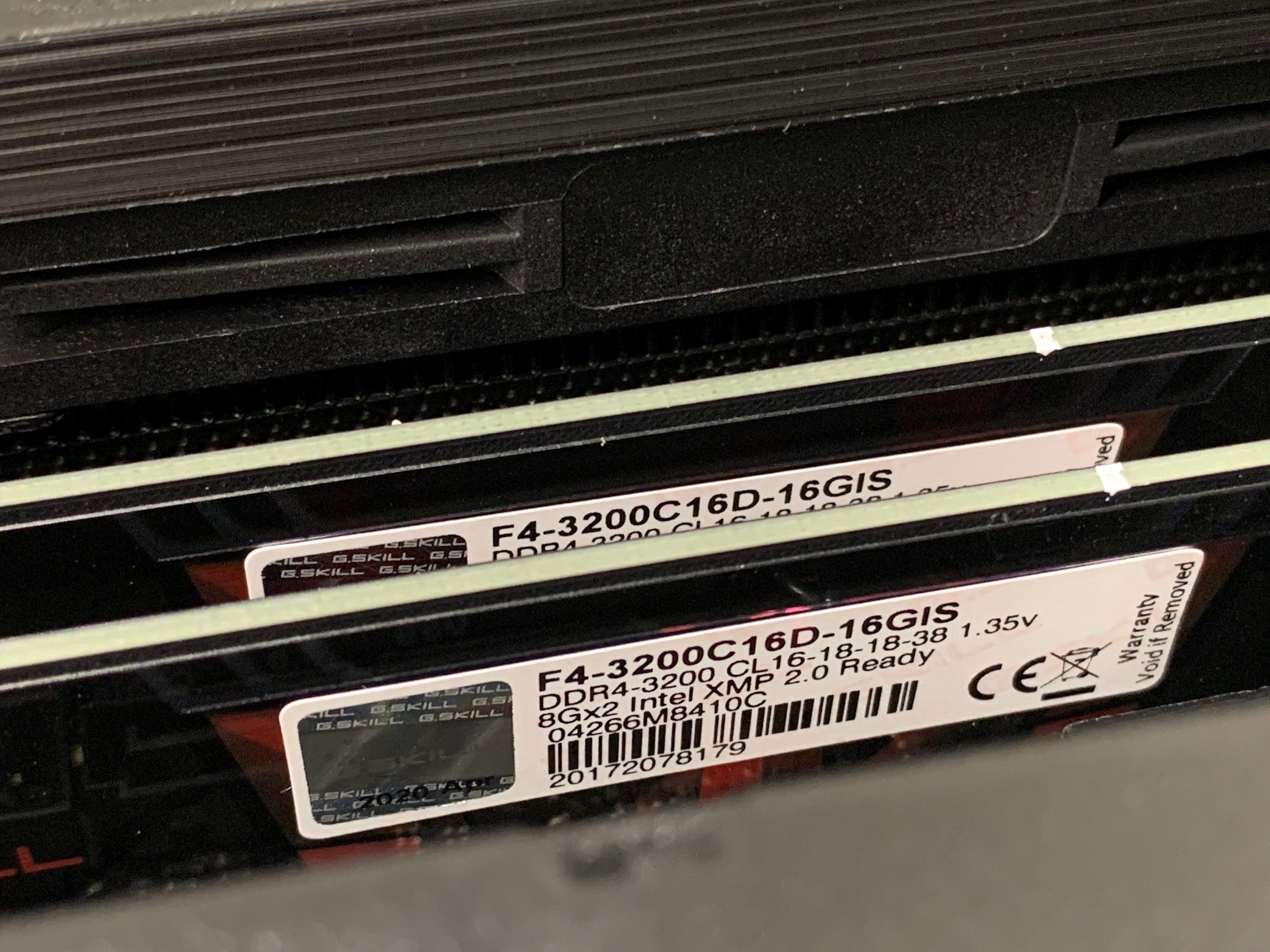

Wird häufig falsch ausgelesen bei solchen Modellen. Die Chance darauf tatsächlich B-Die zu bekommen, ist aber praktisch = 0.
Deswegen mein Kommentar dazu. Das Kit mit 3200 CL16 fehlt noch in der Liste (wenn ich richtig geguckt habe).
Trag ich gern ein, wenn du ein Foto vom Modellaufkleber für den Thread machst :)
