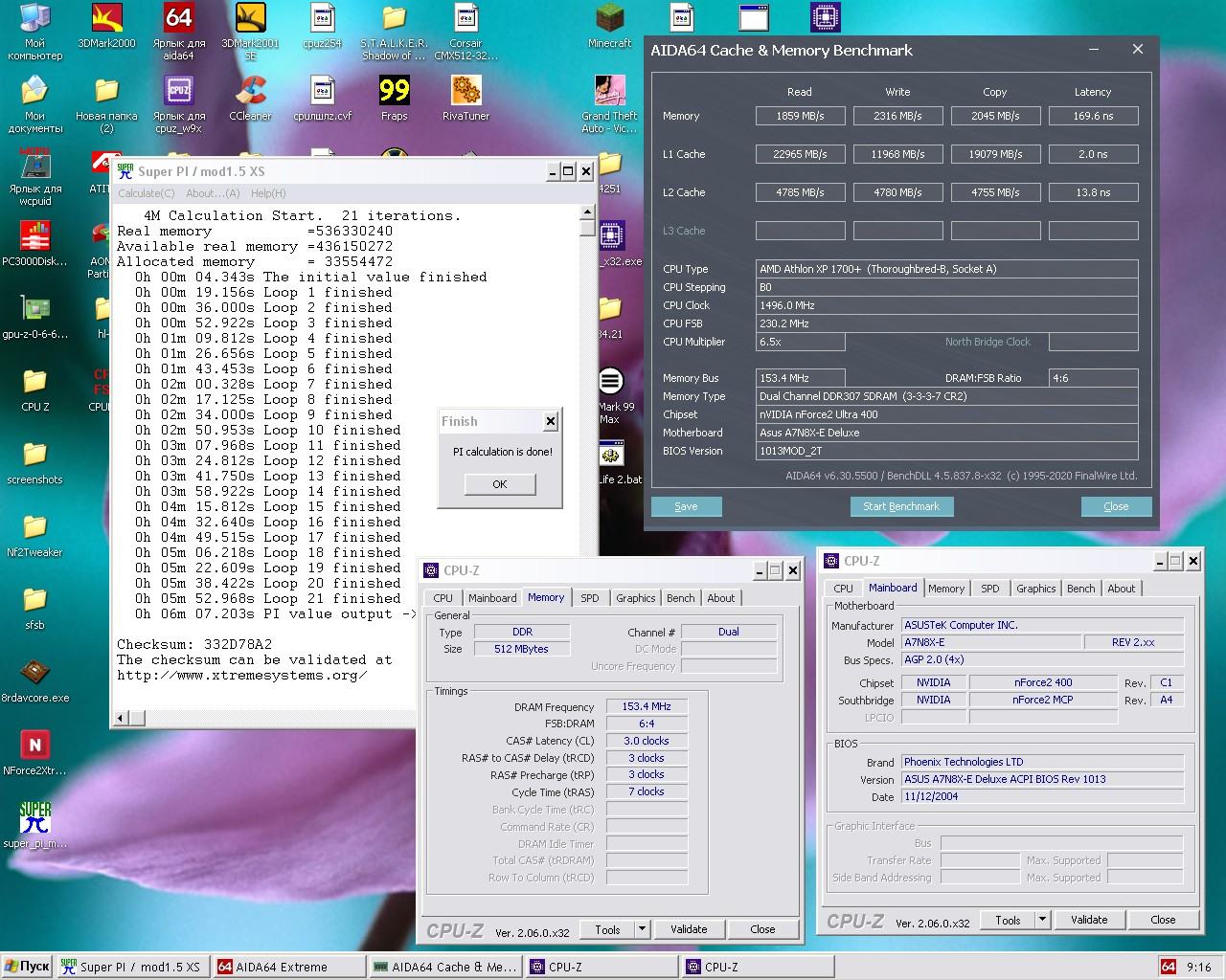

Greetings to all, and especially @Tzk and @digitalbath , could you tell me for what reasons the bios you modified (I tried EBED of all versions for both boards, since I need a romsip from it to achieve maximum fsb) for a7n8x-e deluxe and a7n8x-deluxe rev2 causes hang on boot after "Verifying dmi pool data...
update success" on the Crossflashed a7n8x-x, the bios from these two boards in the version from Trats work fine on my board, the two-channel works correctly. Could you explain why these modbioses freeze and how to fix this? Or just put the "Hynix romsips" from EBED into Trats modbios for a7n8x-e . it s all i need from mod
Maybe it's the APIC (not ACPI) setting? Usually it tries to load the OS after "verifying dmi pool data". I can confirm that all of these bios mods work and are 32M stable on win XP.
I've also noticed that this works, but i'm not sure crossflashing is enough to actually enable dualchannel on A7N8X-X. Yes, it reports DC on boot, but is it actually working? You'd have to run the ram async to FSB (ram slower than fsb like 6:4 or 2:1) to doublecheck. That's a test which is still on my list.
Nope , i changed , and reset esdc/configuration data too) All peripherals (network, sound, ports) are also disabled. 6:4 works fine on Trats bios , Vnb 1.57v.

Did you change a setting in one of my mod BIOSes? My guess is that a non workable setting is causing the freeze. But I could be wrong.
I would try one of the newer BIOSes (named with a B2 or a B3) like the EB-3 mod BIOS. The older BIOSes should also work, but the romsip preset (with memory names like Hynix) didn't work as intended. As far as I remember the preset "Winbond" is one of the few that might help.
Try to use higher alpha timings for a higher FSB frequency.
E. I am currently not at home. So I am not able to mod a BIOS for you now. :(
Yea , i try any romsips and 2 different start fsb (133 and 166) . alpha timings setted as 6-6-6 , all peripherals are off. On original X-E all works fine with Hynix sips (i have both boards). B2A tested too and has no difference. On original X-E all works fine , on crossflashed X-X - freeze , single-channel and 6:4 tried too
Do all additional settings at "Auto" work? I want figure out if the option Rom module in the BIOS is causing the freeze. The option Rom module has the code for the "new" BIOS settings. This module is the last module that the BIOS loads just before the system starts to boot from the os.
So, the option Rom is not the problem here. I guess the problem is caused by the Bios version. I used the latest official Bios (or beta) version for the mods. As far as I remember, trats mod BIOS uses an older official version. Maybe ASUS changed something, that causes the error after crossflash?
Maybe worth to try trats BIOS and change the romsip values in Windows with a tool?
The romsip tables in the NF2 BIOSes consist of two parts. The first part is IMHO mainly for the NF2 / memory Controller and the second part lists the CPU FSB timings for every Multi, aka SIP timings.
In the tweaker you see only the values of the first part. We are able to change this values onthefly. So the changes will work.
The SIP values from the second part are loaded during system start. We can not change them after the start, but since we know where they are stored in the BIOS, we can mod the BIOS with the SIP values we want.
The EBED romsips do have the "EB" values in the multi tables (second part). They're slower then the tables from trats BIOS. I am not sure how far the slower values will help in OC. In my opinion, the first part of romsip is more important for FSB OC.

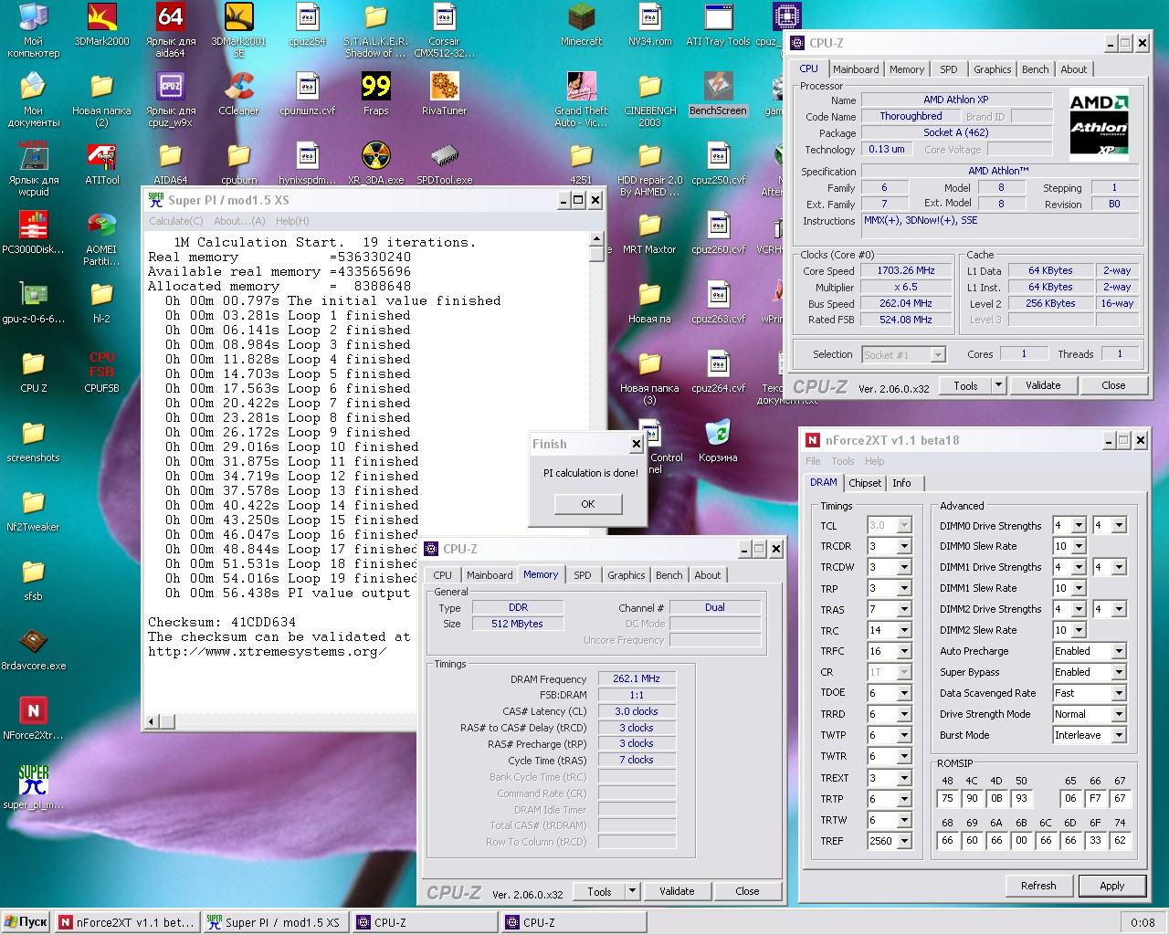

I'll also check what you reported when i got a bit of spare time. Regarding the FSB, try setting the timings to 3-4-4-8 or 2.5-4-4-8 for BT-D43. These need very relaxed timings to reach high clocks. 262 at 3-3-3 is quite good for these chips. Also keep the FSB at or below 263 in bios and use clockgen to reach 265+... At least my boards refuse to boot reliably at 264 and above. I usually boot at 250-255.
I booting at 230fsb and up to 260+ using tweaker , 265 and 268 works but memory unstable (spi1m possible a bit randomly , hwbot prime 32m stable , 270+ cause freeze) , timings 3-4-4-11 tried but not help , much Vmem too (3.3v)
