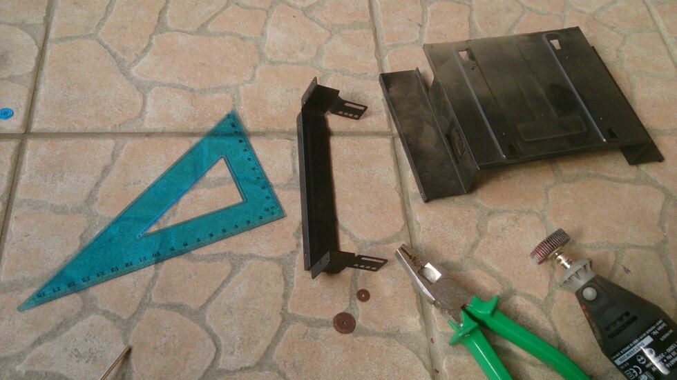

Jo, mitm Dremel ;)
sent by HTC Sensation
