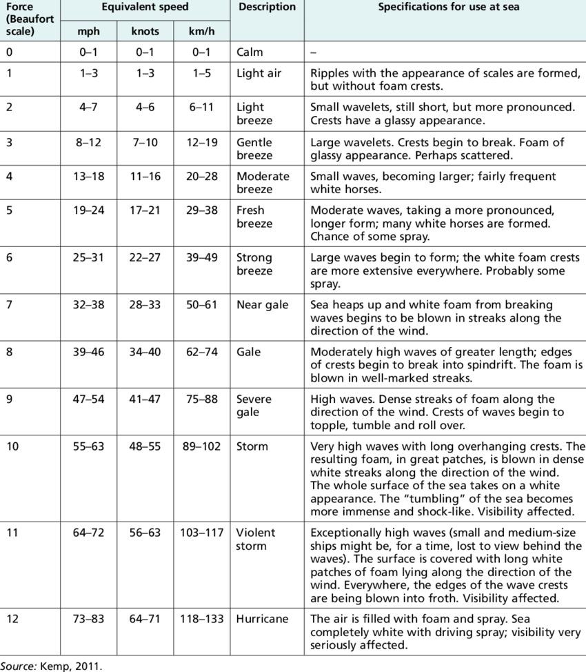

Theoretical calculation, Mora neglected the "whistle" of the lamellas, as well as the rustle of the blades, let us refer exclusively to the "exhaust" into the wall.
Have: Mora 420 (475 * 430 mm), wall mount (430 * 30 * 30)
There are two strips, the effective side of the "outlet" of air with a cross section of approximately 430 * 20 mm (not 30, since the rib is approximately 10 mm thick + one of them is shorter than the other, we will round minus the mounting pads with a height of 30 mm), we get 430 * 20 = 0 , 0086 m2, two of them are vertical, respectively * 2 on both sides ~ 0.0172 m2
The other two sides of Mora (free from fastening) = 475 -30 * 2 = 415, the distance to the wall is already 30 mm, we have 415 * 30, respectively * 2 on both sides ~ 0.0249 m2
The sum of the cross-sections for the air outlet between the wall and the Mora = 0.0172 + 0.0249 = 0.0421 m2
We take 4 pieces of 200 mm Noctua: 146.9 m³ / h the maximum value for one fan (passport 18.1 dB), but as stated at the beginning we are interested in air
The root of 0.0421 m2 = 0.205 m is the side of a square duct, equivalent to the sum of the gaps between our Mora and the wall.
Air speed at 600 m3 / h (4 noctuas scalded at maximum):
3.97 m / s
14.29 km / h
Air speed at 150 m3 / h (1 noctua spar at maximum, or 4 at low speeds, totaling 150 cubic meters, too lazy to look for graphs for this valve in the network):
0.99 m / s
3.56 km / h
So you can see the The Beaufort Scale:

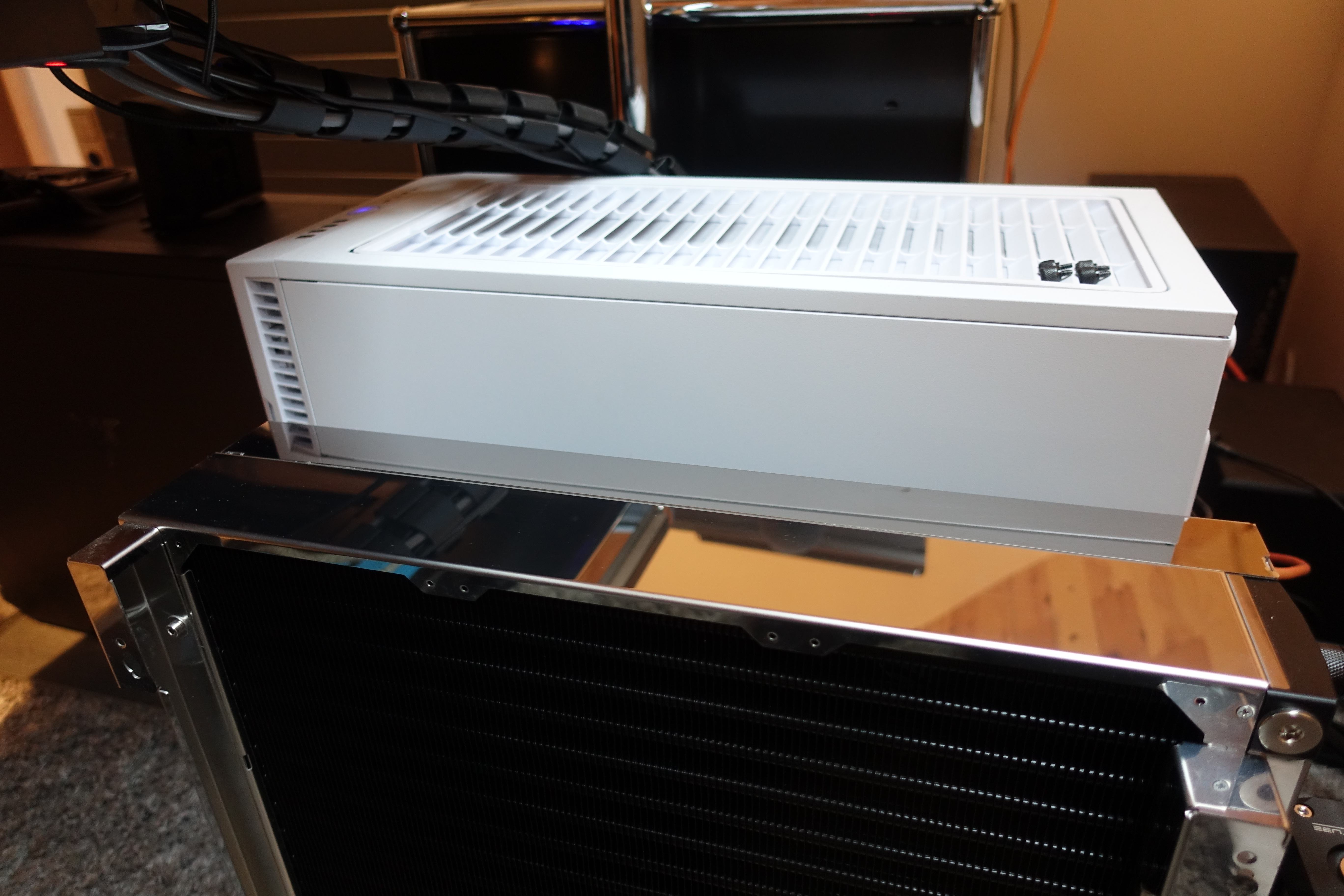

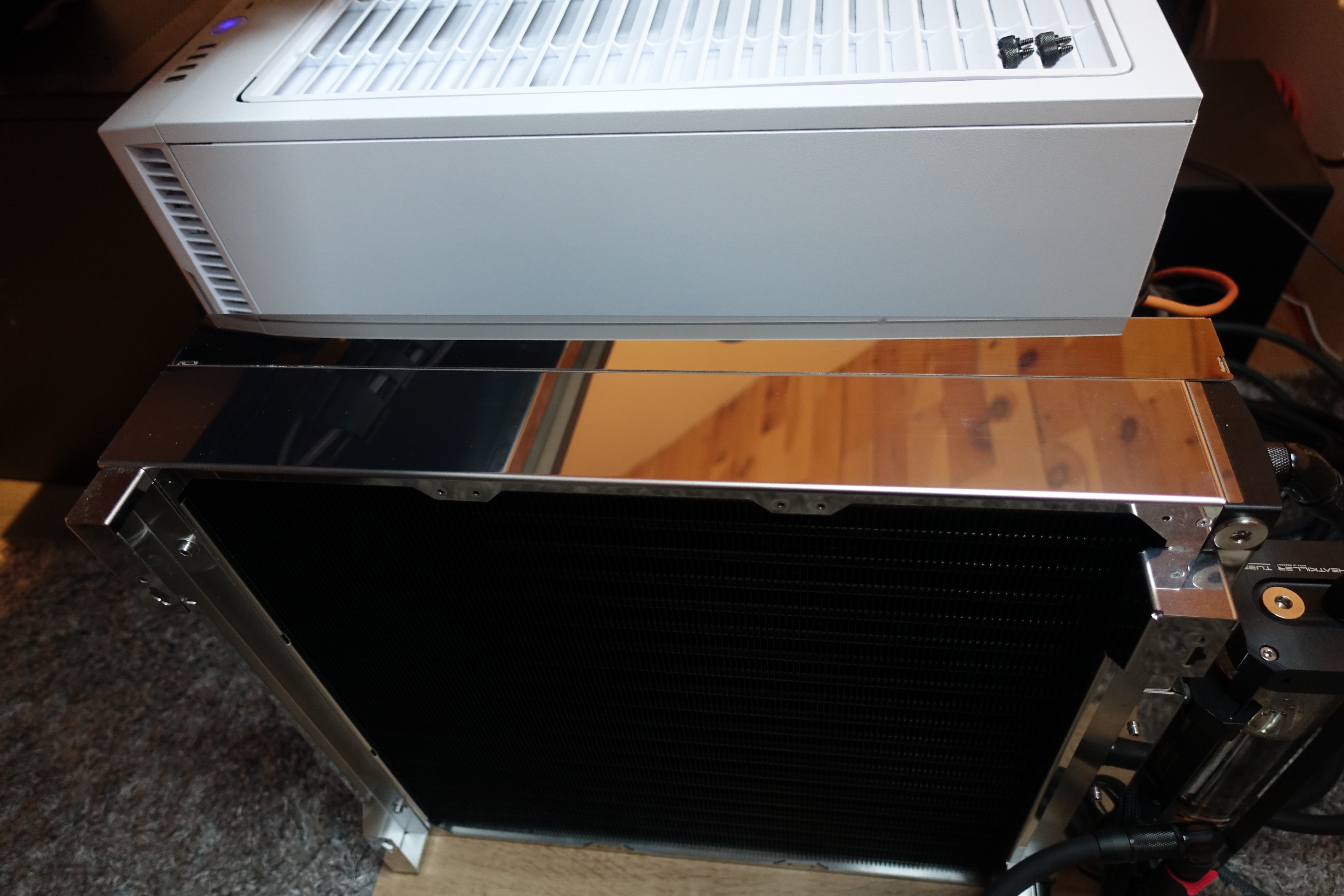

Hat jemand hochauflösende Fotos vom Edelstahl? Das Navigieren in dieser Diskussion war mit meinem langsamen Internet schwierig. Auf der Website sieht es schön aus, aber ich glaube, es hat eine sehr spiegelnde Oberfläche, die ich nicht glaube, ich würde es mögen, wenn es vor mir ist. Leider scheint es, dass meine einzige Möglichkeit, den schwarzen MO-RA3 zu kaufen, direkt von watercool ist, da sie der einzige Verkäufer mit vernünftigen Versandkosten nach Ozeanien sind.
Hab mal zwei Bilder gemacht ... spiegelt natürlich schon so, wie auf Hochglanz poliertes Edelstahl eben spiegelt 8-)
Sprich Du siehst jedes noch so kleine Staubkorn darauf ...
Anhang anzeigen 687680Anhang anzeigen 687681
Vielen Dank an diejenigen, die mir die Fotos zur Verfügung gestellt haben. Es ist faszinierend, wie schön der Edelstahl auf einigen Fotos/Lichtverhältnissen aussieht, aber sehr enttäuschend und knallig auf anderen. Normalerweise bevorzuge ich den industriellen Look und die Langlebigkeit von Edelstahl, aber für mich sieht es ein bisschen zu glänzend aus. Es scheint, dass ich keine andere Wahl habe, als mich zu gedulden, bis die schwarzen Geräte zurückkommen. Es ist schade, dass es keine matte oder gebürstete Edelstahlversion gibt.
