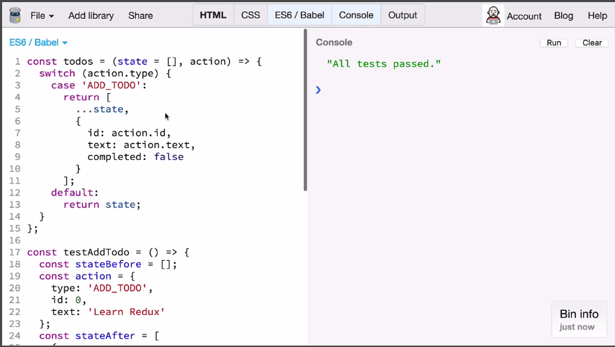

https://egghead.io/lessons/javascri...ling-a-todo?series=getting-started-with-redux
Weiß jemand welchen Online-Editor das ist?
