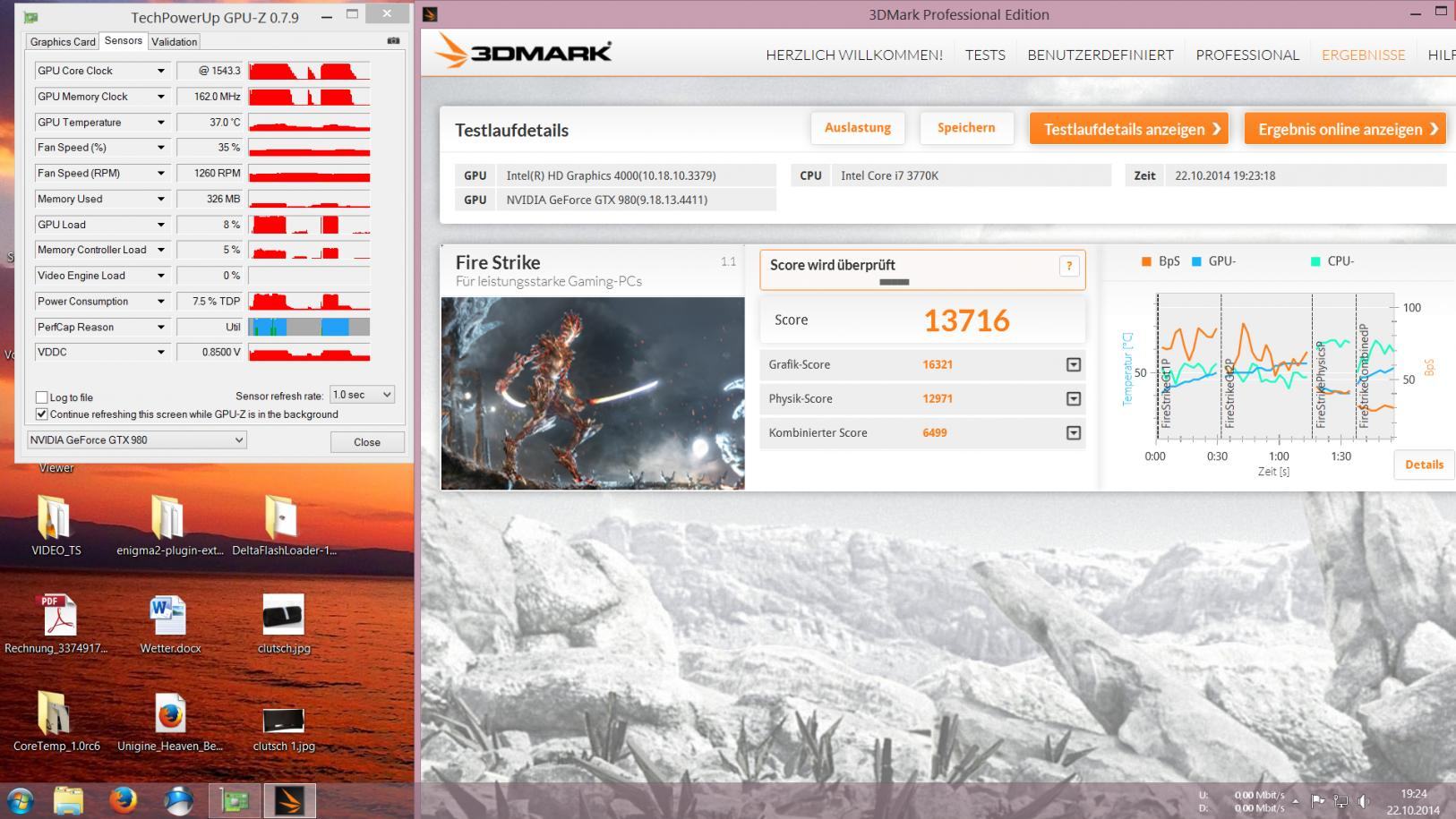

didi2112 │ Firestrike │ 13716│Inno3D iChill GeForce GTX 980 X4 Air Boss Ultra│ 3770K@4.9ghz │1544/4000│1.218V/win8.1 │ ASIC 75% │ Lukü│24/7

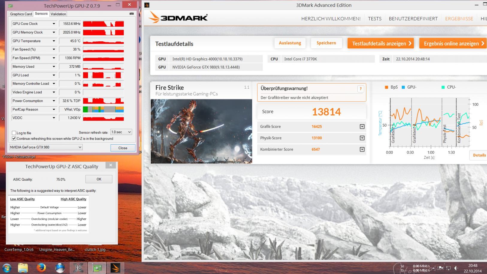

didi2112 │ Firestrike │ 13814│Inno3D iChill GeForce GTX 980 X4 Air Boss Ultra│ 3770K@4.9ghz │1553/4050│1.218V/win8.1 │ ASIC 75% │ Lukü│24/7
Neuer Treiber !
