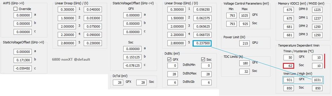

Curves seem only to trigger and fail boot with the Temp_Dependent_VMIN flag
Without, the linear drop doesn't appear to do anything. Static voltage offset functions too
The most crucial part is matching 4 as that is what should match to default boosting - 5 is then peak boost
In my opinion the Linear Drop clock is working with FRC (FPS-Limit)
It should be safer to use higher values in state 1+2, then economic values in state 3+4 if the chip is good enough
for that, and probably the state 5 could be set like the maxTDV-value.(minGFX+LD5=maxTDV)
(in my case with only small Voltbump in TDV)
In the result there is a higher V/MHz-ratio between state 4+5, ... with some MHz more the volt bump faster=safe
i hope so
but surprisingly
the LD volt is not the low border for the effective volt in the FRC usecase, i have seen lower effective volt yet (x)
therefore everyone has to test in some games what is really working
(x) effective volt can go lower then minGFX!?
edit: the artefact problem may be depends on the SOC volts and vram VDDCI
also
RaceOwl in the UVing thread says, that with too low SOC volts the performance sucks.
You have to find the best value with no artefacts and a little bit lower SOC volt = good temp.
For Enthusiast OCer may be SOC volt must be higher then default if they use very much higher GFX volt with
the TDV tweak.

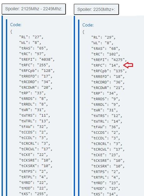

Do you guys think having more than 2150 mhz memory clock will be possible with xtx cards in the future?
Das muss @Sylwester. für uns rausfinden. :)
Wenn ich sehe, dass Karten wie Holzis @LC-Bios mal eben 2400 FT2 akzeptieren, ohne mit dem Speichercontroller zu zucken, sollte das ganz oben auf unserer Prioritätenliste stehen. Falls es überhaupt eine Chance dafür gibt.
Da beim LC-Bios die Timings anders sind, ... ist evtl. das FT2 ungefähr eher so wie FT1 bei der normalen 6900.
und
Wenn Sylwester evtl. in der Registry mehr Takt reinfuddeln kann, wäre die normale XT sicher gar net viel schlechter.(x)
(falls Das geht, wäre Es natürlich nice to have als 1-click im MPT)
(x) evtl. steht in manchen Bios´aber oberhalb Vram 2249MHz nur Quark!
(würde ich als sinnvolle Obergrenze ansehen, Was man mal versuchen könnte)
Ich suche mal die Werte vom ollen Bios, wait a minute.
Wäre interessant wie ne normale XT dann mit 2249@Standard Timing dann so läuft.
(FT1 wird evtl. too much)
