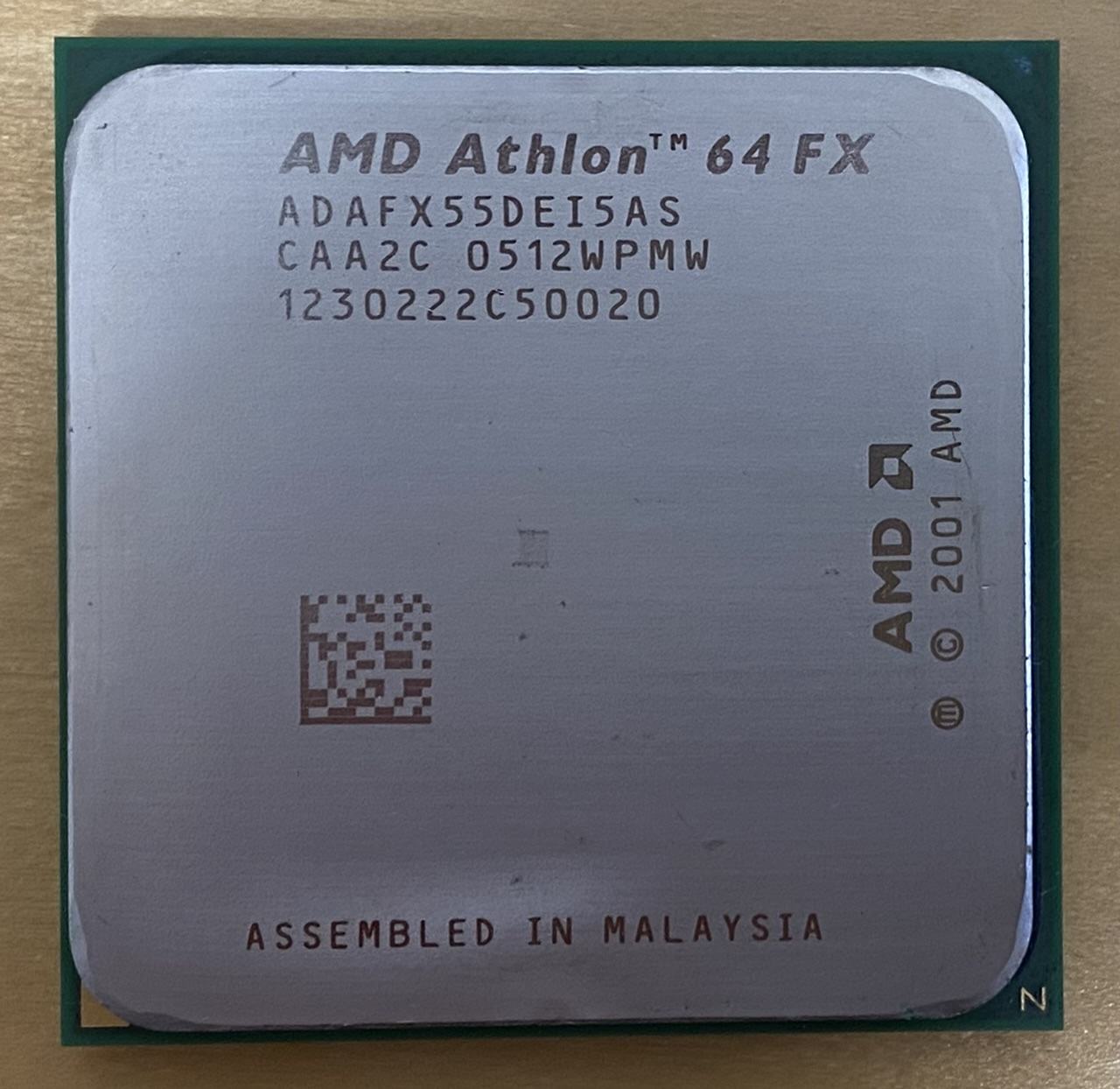

New in, a late Clawhammer FX-55
Edit: Does anybody know up to when they were made (Clawhammers)?
Sehr sehr spätes Stepping. Die Clawhammer für Sockel 939 waren im Zeitraum von Juni 2004 bis Mai 2005 (laut Wikipedia). Mein ältester 939er ist aber 0408 und der jüngste ist 0519. Kann also mit der Angabe nicht so ganz hinhauen.

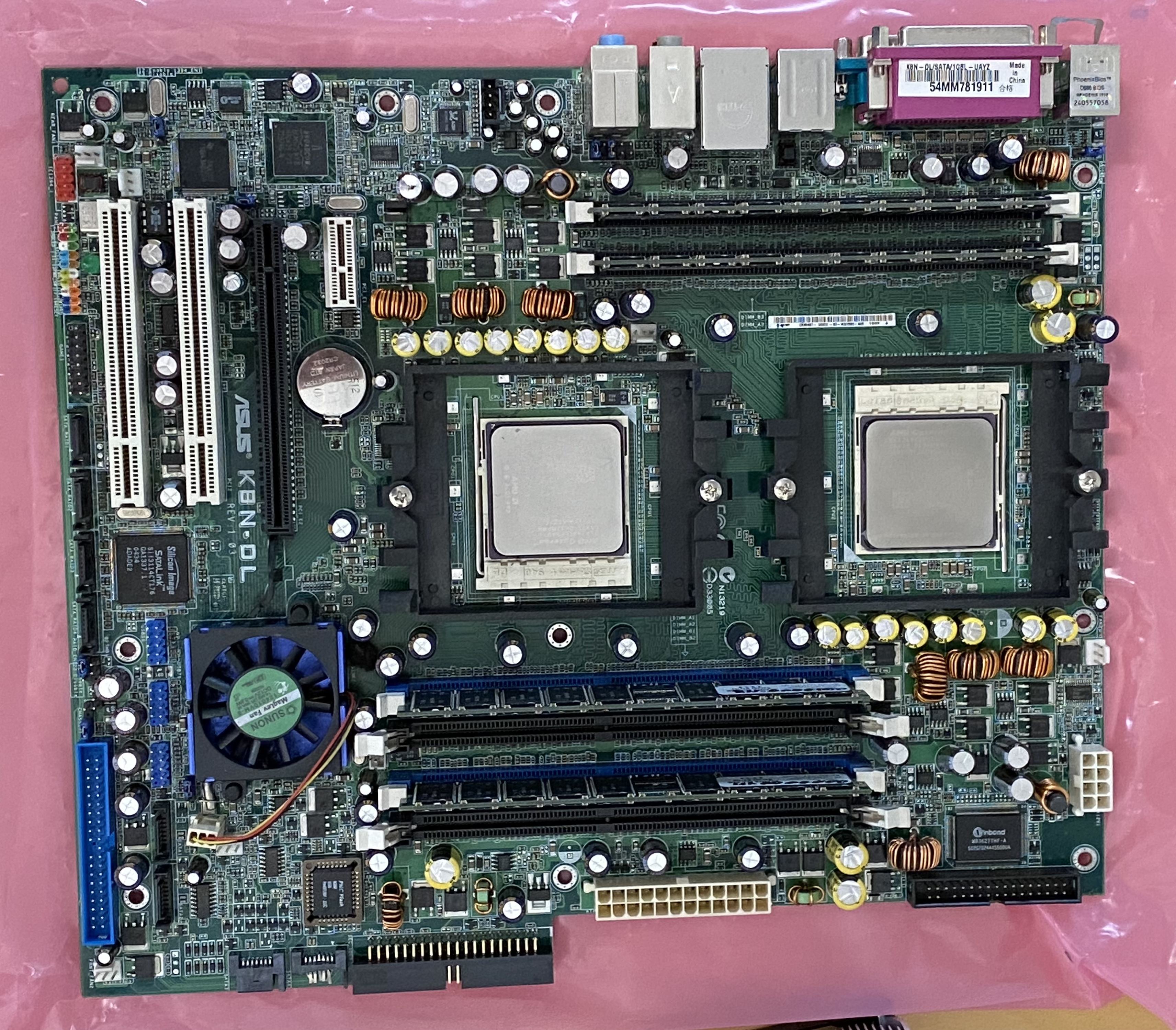

Mal ein neuer Opteron ... Headspreader ziemlich used, aber das vergrößert ja die Fläche zur Wärmeabfuhr 😆
Kurz auf nem A8N-SLI Premium getestet - läuft.
nice, but a broken SATA port. It seems like it shorts something. Probably worth to look for it before using it?
Also nice Micron dimms. 5B-F in GB sticks?
edit.
I like the green PCB.
Thank you for noticing the SATA port as well. I noticed it too. I removed it partially so that it can cause no further issues.
I have to look at those dimms but they should indeed be 1GB‘s.
I think I fixed the NB fan as well, that was not running because of dirt (I didn’t need to turn it on to notice…).
I removed the old thermal paste was as well.
Yes that fan was not connected because I was just planning to fix it. It runs now, a little noisy but working.
The motherboards gives a post so I think this will leed to a succes.

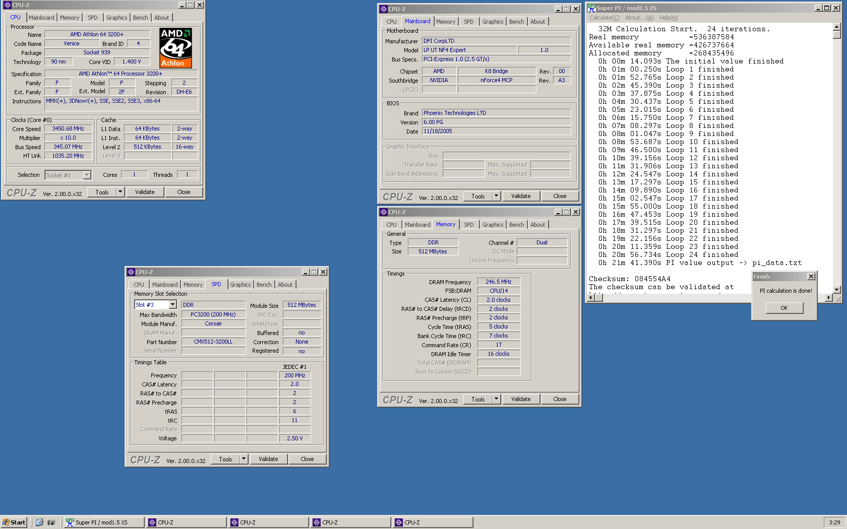

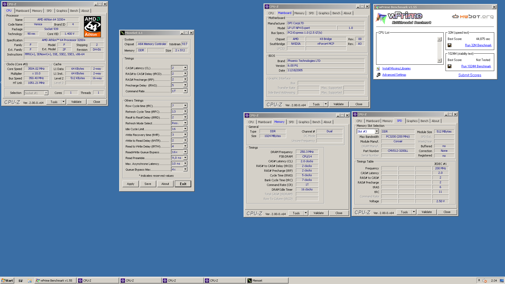

That is for the results. Every line a different speed or bench result. I just gave them a few lines in advance.

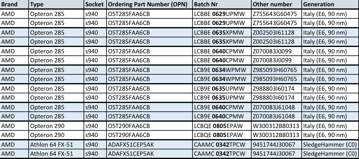

The other cpu’s are 6x 280 (LCB9E) and 4x 275 (2x CCB1E, 1xBW and 1x BB).
Those CCB1E are 0002 and 0020 ending ore something like it (0002 is 100% sure).

Also that K8N-DL looks nice. I always liked the greenish simplicity of server grade boards :bigok:
