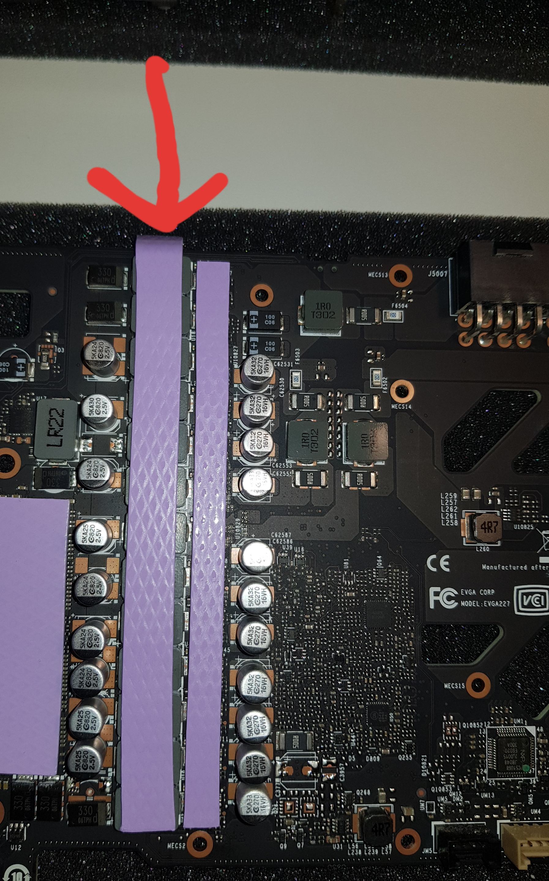

Hello. I received the thermal pads of the coils narrower than the coils. Was it an error in the delivery of watercool? Can I use those thermalpads or should I replace them with ones that cover the entire width of the coil?
Thanks for the help
