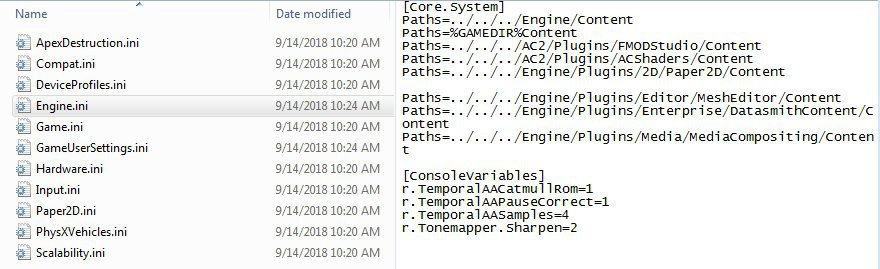

Thankfully the UE4 sharpening edit works with this game. :: MXGP PRO General Discussions
All Milestones UE4 games have been a blurry mess so far, with Gravel being the least blurry, but still blurry to an extent.
This happens because of TAA anti aliasing which is a great anti aliasing to get rid of jaggies, but blurs the image quality, which is why most devs add a Sharpening filter in the graphics options of their UE4 games, something Milestone dont do ofcourse lol.
Anyway follow these instructions, and thank me later lol -
Go to:
C:\Users\YourUserName\AppData\Local\AC2\Saved\Config\WindowsNoEditor
and edit:
Engine.ini
Put this in file below everything else-
[ConsoleVariables]
r.TemporalAACatmullRom=1
r.TemporalAAPauseCorrect=1
r.TemporalAASamples=4
r.Tonemapper.Sharpen=2
You need TAA set to 'High' ingame for this to work properly.

Hier könnt ihr die Shader Schärfe ändern, ist viel besser jetzt :)
Playing around with sharpening settings that I found from UE4 forums, if you want to test these put below values to engine.cfg that is located at C:\Users\username\AppData\Local\AC2\Saved\Config\WindowsNoEditor
[SystemSettings]
r.DefaultFeature.AntiAliasing=2
r.TemporalAACurrentFrameWeight=0.2
r.TemporalAASamples=32
r.TemporalAASharpness=0.8
r.Tonemapper.Sharpen=1

excellent this has helped alot :cool: There are many functions that can be explored. Here is a list:- UE4 Console Variables and Commands

Hmm.
Bei mir gibt es da nur eine "engine.ini", und da steht eigentlich nicht viel drin.
[Core.System]
Paths=../../../Engine/Content
Paths=%GAMEDIR%Content
Paths=../../../AC2/Plugins/FMODStudio/Content
Paths=../../../AC2/Plugins/ACShaders/Content
Paths=../../../Engine/Plugins/2D/Paper2D/Content
Paths=../../../Engine/Plugins/Editor/CryptoKeys/Content
Paths=../../../Engine/Plugins/Editor/MeshEditor/Content
Paths=../../../Engine/Plugins/Enterprise/DatasmithContent/Content
Paths=../../../Engine/Plugins/Media/MediaCompositing/Content
Oder muss ich diese engine.cfg Datei erst erstellen?
