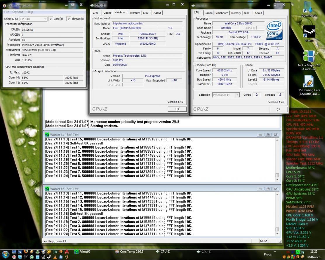

e8400 | 4050MHz | 1.168v | FSB450 | DDR2-450MHz | Abit IP35 | WaKü | - | Tray | 1,2125v | -McGyver
