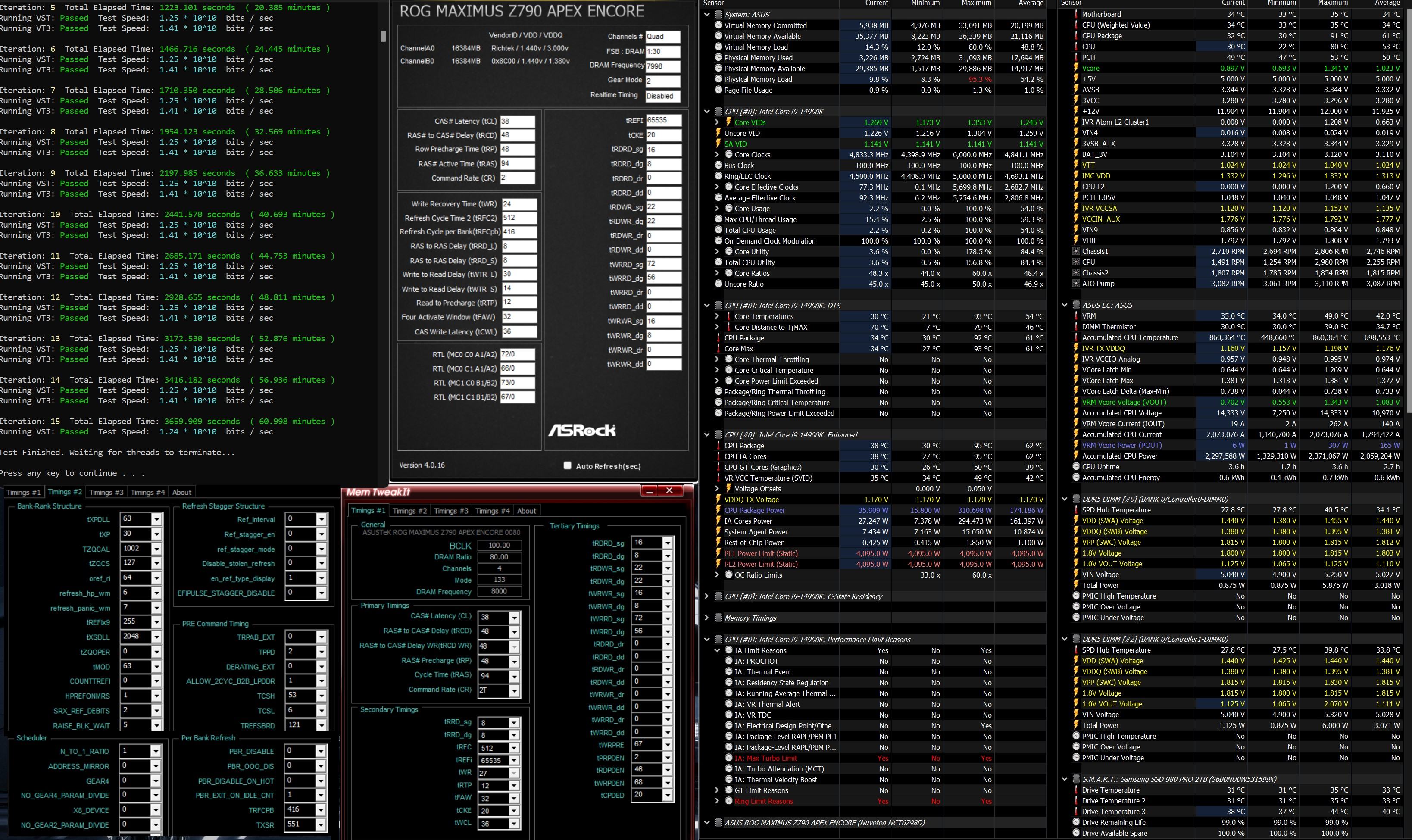

Naaah, #0 came due to increased strain OR because you had PD timings on auto.
Good finding and time to resolve.
As for what cant keep up on y-cruncher ~ thats a long long topic.
10 is no need.
It will mess and desync writes from reads.
They already are separate operations, but we set RRDS as 8. CCDS as 8
Keep short jumps at 8nCK (failsafe).
Changes there mess with RDRD & WRWR timings.
Too big of a headache.
WTRL is a cpu management part.
Its on it to manage when to do writes within both MC-Links.
Its not memories work,
Memories work is to allow writes at "anytime" within exceptions
Exceptions are not when reads happen and only between Signal Hi or Low.
Soo right in the middle, up to what type of operation has happened and does happen
Right in the middle. Hence alignment exists. But that one is more important for reads and their potential terts.
Writes only shouldnt bother reads and happen whenever. Optimally timings finish and start clean, not cause a halting condition.
This all is called "alignment tuning". Its not about how high or low X single-timing is. :-)

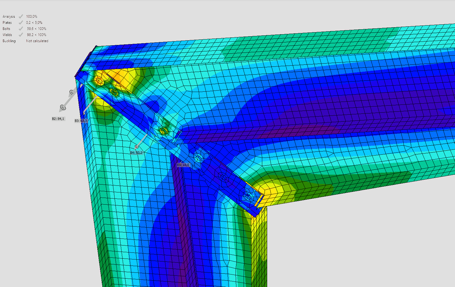

It's welded from hot rolled profiles. It's a small one, I have much bigger projects, but those cannot be shared.:geek:
I worked on some huge projects in Norway too, these smaller ones are not challenging like them, but with a family I don't want to cooperate on those anymore.:)
I can use the extra computing power from my OC during the FEM analyses.
Designing the basic static calculations in AxisVM and then starting modeling in Tekla Structures, during the modeling I do the FEM calculations for the connections and details in in IDEA Statica and when it's done we do the workshop and erection drawings in Tekla.
It's a back and forth work, like mem OC, the difference is that I know why I am doing the things in my job, but in mem OC I am just starting to understand the things. I wanna know how it works, because that's how my brain is working. :)
For small projects it's easy on bigger ones we need a lot of meetings and discussions.
Naaah, #0 came due to increased strain.
Yeah, but that was on 9901 BIOS.:d
I see, but what's the point of trying tWRWR_dg on 12?
It's on it to manage when to do writes within both MC links.
It's not memories work,
Writes only shouldn't bother reads and happen whenever. Optimally timings finish and start clean, not cause a halting condition.
This is all called “alignment tuning”. It's not about how high or low X single-timing is.:-)
I will change it back to 8 and check it again. It was 8 in the past, just now I tried it with different values. I think I still have some spare performance in the 8533 profile, so needs further testing.
8600 is still waiting for me, but I will start it with C36 too.

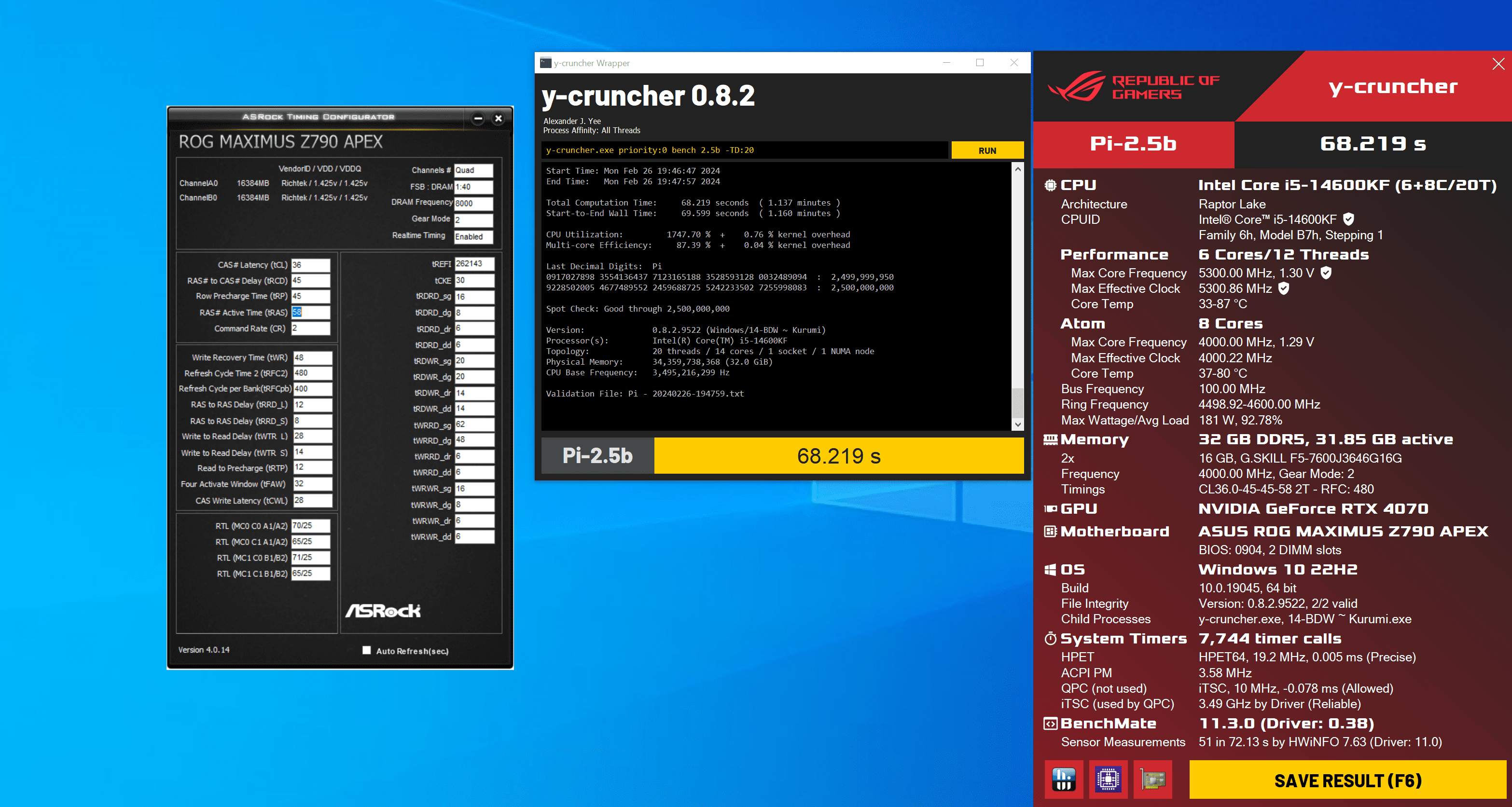

To isolate issues
For me to see if its a min/max overlapping issue
~ or it has nothing to do with the writes and link drops-out because of other variables like something ODT based again changed and your voltages are off.
Thats why the two tests
One to see if it overlaps due to slow WTRS and one to see if they again changed things around internally.
As defaulting to such low WTR_ , will cause issues unless reason was careful design.
Its since 2-3 bioses that way and you mentioning "lowering them back to Auto caused that #0"
10K Gear 4 is waiting too :P

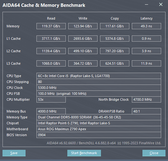

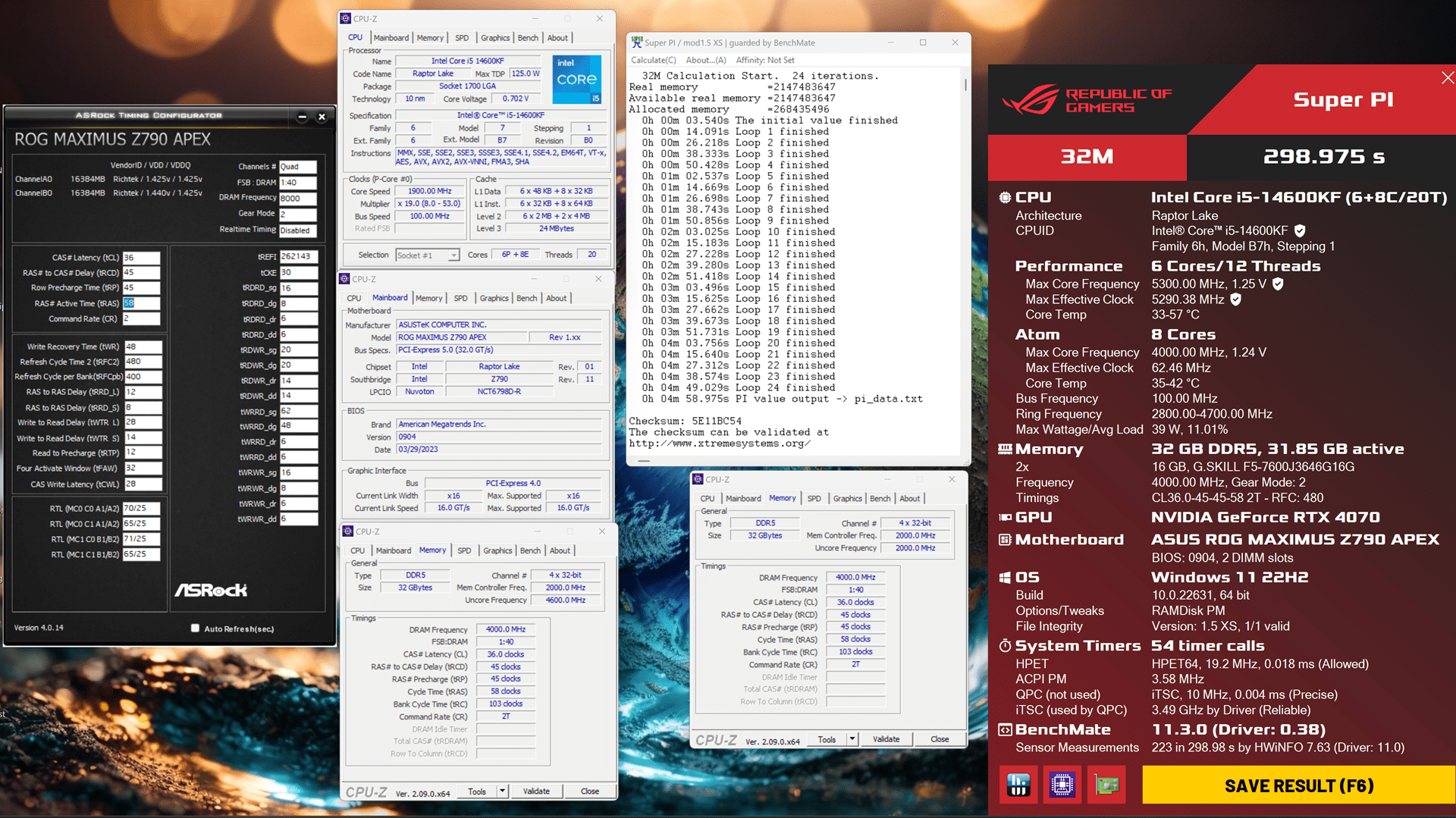

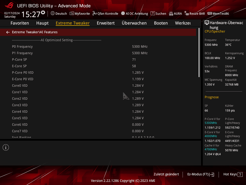

  • 8000C38
  • VDD 1.44,
  • VDDQ 1.38
  • SA 1.14
  • VDDQCPU 1.17
  • VDD2 1.35 set / 1.296 under load
  • VCCIN AUX Auto
  • Since I had crash problems with VT3, and from what I read it is sensitive to Ring/Ecores, I set an offset of 0.05mV to L2 CPU to 1.2. And, I set IVR Transmiter VDDQ ICCMAX to 12 (this doesn't limit anything from my tests, the maximum value is 15 for 4A although below it says 511Amp, so for 420 it would be approx 12, but don't notice a cap), also set Unlimited ICCMAX to Disabled and CPU Core Cache Current Limit to 420 (this was the key), because it allowed me to run VT3 even at 310W without reaching thermal throttling 298W (VST)/310W (VT3), without hitting thermal throtling
  • Use your TRFCMini spreadsheet to set the powerdown values (very well explained in several previous posts here)
  • SPD HUB VDDIO to 1.1V
  • DRAM VDD/VDDQ Switching Freq to 1.5 and DRAM Current Cabability to the max (7.85)
  • RTLs R3 to 7 set to 0 and in tertiaries dd/dr set to 0 also
  • And most importantly, RTTs as you had taught me, 48-34-34-34/240-0-0/60-40-40 with RON 48-40/40-48 and Ctl0DQVrefUp/Dw. From what I read, lower SA values allow or have stronger ODTs. I had understood that for low voltages, perhaps 40/34 was appropriate.
I'm a little concern of cold retraining. I did several tests always turning off the PSU, even changing the BIOS to the secondary. This is the first configuration I've seen that doesn't fail before 1hour. I'll try later today to see if I don't have a YC error on the first boot. TM5 never caught any errors with these timings or voltages, even without training well and failing YC.
Isn't the MC set at 1.35 very low? My VF reaches 1428 and starts very low (P114E88) For now, without claiming victory, it would seem fine!
We'll see if the reboot allows it (later), so I have a good foundation to grow on.
Thanks!

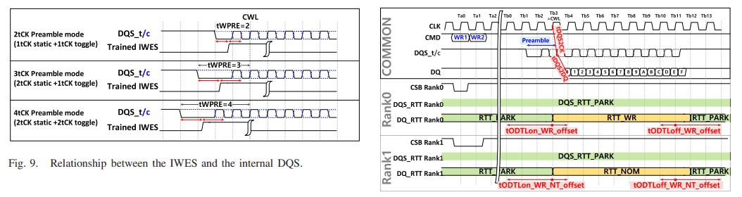

22-22 means RDWR_?
Ye must be
22-22 is ok. Its a long topic i'm not master yet
Its a topic with WPRE, Preamble delay, DQS offsets and tWR
Its mathematical confusing. Basically lower, much more perf but limitations are complex.
1N vs 2N is factored in and ya. Better stay on spec which is 22.
But they will not be a cause of #0.
They might be a cause of other issues like #7 or annoying #8.

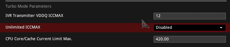

Ahh maybe a sidenote
There are several ICCMAX.
Ring has own
IA supply has an own
GT has an own
And i dont know about VDDQ ICCMAX, but it likely can stay maxed. Although i dont how to track it really.
I think ASUS Worktool doesnt list this - maybe , been some time now.

ICCMAX is more of a transient and substrate limiter than it is anything else.
Its good to have it set, but if you have no margins, it absolutely will ruin your higher clock and usable raw performance.
Soo i see why it is at 510A on OC boards, even if this definitely does damage CPUs.
We are just an exception and a little % of the actual userbase.
I don't like myself that its silly silly high. Even 400A is silly high but Intel™ says its fine within some reasons.
VRMAX for example defaults to near 1700mV too, instead of staying at 1550mV peak.
Just an OC board, thats all.

22-22 means RDWR_?
Ye must be
But they will not be a cause off #0.
Yep. Now it works with 21/21, but long test awaits. :)
When I have MCH Fullcheck on with 20/20 I can't even boot. So 19/19 what we see on OCN is fully no bueno if you follow the rules.
This is so freakin complicated. :d

That might explain some things why i and colleague could never run MCH Fullcheck
But why does this happen.
Does fullcheck mess with signal alignment vs ASUS own defined values.
ODTOnLatency duration is a mess, but there is DQS_Offset, that goes into this math.
WPRE, i wonder what it defaults too so far.
But ya things improve , thats great. Finally.
OCN sometimes does silly things because we still live in the past. Here and there
"And specifications are slow", you know : ')
No seriously, that's interesting to see.
I wonder why it does that.
Thank you, good find~
If you find WPRE or WrPRE (small r) , you can send it over (memtweakit or ShaminoTool)

You can definitely work on lower WTR_L.
26 is an odd number.
You can try what happens if you run RRD_L as 9 and WTR_L as 18.
Seems CPU/Bios can do WTR_L 18.
Thanks!
Whats the V/F curve of your current 14th gen sample.
Sorry if it got drowned in older posts.
Voltage is just about fine for a non-leaky sample.
Its MC-Link Data (going out) voltage
Its not substrate imc voltage.

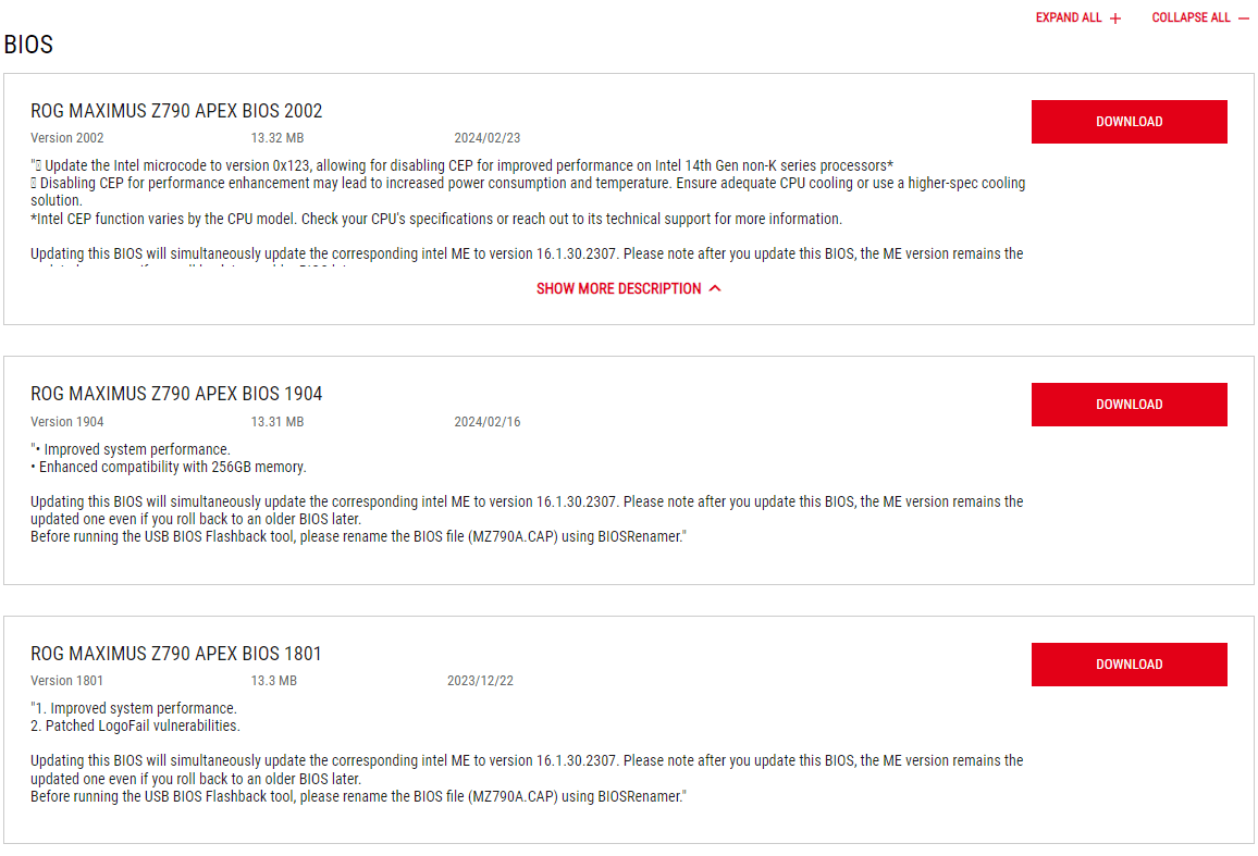

It's a mess. There was a BIOS after the first release which totally different than the previous one and after they reverted to the previous and new release was based on that version.
You can't just change direction totally in developement, because it's an issue for users.

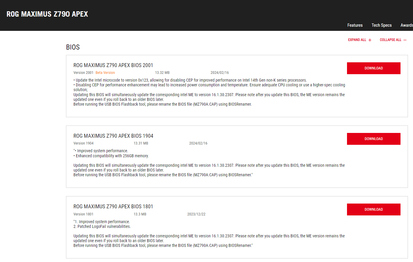

Im happy that its being said on what this testbios even is. Its 1002 based.
Soo testing 1001 vs 1002 is now on you
Why 1001/2001 was taken down, nobody knows.
Its ok, we are past that part too.
Lets just figure out what bios behaves better - without knowing who made what.

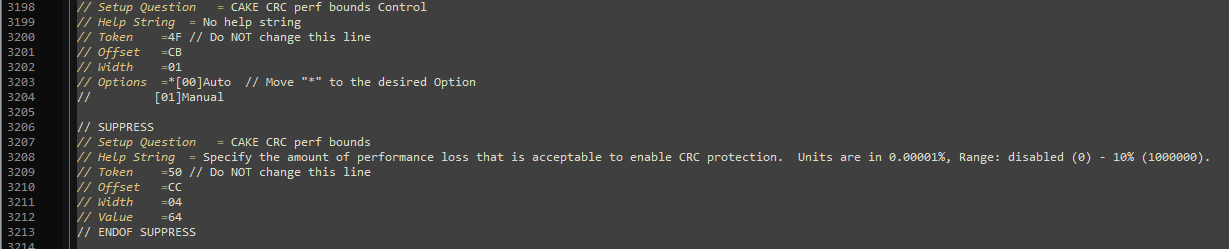

I think i got permission now to share 0081 unlock.
But ppl who mod it, still didnt restore the most important part , which is mem Debug menu.
At least you can fool with some other things like Ring V/F.
Probably figuring out what is a better bios 1001/1002 has priority.
To know what should become the new standard. 9901 is for Gear4 fun, 0080 worked too but ya 9901 is for XOC fun.

Oh hey i found something from Lenovo™ Enterprise solutions ~ its 2023 version, but it should work
Grab SCE from it
Make 3 BAT files
Export.bat
SCEWIN_64.exe /O /S Bios.cfg
pause
Export_Full.bat
SCEWIN_64.exe /O /S BiosFull.cfg /sp /g /ce
pause
Inject.bat
SCEWIN_64.exe /I /S Bios.cfg
pause
Like this:
In Bios enable "Publish HII Resources" ~ near the Boot place.
Its near the Secureboot & Flexkey option.
I think there is also a setup_var lock, but lets see later.
Then export the cfg , may upload it here too
Unused items need // on them
You should resolve all layout issues (some FW Engineers leave a mess in there, same for ACPI) before injecting the fixed config
The tool will warn you if something is unresolved
And so on~
Notepad++ works well for such files, with color-coding of choice.
https://download.lenovo.com/servers/mig/2023/10/24/58577/lnvgy_fw_uefi_xwe160d-1.14_anyos_32-64_tools.zip
Grab SCE from it
Make 3 BAT files
Export.bat
pause
Export_Full.bat
pause
Inject.bat
pause
Like this:
And so on~

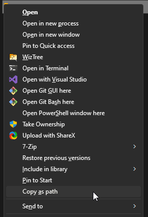

Oh right,
Because this should use low access drivers
Maybe WinDefender Core Isolation & Memory isolation - maybe needs to be off
But you'll figure it out
And maybe you need to run cmd as admin permission and then "cd .." & cd C:\Users\Tibcsi\Downloads\ to the folder path
It works fast if you hold shift + rightclick on the folder & press copy as path
Then you can just rightclick on terminal/cmd/powershell and it will insert the target path
IT-Techtips :d
[TAB ⇆] also works for autofill

ayyy got the day off again - did a bunch of testing this morning mostly on the 9901 bios although wondering should i swap back to 1001 or 1002? I don't seem to have a problem on stability anymore for either of them after fixing my curve a little but seems like so many bios came out is there a " correct " one to use or just whatever works? I see @Veii said that 9901 bios is more for XOC/gear 4
another thing was going through some settings, do you guys normally leave these on enable or disable or auto?
Intel Speedshift
Intel Speedstep
selfrefresh enable (i seen something on this posted awhile ago but lost it in all the pages back, i think set to 1 is enable and 0 is disable but is it needed?, wanna say it was memory related)
2% is a lot when you are on the edge. Even a 10 mV matters, 5W is a lot in this perspective. Especially because this drops from the IMC load.
So, to sum it up, on your “mentored” config you’re getting 1.21-1.23 VT3 @ 8533. Thank you very much. Says it all :)

My 14900KF which I've referred to as a "dud" that can't stabilize 8400 even on Gskill 8400 sticks and never does more than ~1.05 x 10^10 VST/1.1x10^10VT3 all of a sudden does near full bitrate with Y-Cruncher limited to 32GB on my 2x24GB kit.
1.22 x 10^10 VST, 1.41 x 10^10 VT3. Wattage is 10-15W more with the higher bitrate/limited RAM usage.
mm mm
tibcsi now being at 1.23 * 10^10
Something is limiting it. That's for sure
Idk but i think it's ring being too slow, to fully utilize it all
Mal eine Frage. Gibt es für die älteren Bios auch ein ME tool um auf die derzeitige version zu updaten?

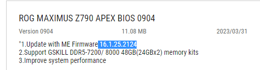

Hintergrund ist das ich auf dem 2. Bios mal die 0904 installiert habe mit dem letzten ladbaren Meupdate.
Mit diesem Bios scheint es besser zu laufen . Mit meinen letzten und nur der änderung der sa von 1,131 auf 1,151 läuft es rund.
Zudem hat sich der SP irgendwie deutlich verändert ohne daß ich bautechnisch was verändert hätte :
Bios 1904 : PCore 71 / Ecore 58 - Sp gesammt 66 / MC SP 63
Bios 0904 : PCore 106 / Ecore 71- SP Gesammt 94 / MC SP 63
Mehr konnte ich bisher nicht testen , außer daß ich zumindest 8400 mal booten konnte. Eventuell geht ja zumindest nun al 8200 ?!
Das ME Update kann auf jedem Bios ausgeführt werden (in Windows)
Die Firmware sitzt auf dem jeweiligen Bios-Chip & hat einen Downgrade lock.
Das ME Update führt permanente Änderungen in der ManagementEngine der CPU aus.
Der SP Algorithmus ist pro Bios Version unterschiedlich und wird stätig nachgebessert.
Das alte Bios ist auf 2124, worin bis 16.1.27.2176 ME, boosting Probleme gemeldet wurden.
https://mega.nz/file/5B12AR5K#fbevQxcuVNd1RA30AUChVMYKEY_8qt_OZeiGIz7pCJk ~ ME 16.1.30.2330 // mit security hotffixes
https://dlcdnets.asus.com/pub/ASUS/mb/03CHIPSET/MEUpdateTool_16.1.27.2176_T.zip ~ ME 16.1.27.2176 // ohne security hotfixes
https://dlcdnets.asus.com/pub/ASUS/...90_EXTREME_GLACIAL/PD_FW_Update_Tool_V016.zip ~ PD Update , für beide Z790 APEX
https://dlcdnets.asus.com/pub/ASUS/...l_PID1A52_PID1A97_PID1996_2023-05-19_ASUS.zip ~ ALC4080 Update , Beide APEX

Auf dem zweiten Chip war das Release Bios + ältester ME Firmware
@Veii : Danke habs Updated auf ME 16.1.30.2330 . Sp ist gleich geblieben. Stabilität teste ich morgen mal (y)
@Silent_H@g : Ich hatte zuvor das 1904. Das 2002 ist Beta. Ich installiere ungerne Beta Versionen. Erstmal checke ich die "Opa Version" :ROFLMAO:
Zum Glück kann man ja per Knopfdruchk wechseln.
2001 war beta.
Beta + 1-2 Wochen keine Beschwerde = Final :)
TestBiose können, eventuell mal, Probleme verursachen.
Open-Alpha gibt es keines mehr.
