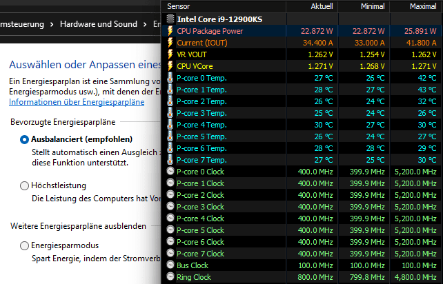

Now I know why so many ohms for AC will massively increase the voltage. U=R x I
. Higher resistance gives more voltage.
Even the BIOS was ultra slow at 1,732 V. I've heard that the CPU clocks down massively with that much voltage. That's probably where it comes from.
Still, I think it sucks from the Asus board that it doesn't warn. Values exceeded by a factor of at least 60, but values remain white.
Could someone please answer my remaining questions in post 4027?
I am particularly interested in why the CPU is still alive and whether other components have also been damaged in terms of voltage.
Does the AC/DC load line really only and exclusively affect the Vcore or will the VRMs of the mainboard also be affected?
