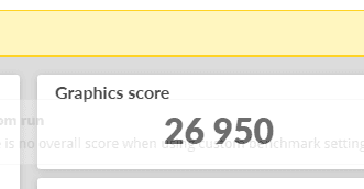

Noch besser,
Vram takt, die 26.950 wurden mit +2375 erzielt
+2402 26140
+2408 26750

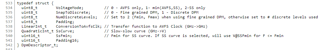

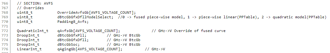

@hellm this interests me
Especially voltage set mode ~ to define how curvature functions
Any input on this ?
It seems/is implemented into Navi21, just no access to it through Wattman ~ likely VoltageMode runs on something else by default
if i understand correctly, SS curve should work quadratically, so the curves i have created in excel should fit on 2-SS.
So currently it is a linear function that is converted to AVFS?
But in which format are the curve values now available?
I do feel, it's just switched "off", on another mode hence Wattman doesn't report it
Same as FT2 wasn't reported , till it got enabled
Any input on this ?
I never implemented the DpmDiscriptors. Used since Radeon VII, back then it was 1, not 0, for also using the slow-slow curve. Whatever that means. The linear quadratic functions can be overridden, that is the second picture, AVFS Overrides. You can edit all of this in the Curve tab.
For the descriptors, you can't really say what is what. We experimented a little with this to force discrete DPM levels on Navi10, but with no luck. I believe it didn't work with the driver, later i forgot about it. If someone wants to try on Navi21, i could do some modification to a mpt file. Or tell how to do that.

What remains fully open for me, is the clock gating topic. Driver wise it is not enabled, but you can enforce it.
And what bothers me, is the big distance between effective and p-state clock. That's been a ryzen topic all over , and was often titled as clock stretching. Soo logically first point is the curve and methodology of curve control ~ that could need modification
Another is
porting down FT3 (injecting), checking 2146+ strap on normal timings (as people reported erased timings on it for 6800XT bioses) and general timings access and modification
This part was very fun & enjoyable on Navi 10, and i feel we kind of miss this still
I'll upload you an usable MTP in 2-3 days
Should the curve part be untouched or doesn't it matter for the "mode-selection flag" ?
Wouldn't you want to implement a toggle in a beta version, soo more eyes can take a look at it ~ before it's getting wiped/confirmed for the next public release ?
